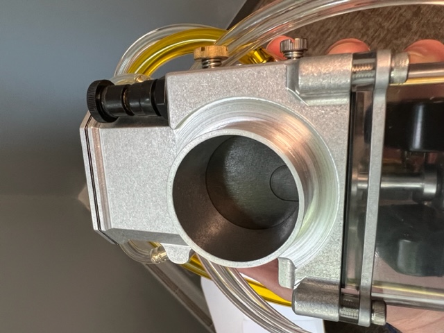

If anyone is interested they do a little machining on the billetron for the KDX.

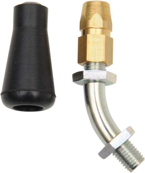

Not sure I mentioned it on this post before, but I discovered that you need a 90° or 45° elbow cable guide for the top of the carb most likely. They shipped mine out with no cable adjuster or cable guide (they sell what they call a slip cable adapter @ $13-15 which is just a threaded adjuster for cables like the KDX/KX that don't already have one), but it appears we will need one of the short radius metal elbows with threads on the carb side and an adjuster on the top side to receive the cable housing termination fitting. This might necessitate a KX125/KX250 cable from a PWK36/PWK38 carb application if the stock KDX cable doesn't have enough cable length to add the adjuster, & absolutely will require the longer KX125/250/500 2-stroke cables if you want a quick turn aftermarket or KX throttle (recommended!).
I have 2 different 90° cable guides that just arrived tonight. The 45° & 40° versions are a lot more common in the USA though, & they may work better due to being more likely to fit the stock cable length. The Sudco 45° cable adjuster guide elbow may be best, but I also see a lot more of the 40° versions. I'd think 40° would be cutting it close to the tank, but perhaps not.
I'll report back soon.
I'll also be reporting back to Matt @ Lectron to make sure he knows of this.

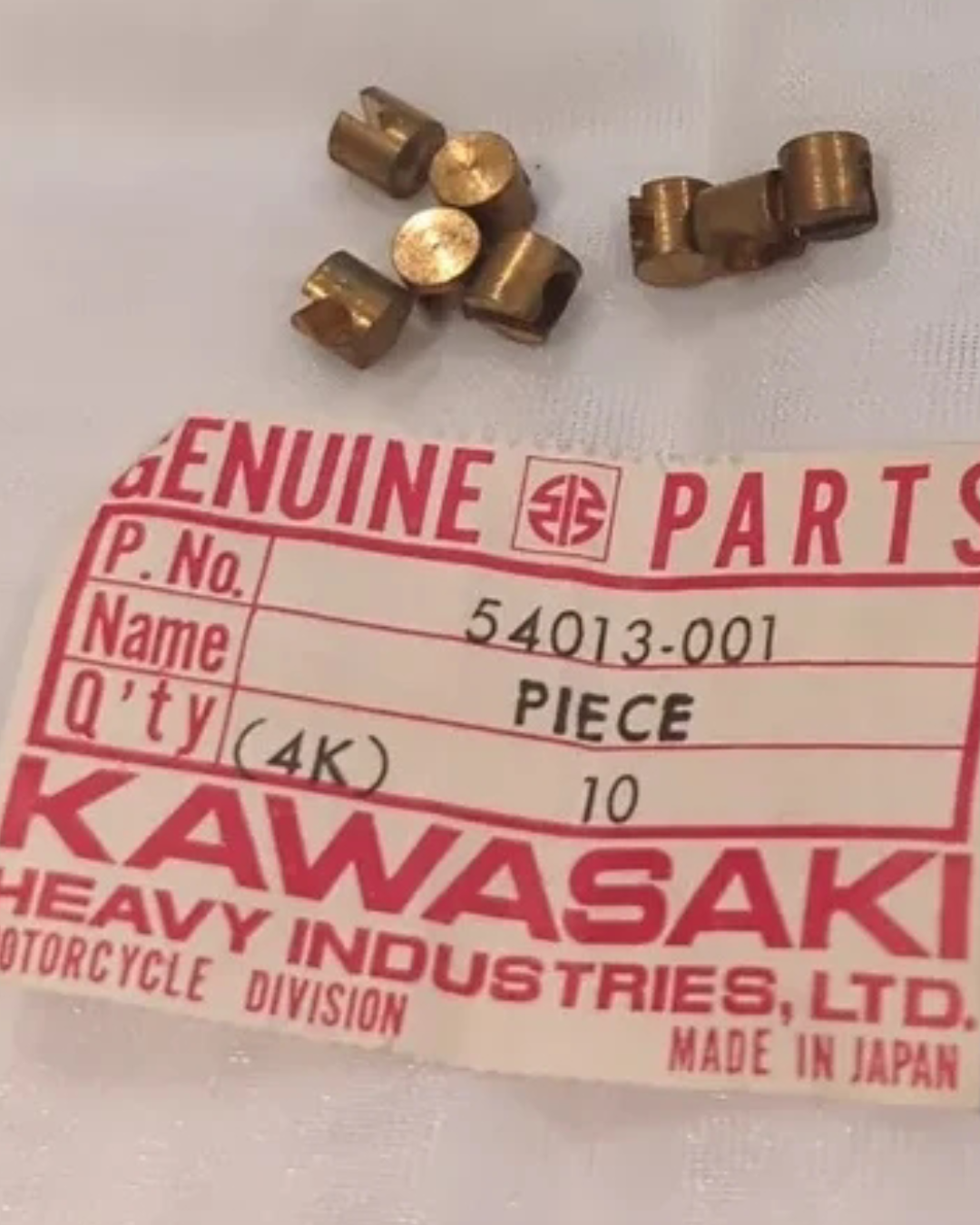

EDIT - to run Kawasaki KX/KDX cables, it appears that an adapter of this sort is necessary for proper cable fitment:
EDIT of my edit - those adapters are a 6mm diameter end (0.236" o.d.), but the Lectron slide seems to need a very slightly smaller end around .228" or .230" according to my machinist's drill bit set as inside bore gauges...
The specific Lectron cables by Barnett are intended for the older Lectrons, and the Billetron advertise that they use the stock OEM cables in most applications. From what I'm gathering I believe you're supposed to use your stock slender Keihin PWK 's vertical cable end in the larger horizontal cylindrical hole as the slide is a universal fit for both styles of cable?
I also had found YZ owners questioning this same thing.
Here's a YZ125 owner's picture from ThumperTalk: On a KDX, shortest length 40° or 45° or up to 90° cable adjuster elbow is definitely almost mandatory as the tank sits so close to the carbs. That's how other members had designed cables for the older electron carbs in the earlier posts on this topic, custom cable with a 70° or 90° elbow.
Also the 45° Mikuni/Keihin cable adjuster from Niche Supply on eBay was not made well at all, and the Keihin PWK cable end doesn't quite slide through them due to burrs from the manufacturing process (tubing seam on the inside). Bummer. The 90° short elbow will be it...

https://www.ebay.com/itm/394000427103
I just ordered an actual Sudco-supplied 40° cable adjuster/guide elbow from Parts Giant on eBay, a reputable business, so that I'm less likely to get cheap Chinese forgeries/clones of the good parts. Sudco part # 007-730. The Niche Supply elbow from eBay which looks almost identical but not quite, ended up being poor quality and not actually fitting a Keihin carb's cable end through the elbow due to casting burrs or more correctly, internal tubing seam irregularities (common on economy-made metal tubing).
If I can clear the underside of the fuel tank on this Sudco elbow, I'll call that the best one for the job, as a 40° bend is going to give less friction than a 45, 70, or 90° bend, and less wear on the metal elbow vs stainless cable. I'll be sure to grease the inside up quite well with molybdenum chassis grease (the black chassis grease for automotive steering and suspension parts as well as the best lube for all suspension linkage and swingarm bearings for our bikes, moly is far better for these applications and for splines than standard bearing greases).
I believe this should do it, using either a KDX stock cable for stock KDX throttle, or a 1990's KX125-500 throttle cable if using a KX throttle or aftermarket quick turn throttle. My KDX throttle is broken where the cable screws in, and the 220 that I ride full time has a Motion Pro quick turn throttle, but I'll try and compare to make sure the length will work out with an OEM KDX cable and KDX throttle grip. Worst case you abandon your original used cable and throttle and upgrade to a used $25 KX125/250/500 2-stroke throttle (or new aftermarket for $35-$40) and matching new cable for $9-$25.
I found it odd that the Lectron slide had the larger horizontal cable barrel end configuration, but that it didn't match the 6mm (0.236") slip-on brass adapters I have as the hole in the slide was a bit undersized at 0.228" or 0.230". I will probably shave .003" off the brass adapters I have and use them (.006 total diameter reduction via emory cloth hand sanding) just because I'm pretty particular about details, but the cable fits and functions totally fine without that using the stock Keihin cable ends. I found it quite odd that it didn't have a receptacle for the standard Keihin type cables, and I looked up the 2005-2008 KX125/250 2-stroke cables from the Mikuni carb years, and they appeared to have the same carb slide end fitting as the Keihins as well... odd.
