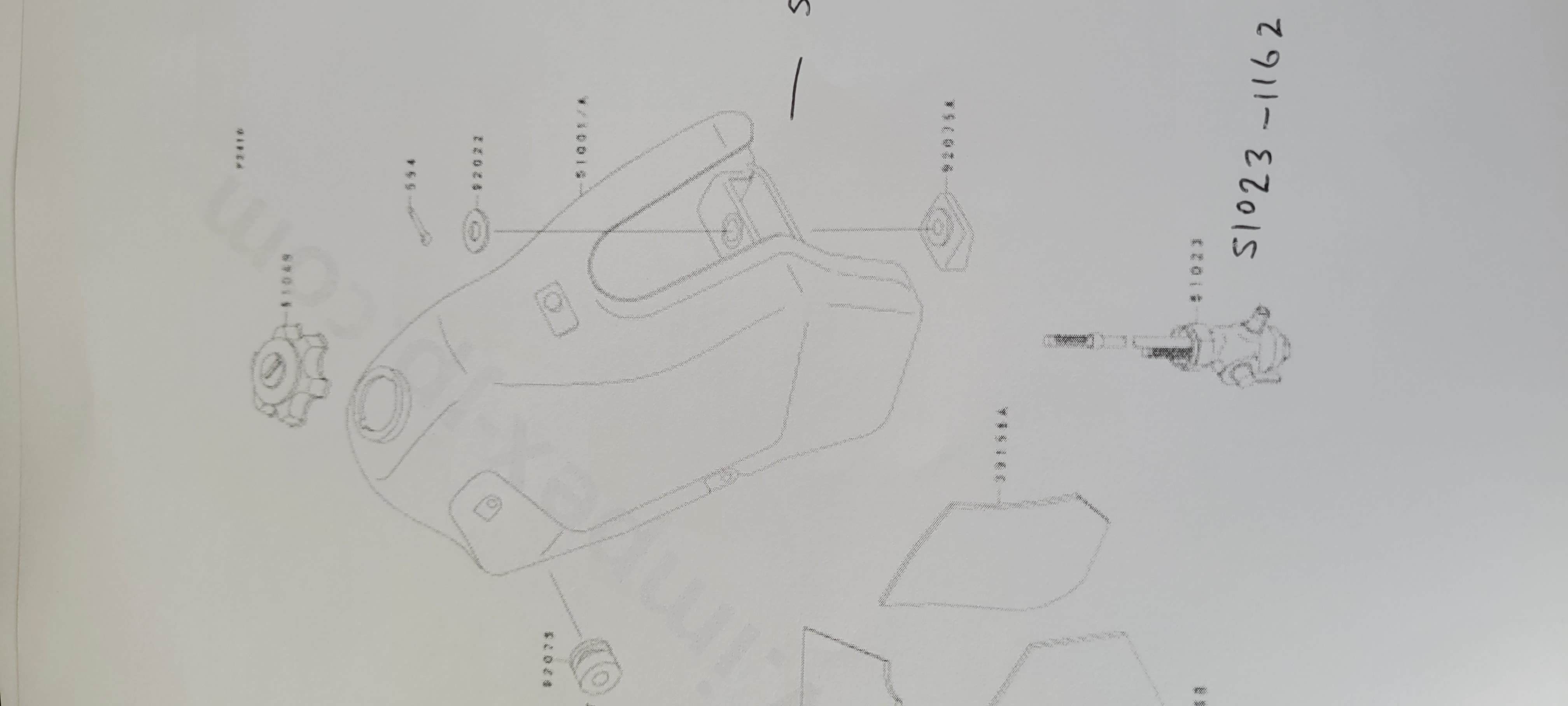

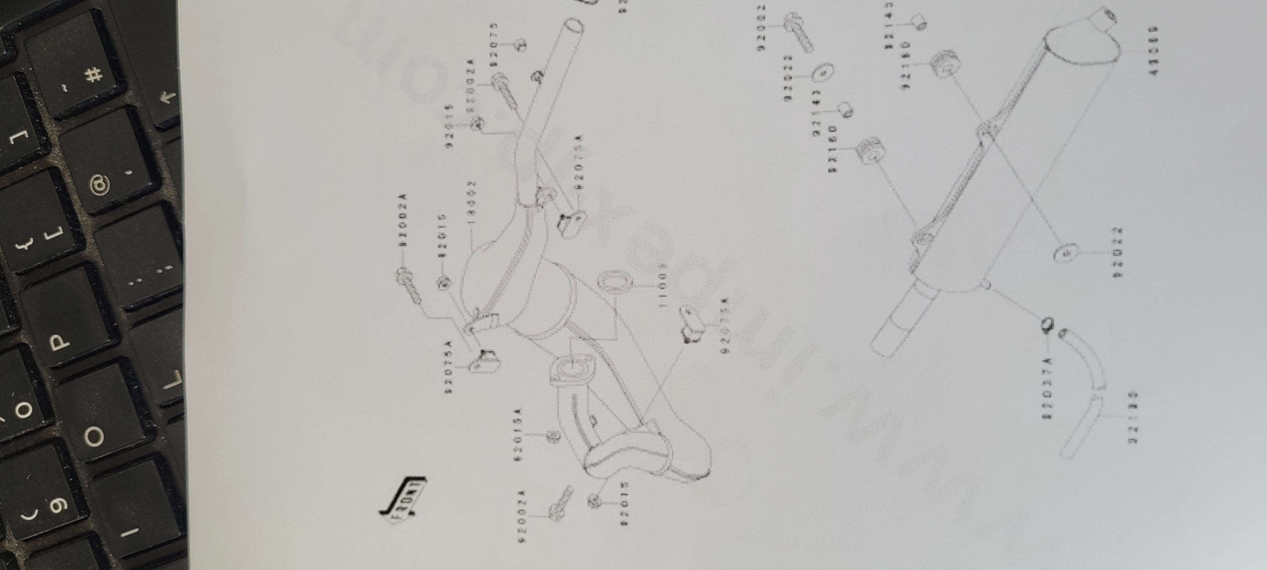

Hello new on here, I'm in the uk and just purchased a 1989 kdx 200 sr, well I think I have.
The tank is still with a unusual fuel tap, and the exhaust bolts onto the engine unlike what I have seen on the usual sr models. I have a couple of pics from imex Japan of the correct parts but they are only listed as the Japan variant g1 bike? Can anyone help pls, as the 2 parts mentioned, exhaust and petrol fuel tap I need to replace but all I can find are the incorrect ones.
See.pics of correct ones as listed on impex Japan but on the g1 variant.
What kdx do I have?

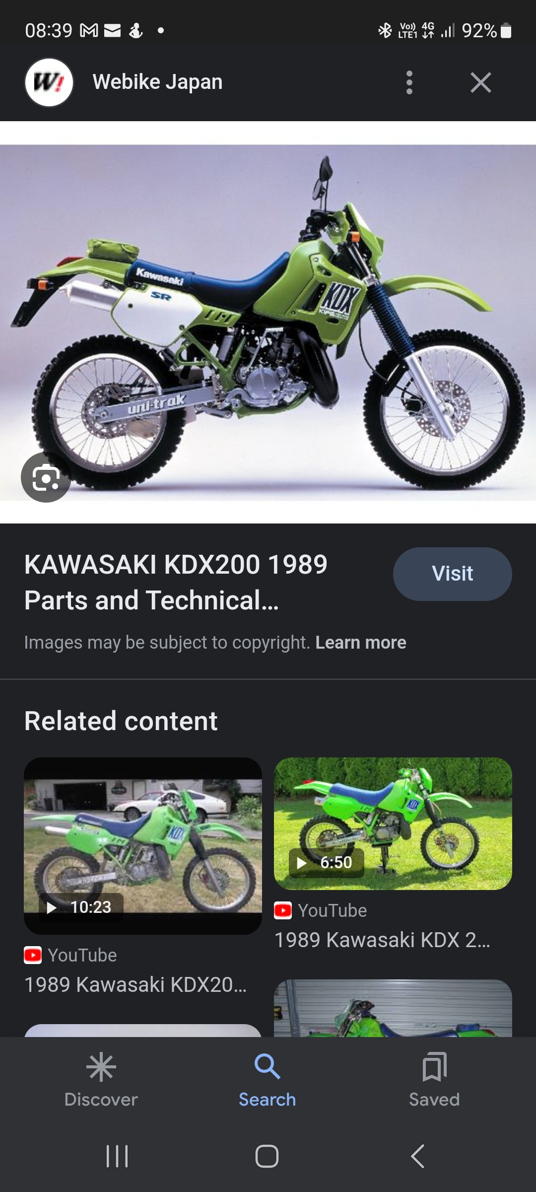

Re: What kdx do I have?
I don't have pics just yet as it's in bits, but look the same as pic attached, with the sr panels and gators over the front folks. I will get engine number soon as I can, thanks for your help.

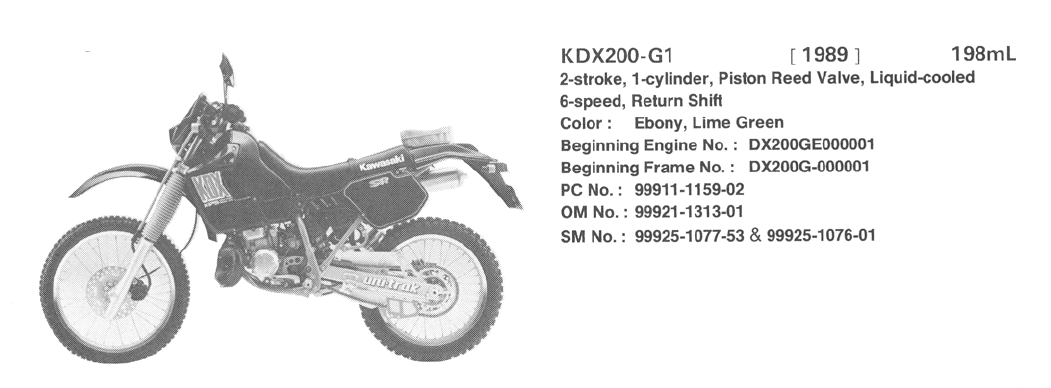

Hi. Thanks for the additional information.
That is called a "Frame Number". In the UK and a few other places, the KDX's have a frame number, not a VIN.
That frame is a 1989 KDX200-G1. Here is a screen shot of the dealer information.
We never had the SR version in the USA, so we don't know a lot about them. Look through some old threads here, as some members with those models have posted information.
I do remember someone mentioning buying an FMF pipe (which uses springs), then cutting the fronts off the FMF pipe and the stock pipe, then welding that stock front flange onto the FMF pipe so it would bolt on like the stock pipe does with the SR cylinder having the two studs method.
If it were mine, I would just try to get it going in sound order, then worry about switching pipes or tanks.
