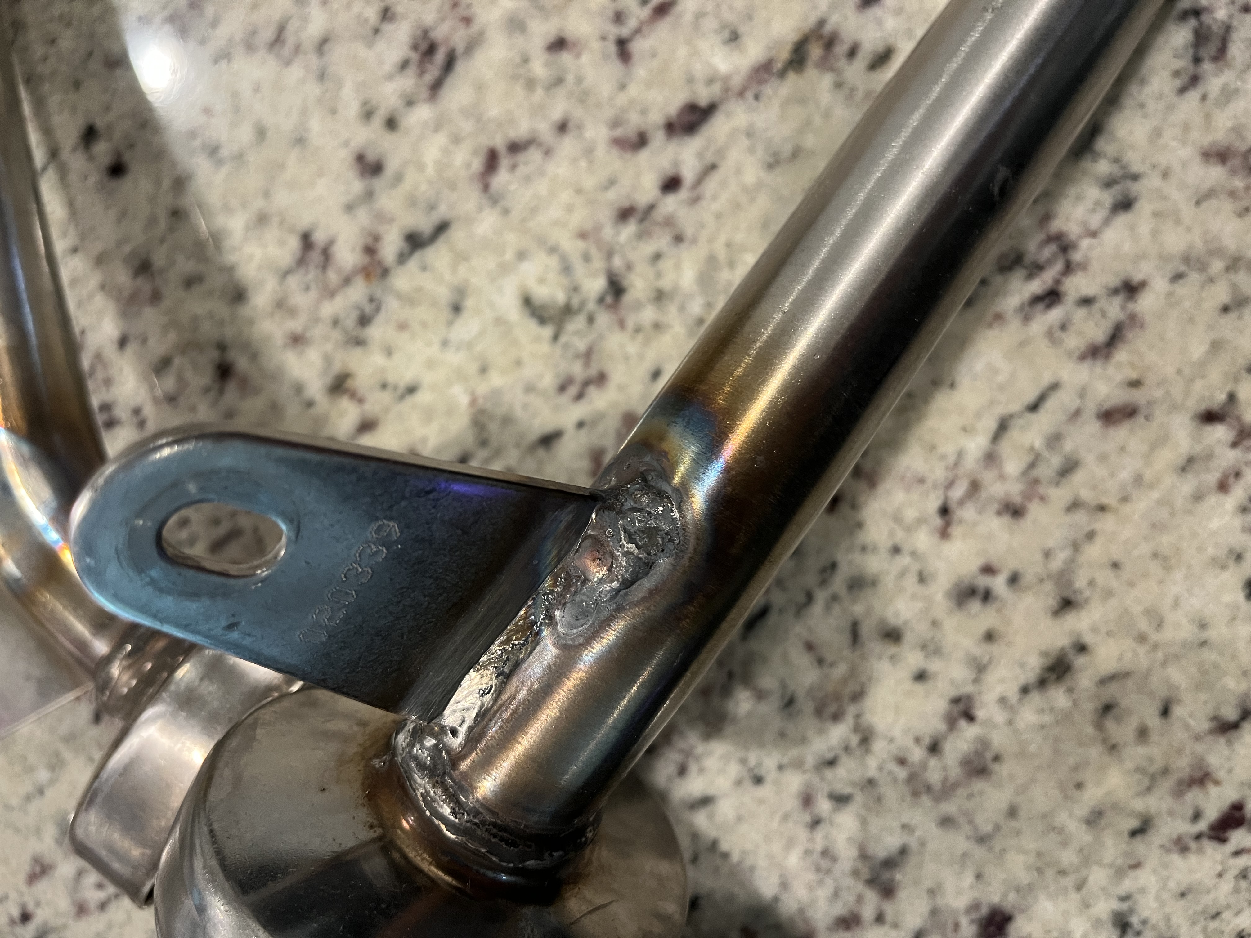

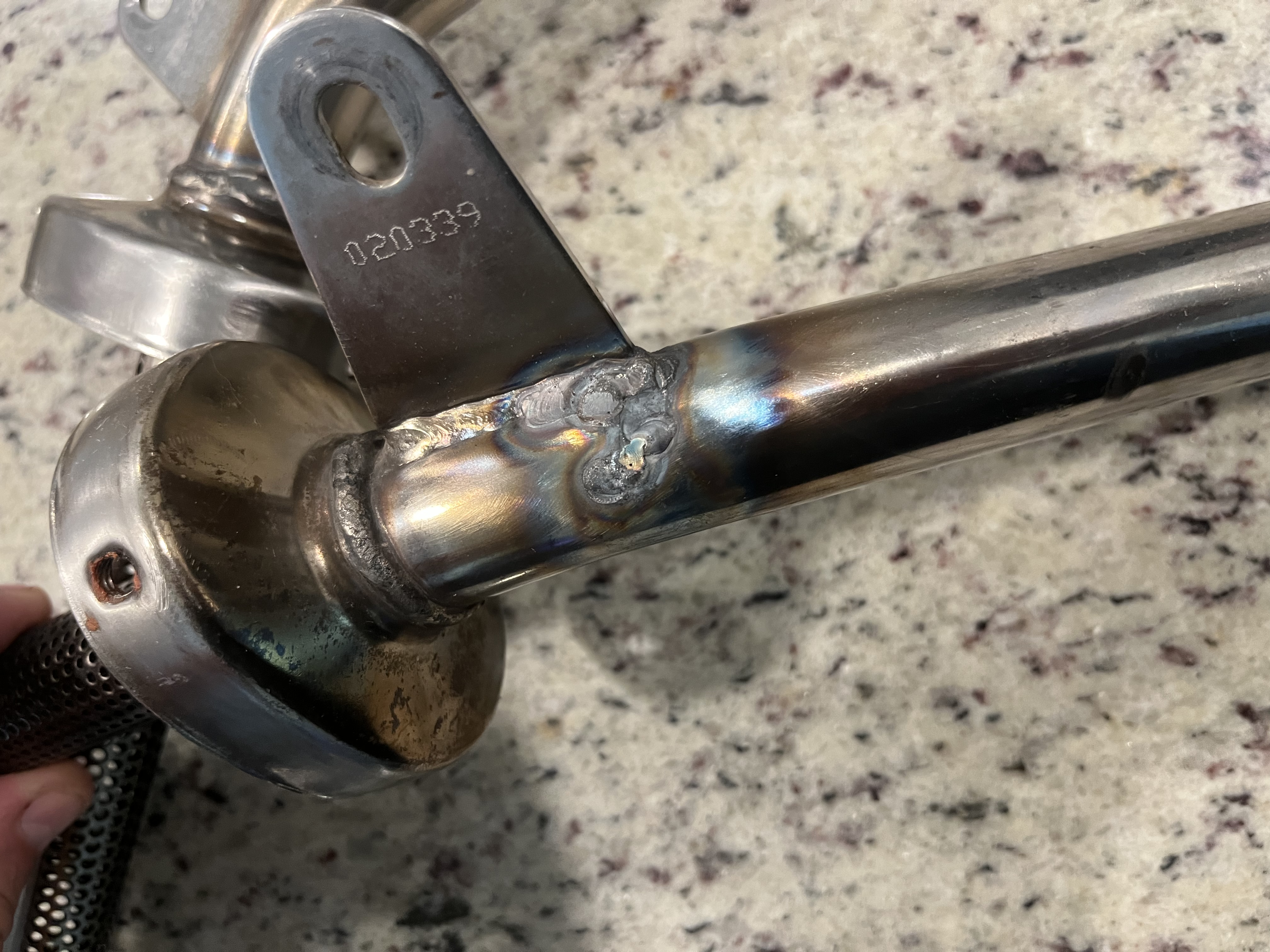

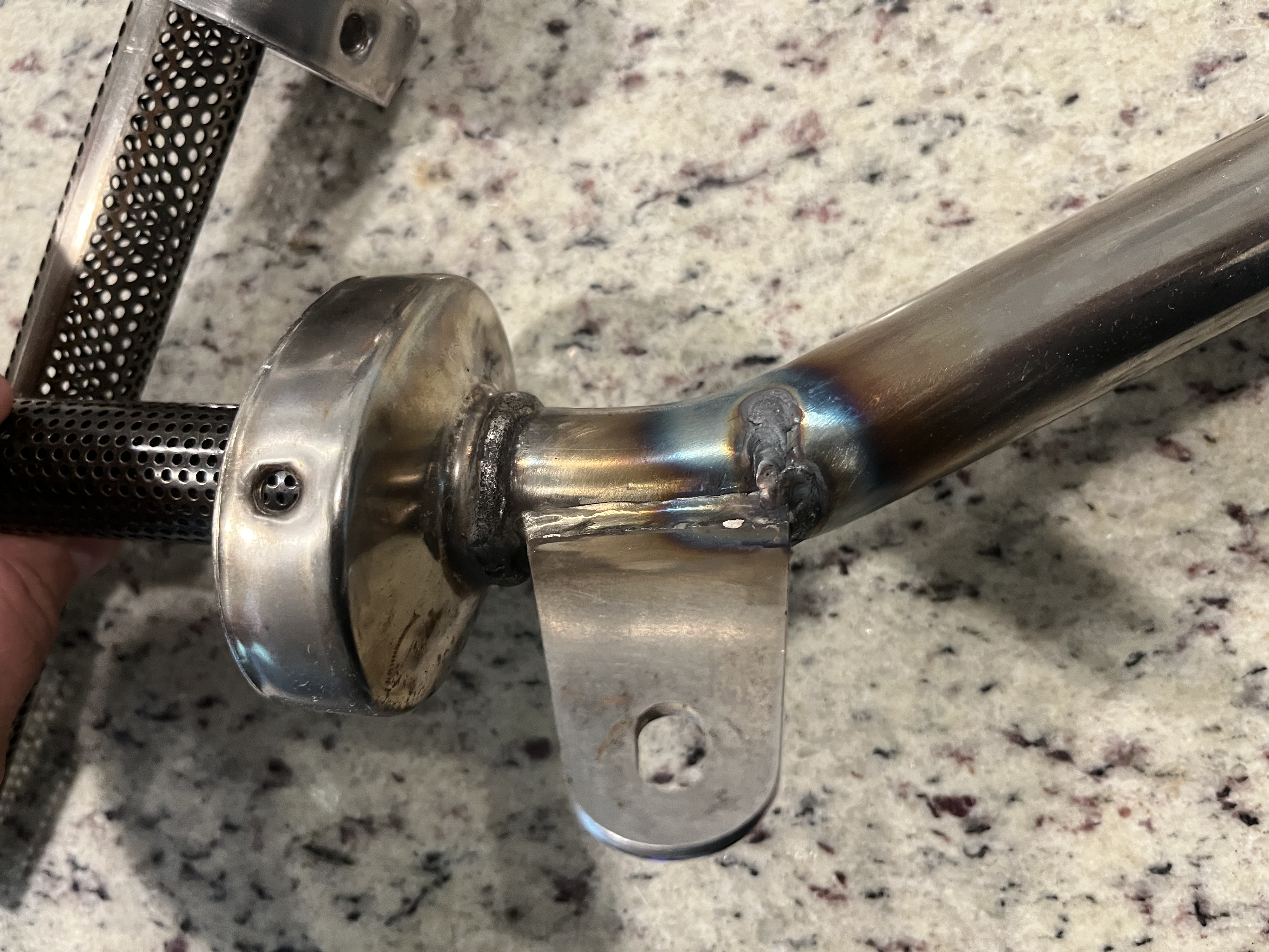

Here are some pictures of the pipes when I got them back from Molly’s 70.
Before sending them off for repair and to burn out anything that was in there I hit them with a torch until they were red hot. That’s why they’re both blued like that.
The one in the first picture had a leak around the weld and the other one had that plus cracks running down from the weld on both sides of the metal bracket.

Not my prettiest work, but this was maintenance welding. The material was thin & chrome plated. I tried to make sure there were not any craters from the tungsten when I terminated the weld.
