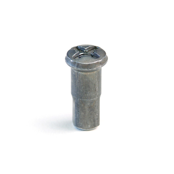

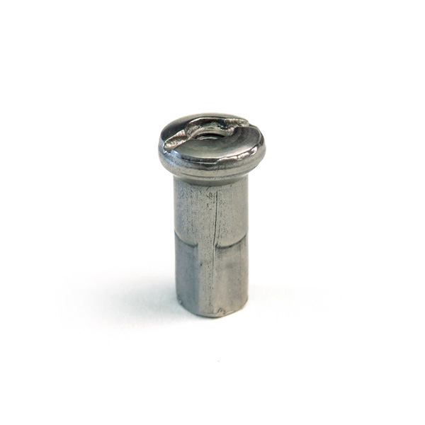

Buchanan's stainless (1st) and aluminum (2nd) nipples:

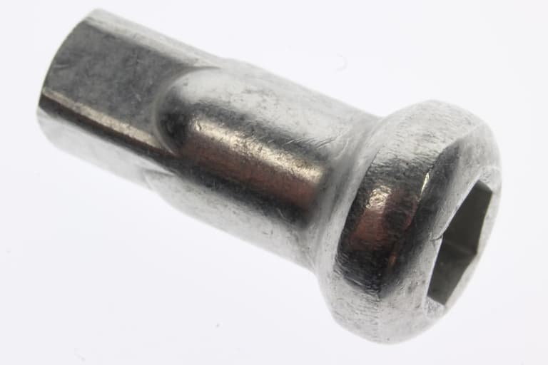

Here's the OEM Kawasaki alloy nipples in question, especially in-person, they look to be quite the fat boys up top in the drop center of the rim area:
I think the Buchanan's nipples, both the stainless and their alloy nipples, will be lower profile heads vs the OEm KX125/250 alloy nipples, to allow a little more slack in the front tubliss/tire install... The fronts are a nightmare to install, but a dream to ride in rocky technical terrain.
I'm just wondering if anyone has tried this before, and if the 9G Buchanan's nipples were an exact fit for the threads on the OEM Kawasaki spokes. They are both rolled threads, I've determined that. It's $130 for the full stainless front set or stainless/aluminum front wheel spoke/nipple set from Buchanan's, or $69 for just the nipples.
