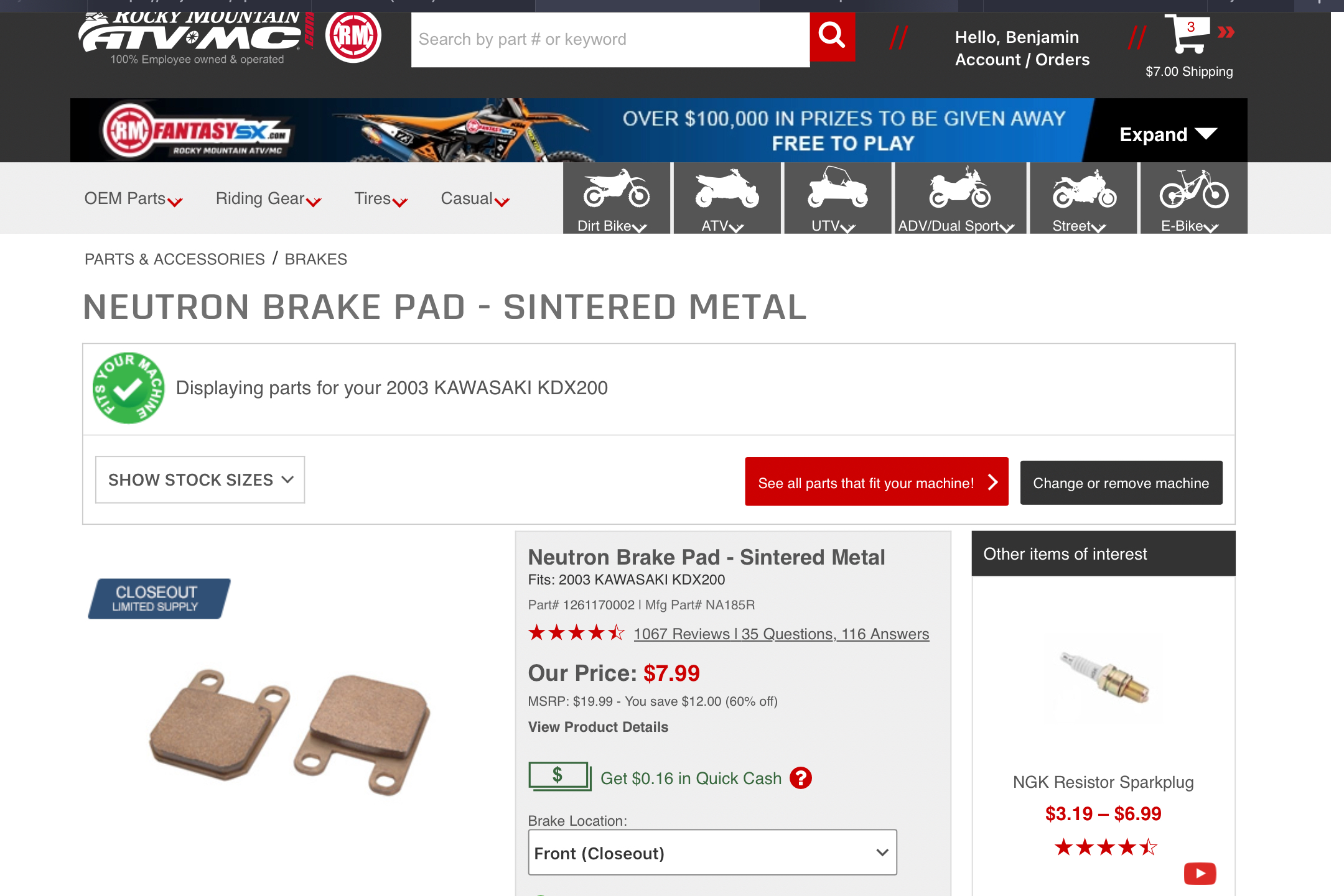

I’ve been running these stupid cheap $8 pads from RMCATV.com for a couple years … they have both front and rear and seem to work fine. They don’t look like the picture.

- 00EF9ECF-A2E6-4833-B6C5-B6F29EA1F660.jpeg (1.16 MiB) Viewed 1576 times

Yep, great affordable pads. Been running them for a few years now and my buddy has even longer.MoonStomper wrote: 08:44 am Feb 22 2023 Definitely call Jeff, he probably has 50% or less of his stuff on his website. Last time I was up there I think he didn’t have the solid rotor in stock but was expecting some.
https://www.rockymountainatvmc.com/par ... p?s=197013

I like those pads also. Considering you don't have to remove the front or rear wheel to change brake pads, these would be much easier and cheaper vs the solid rotor.
