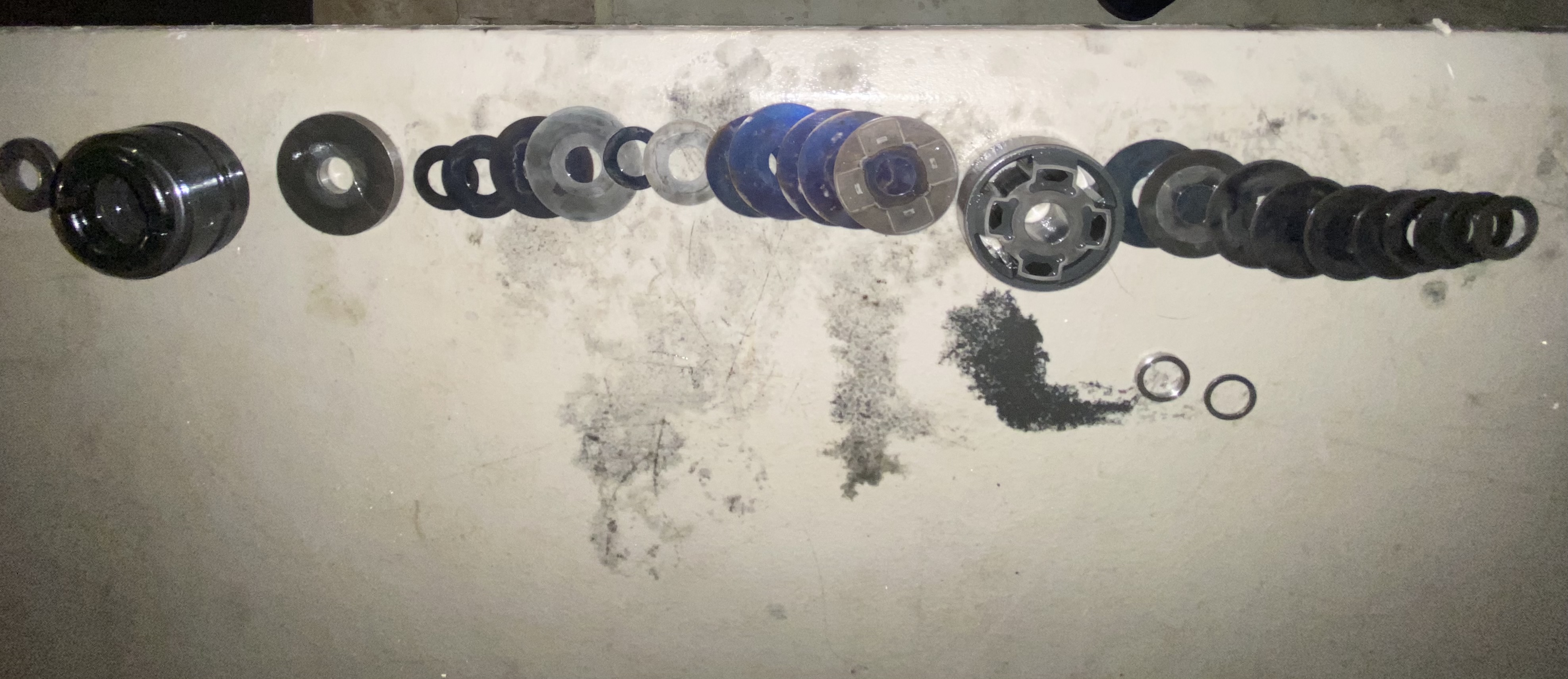

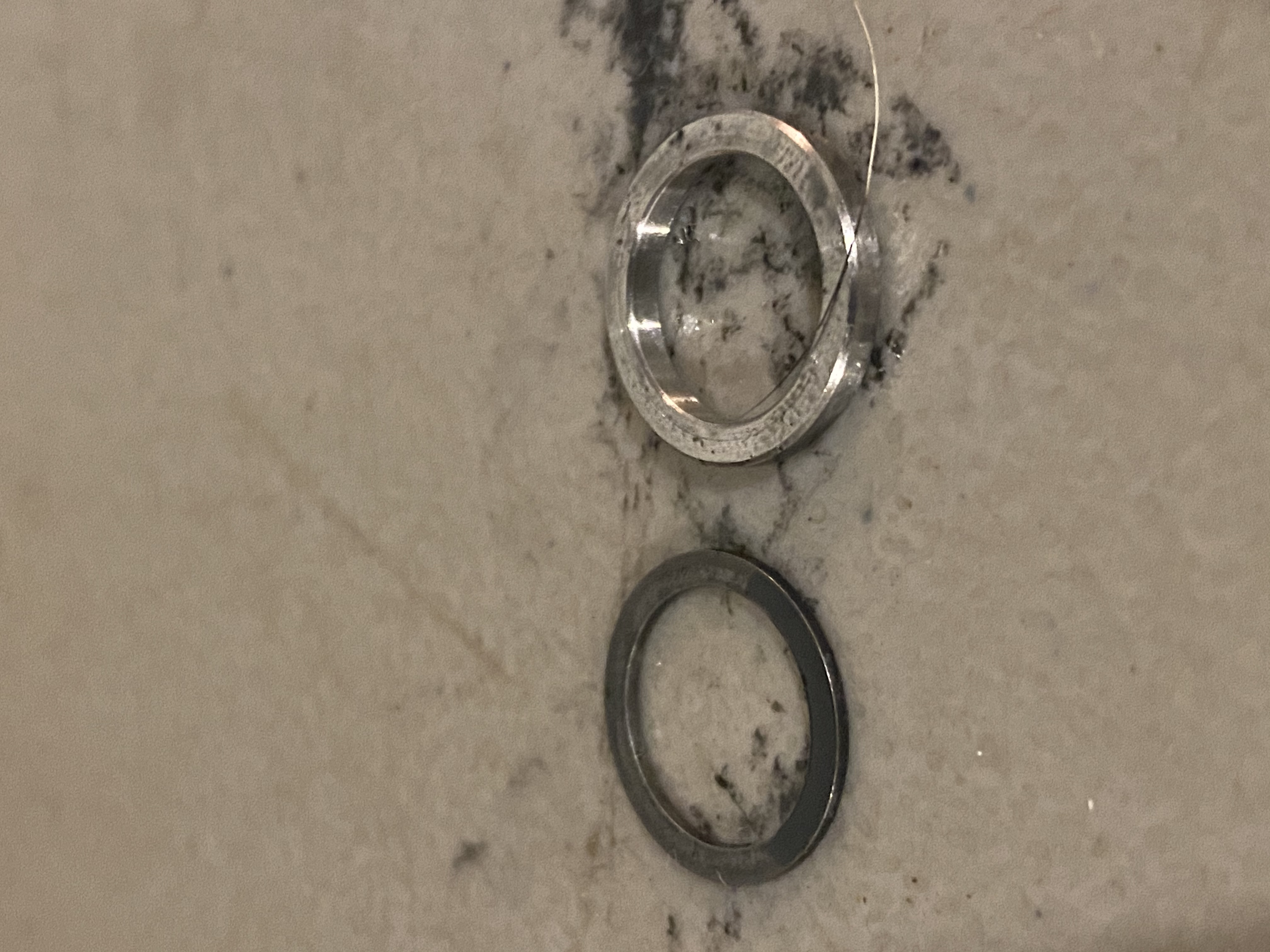

I took apart the rear shock and as I was ziptying the piston, shims and valves together carefully I heard these two little shims drop. Can’t seem to find where they go but I attached a picture of the exact order I found everything in including the 2 mystery washers. Side note. The rear suspension was done by factory connection in the late 90s early 2000s based on the sticker on it. Does anyone know the stock shim sizing and ordering on the e series? I’m thinking about just ordering the stock shims whatever they may be.

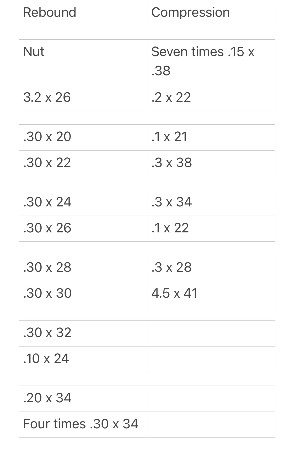

Here’s my measurements. (I am so new to this) I did some research on what I’m looking at and I came up with measurements for the rebound and compression. Obviously I still don’t know where those washers go. Does this look ok

Are the washers there to space the nut up?

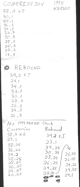

Here's a picture of the stock valving. I would not spend the ton of money it would take to convert it to stock. I would replace that worn face shim though (the one with the wear marks from the piston).
I can't find what the stock valving is.

Those are just spacing shims since the factory connection stack is shorter than stock. They go just on top of the baseplate.

The outer diameter is to the left of the decimal.
The thickness in millimeters is to the right of the decimal.
Quantity above 1 is (x 2, x 6, etc,)
These were recorded in 2005. Writing it down is important. Remembering where you put it is too.

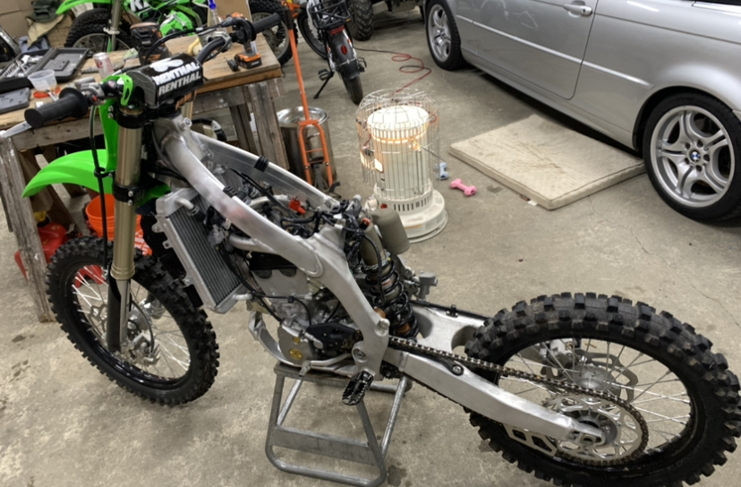

Can I tag in on related question? Not sure if this needs new post but maybe will help later when you put it back together.
To adjust shock spring tension (sag) do you need to spin the spring while tightening down the preload nut?
On KDX I adjusted new spring by banging the nut around with punch (like most YouTube’s show) and not disassembling the bike at all. the spring did not rotate with the nut, during this method. It did not feel like it liked that. And I probably have grrrd some threads, getting it to 100.
On new KX, I was scared to knick it up so more careful & followed the manual (pulled 1/2 the bike apart) to cleanly access the spring. Had planned on using my head wrench to do a nice smooth crank. But didn’t have to. I just turned the spring by hand (like I saw in only one YouTube) 3 full revs and nut followed right along. Easy peasy.
Maybe I should have done same on KDX?

Ty. Yes it adjusted fine to correct race sag no problem, just felt a bit grindy getting there during the final adjustments, using the punch.
Re: 91 KDX 200 Rebuild / mystery washers/shims NEED HELP
You may have dirt in the threads. If taken apart and fully cleaned, then a touch of lube, it will spin by hand as you tighten the nut.
