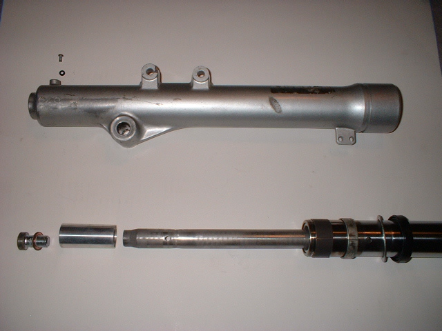

Normally, they are disassembled. You can put some small wood screws in the old seal and use wire to pull it up and out, then install the new one. There are other home made techniques to doing it.
What you are not aware of is that the inner and outer fork tube bushings need to be inspected and probably replaced. This requires disassembly.
Here's a pic from a set of 1987 KDX200 forks that are similar to yours internally. The picture is from years ago when I used to work on them.

Re: KDX200 1992 Front shock seal R&R
Thanks for the suggestion and the heads up re bushings!!
