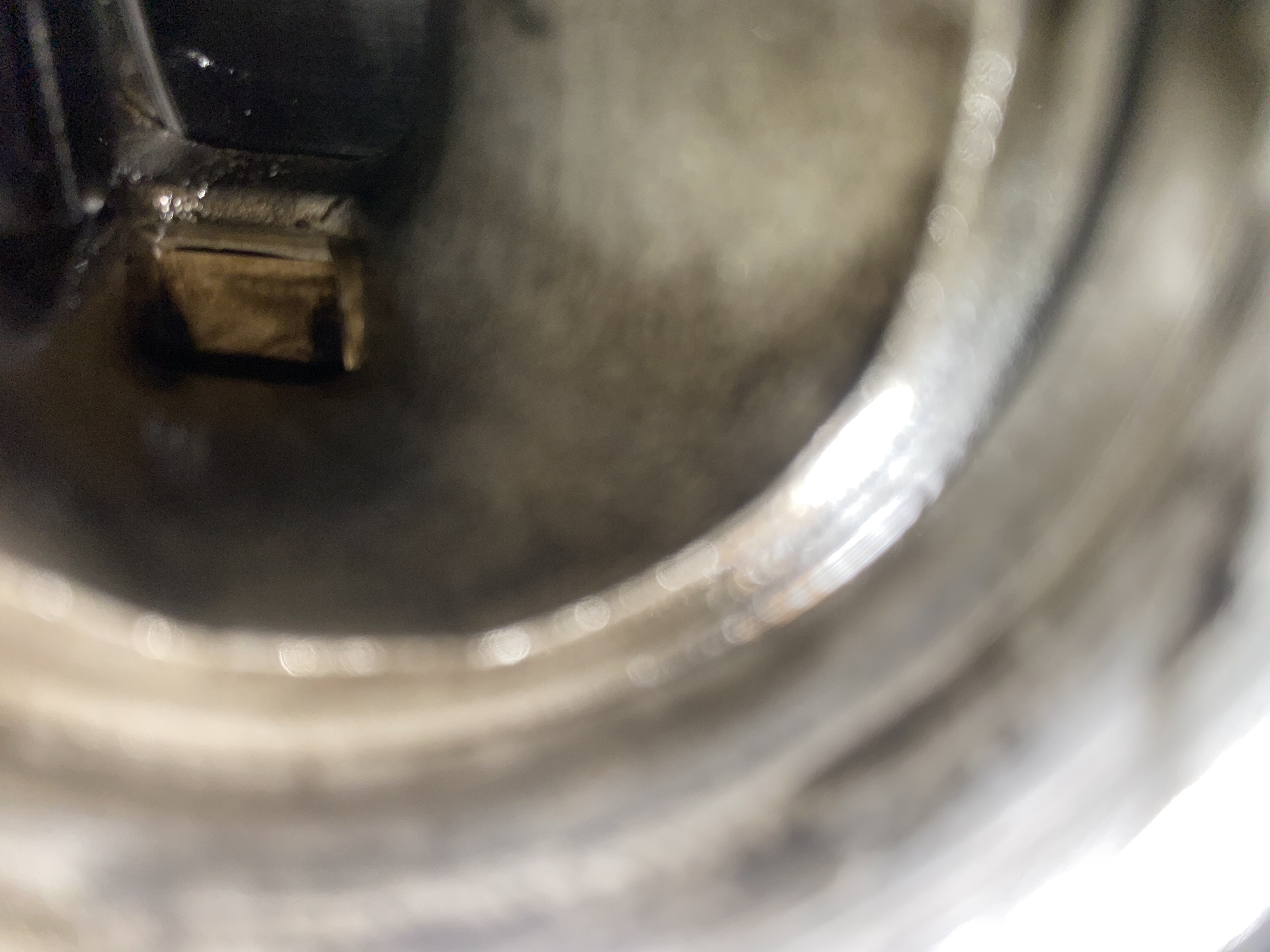

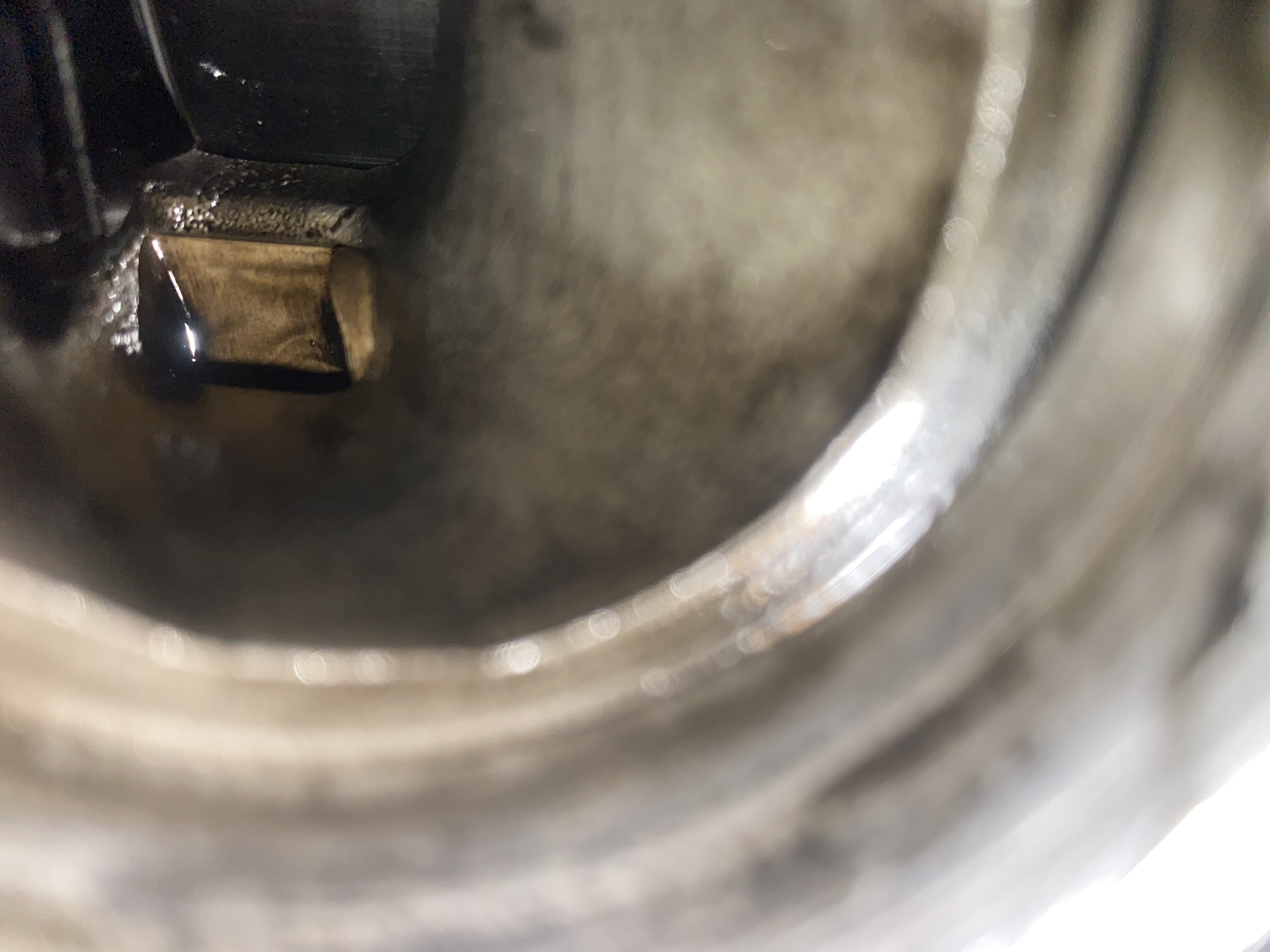

Can anyone here send me a video turning the gear under the slotted cover? I can crack open all of the valves when turning it to the left then I start to feel spring tension. I want to know if others have spring tension as soon as they start to turn the gear. Thanks

Hey no the only spring tension I can feel is when I turn the gear about a tooth’s worth counter clockwise and onward. gear won’t return all the way unless I move it back all the way with a wrench as their is no spring force acting on it. When I went to check the bike after a quick ride the second pic is the position the valves were in. The first picture is where it should be (all the way closed) correct?
Posts: 662
Re: 220r only 90 psi after 4 hours on FRP ported top end. UPDATE: with better gauge 150psi, running rough though
Turning the gear clockwise is opening the valves. They don't spring closed on their own. I have to manually turn the gear to operate the valves.
Your valves look closed.
