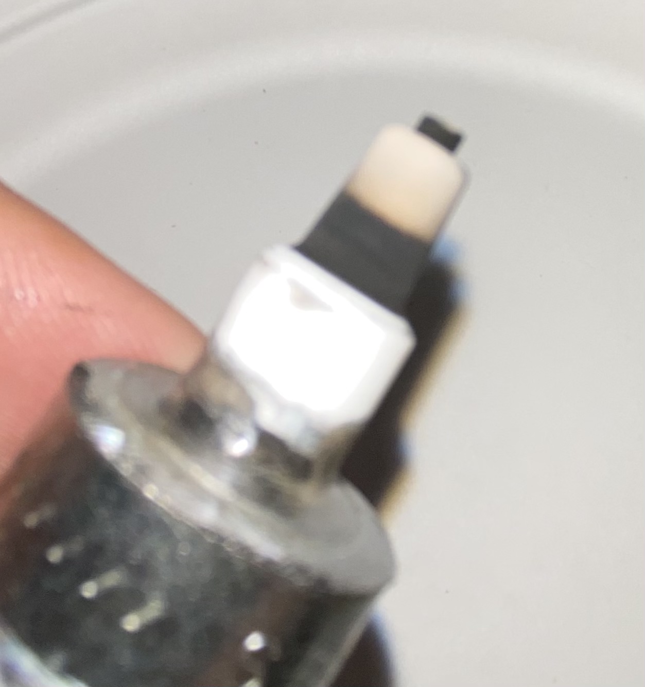

Seeing that I have just about tried everything I double checked the compression and it topped out at about 155 psi. I looked at the spark plug that has about 3 hours on it. Looks/more so seems lean throughout the midrange and maybe a bit too rich on the main. The ground strap has some bright tan colored finish.
- BFFDEBCF-FB96-461B-9DF8-C82182D68751.jpeg (231.1 KiB) Viewed 2412 times

Where did you read that you could read the needle and main jet after a few hours?
What is your expectation of idling?

I do agree with the fact that jetting can’t be read on a plug with multiple hours. But I think that I can still tell if the engine is generally running lean. My main jet is alittle high based on the standard size recommendation from RB. Before all the mods have been done my plugs were always dark brown after a multiple hours. I just need it to idle steadier without hanging up randomly and also dropping very low randomly, it’s actually becoming irritating. I think I should have no problem with idle issues as it performs so well at low rpm to begin with and considering that everything is sealed and in good shape mechanically at this point. ThanksKDXGarage wrote: 09:40 pm Oct 16 2022 Where did you read that you could read the needle and main jet after a few hours?

You need to follow the jetting guide and dial in the pilot circuit first, then your main, and then you go to the needle. Lastly, the strap won't tell you crap except maybe whether you have detonation or not.
