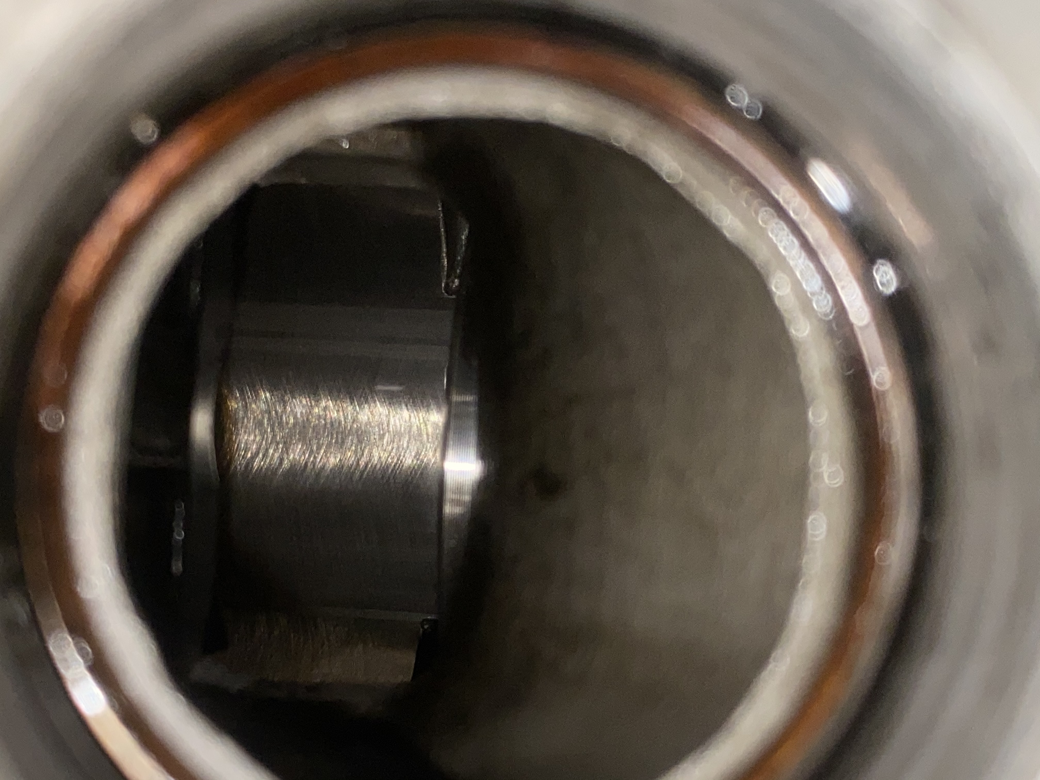

When inspecting the cylinder through the exhaust port I found these marks. Not sure if that is a sign of something bad.

When inspecting the cylinder through the exhaust port I found these vertical marks. Not sure if that is a sign of something bad.

Re: Possible bad stator.?
Did you have it replated?? Are those the scratches you are referring to? (cross hatching)

KDXGarage wrote: 11:24 pm Sep 24 2022 Did you have it replated?? Are those the scratches you are referring to? (cross hatching)
I was referring to the vertical mark toward the right of the visible plating. Not the crosshatching
Slight piston smear? Tiny four corner seizure mark?

KDXGarage wrote: 03:40 pm Sep 25 2022 Slight piston smear? Tiny four corner seizure mark?
Those things crossed my mind. I wanted to mention I did another leakdown (6psi lost 1 psi in 8 minutes) and checked the float height again after reading a post of someone mentioning to get the float close to level with the gasket surface. I went in and although my float height was at 17mm I moved it to about 15 mm took it for a ride and the rpms no longer “hung up”. (The manual mentions 17mm +\- 2mm). I roomed if for a woods ride and it ran a lot smoother and faster. I noticed more control in tight woods corners now that the low rpm throttle response was back and the bike seemed much more playful.

My concerns: As soon as I got to the open field at the end of my ride I banged through the gears a few times and the exhaust note changed (got louder and raspier) and it started to consistently run bad again. I think the problem gets worse the harder I ride because the few times I got on it in the woods it started its raspy tone coming off the pipe. DO I NEED HIGHER OCTANE RACE GAS????? I have never experienced detonation but it’s definitely a metallic as I described raspy note. If it was fully warmed up the idle would drop very low and come back to where I have it set after alittle bit of throttle. The marks in the cylinder! .....Not sure how serious I should take any of these remaining issues but I am an idealist. Should I have the cylinder repaired and start over? I think I’m getting somewhere at least. I know this is so much info, I apologize if the lengthiness is too much. Thanks
