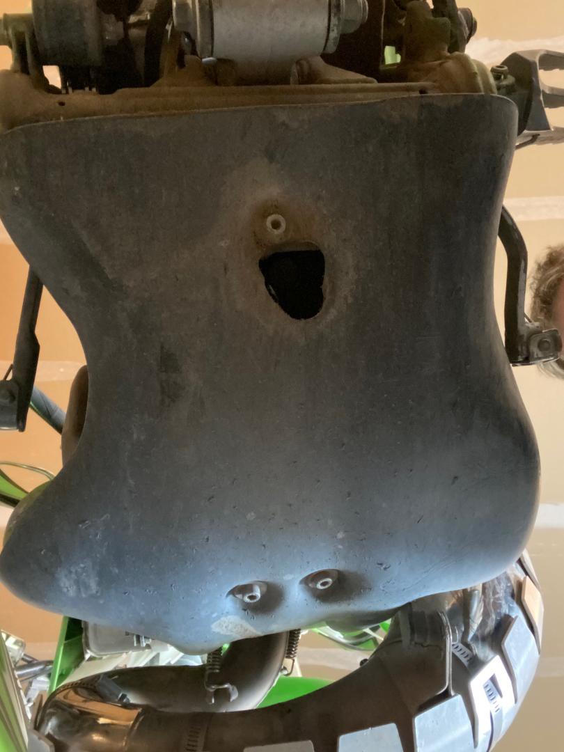

Does anybody have a picture of how they cut the drain bolt hole bigger to work? The mounting bracket is almost touching my drain plug. I’m not sure if cutting would work.

lcgordon711 wrote: 03:01 pm Dec 06 2021 Does anybody have a picture of how they cut the drain bolt hole bigger to work? The mounting bracket is almost touching my drain plug. I’m not sure if cutting would work.
Like I mentioned above, I just used a dremel to open up the hole a little more. Easy mod and it works fine for oil changes.
Hyde Skid Plate Oil Drain Hole.jpg (84.7 KiB) Viewed 6841 times

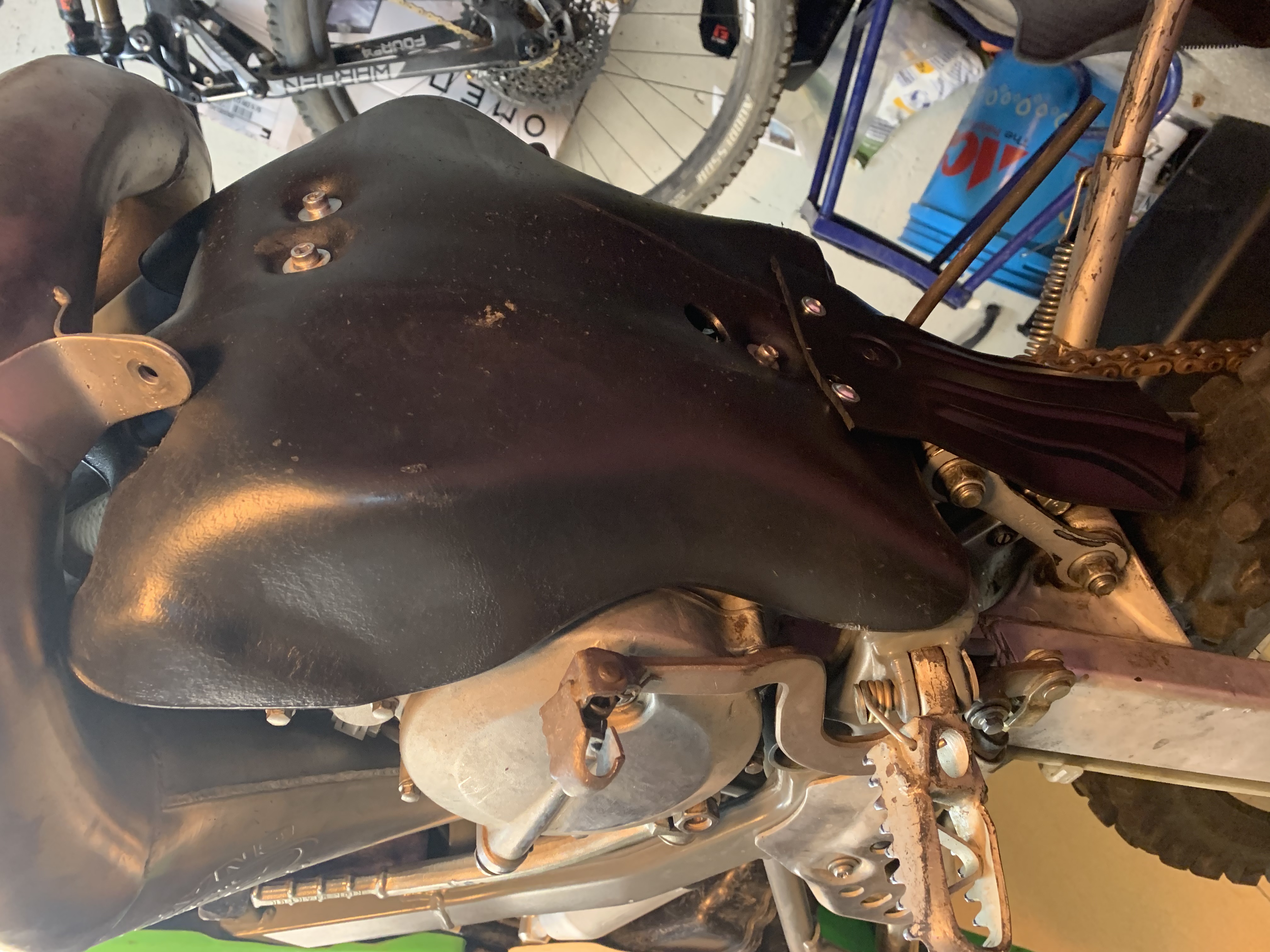

Thanks for the pic. I don’t think mine would work. The mounting bracket seems to be in the way of the actual drain bolt.
Here is a pic of mine and I added a linkage guard. It is the acerbis universal one. It seems to mount up well.

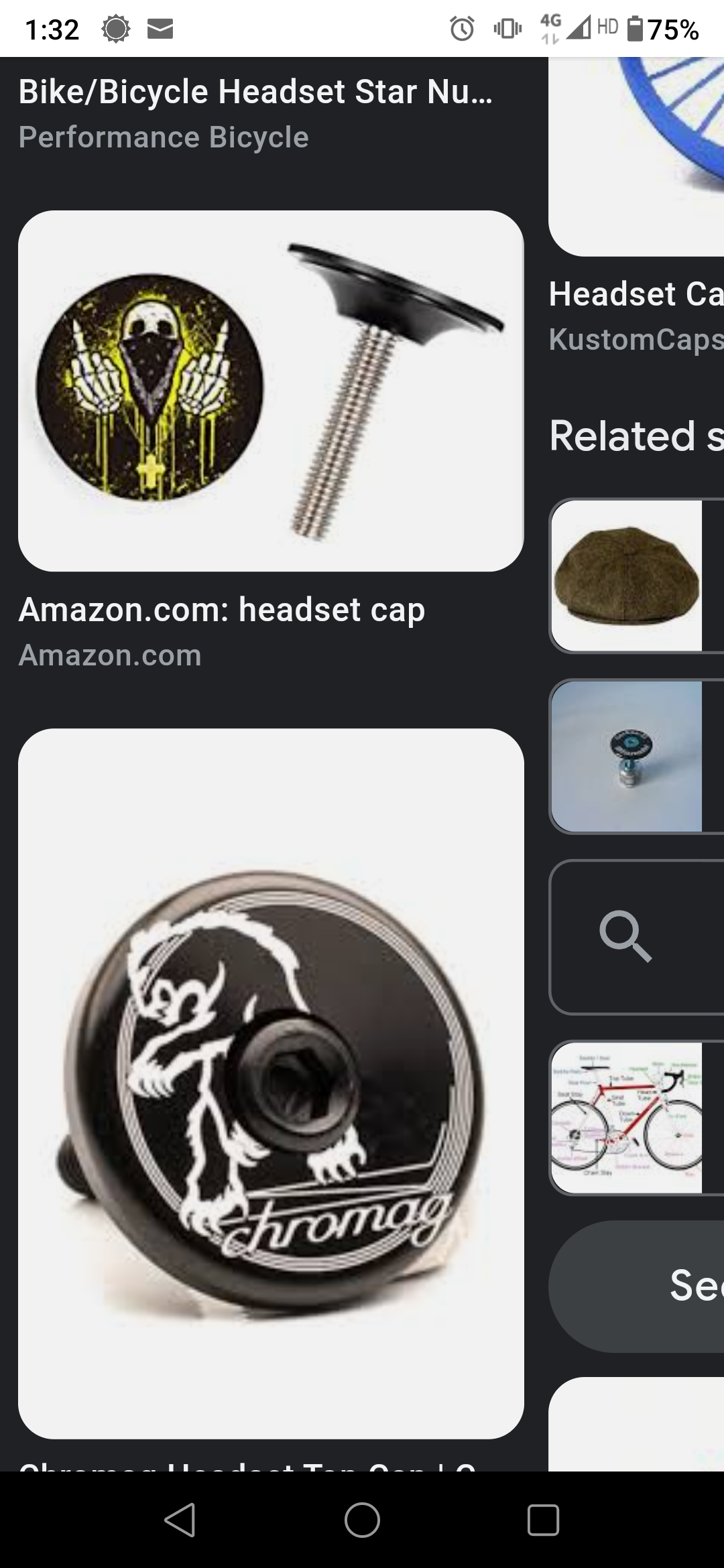

I plan to fix it by using a heat gun and a bicycle 1-1/8" threadless headset's top fork/stem cap aluminum piece & bolt to make use of the incorrect large diameter oil drain hole and push it up to be slightly concave / recessed with the heat gun the way the rear hole is (so thebolt is countersunk appropriately as to not hang up), using the bicycle headset cap piece to clamp in the oversized hole after heating it up and recessing it.
Then drill out the incorrect recessed rear mount hole to be able to fit a socket in to access the oil drain plug.
