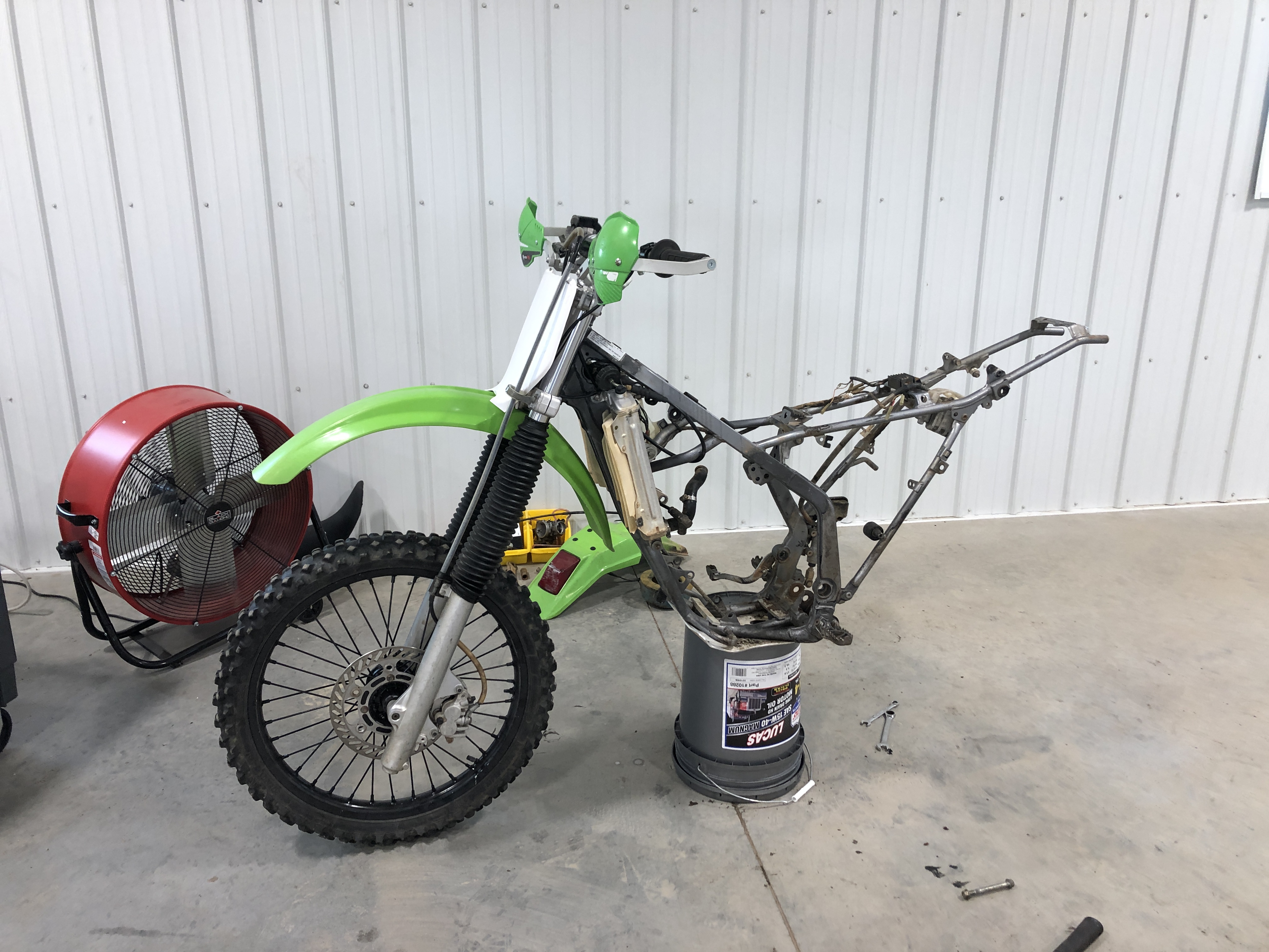

Over the Labor Day weekend I purchased my first KDX.
It’s an 04’ 220r.
This is my first Kawasaki ever, so I’ll extend an apology for any questions that have obvious answers that I am unaware of..
After purchasing the bike I promptly started tearing it down. Although it is a complete bike, most maintenance had been neglected. And that’s ok, I was looking for a project.
And here’s where I have a few questions.

New to me 220r
- 8249ECF8-CCCE-46D7-8F81-C13F770A8AE6.jpeg (1.94 MiB) Viewed 1733 times

Thanks a million guys !
Good to know about Ron, it’s such a bummer though..
I think that’s good advice on the carb, the bike is almost 20 years old and is for sure showing it’s age on everything.
I don’t wanna spend all this time and money and not be happy with it..
And I was wondering if there is a way to match the original paint somehow
Thanks again for your input !
