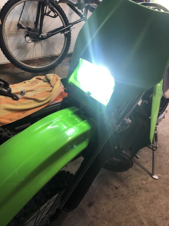

I have tested a few of these I bought off ebay. Although I have not ridden extensively off road with it, the bulb gives off quite a bit more light. I would say easily 20%+ more than the stock weak bulb. The best thing about them is they are cheap. I bought 2 of these for $10. Previously I used the Tusk blue-white replacement bulb for $15 from RMATV, but it was a cleaner light, but not much brighter. I realize many are doing the DC conversion, but I dont really ride much at night so just wanted a better bulb than stock H6M. I think these are a keeper.

Do they really just plug right in with no modification?

Yes sir. Plug n play!

Thanks for the find. Question - will these dim at idle just like the stock halogen? Or would they be more uniform? I currently just have the stock candle light in the front.

Being that the KDX electrical system is AC, I’d expect a plug in LED to flicker quite a bit especially at lower RPMs?

It does flicker a bit at idle.
