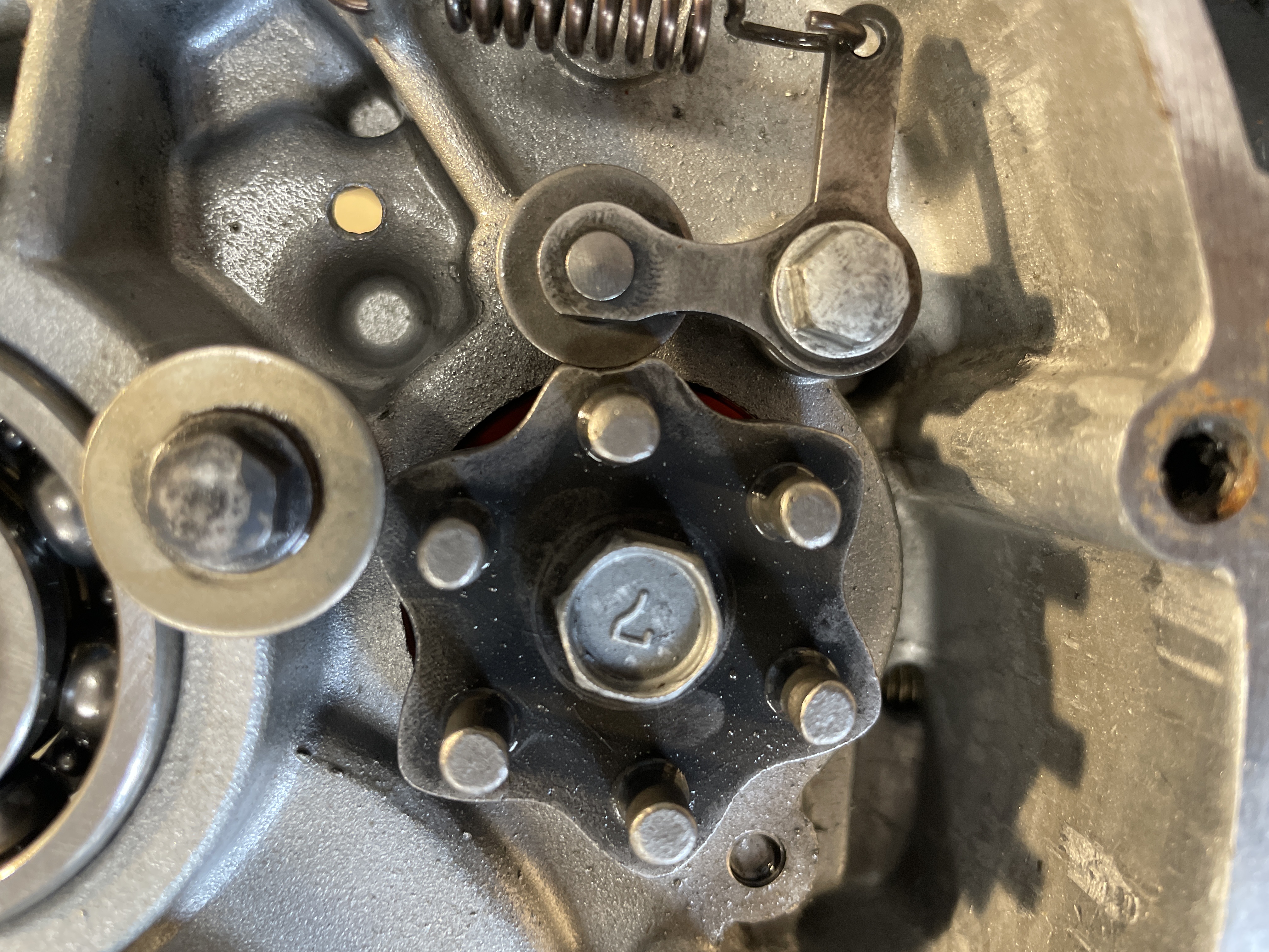

Hi guys ! Been a while. Wound up splitting cases on 98 kdx220. Re installing transmission. Is this neutral on right side ?

Yeti24 wrote: 06:08 pm Aug 07 2022 Hi guys ! Is this neutral on right side ?
Yes. that is neutral.

Good morning guys and thanks a lot. I’ll probably try to drop the gears in tonight. Probably be reaching out to you all again.
