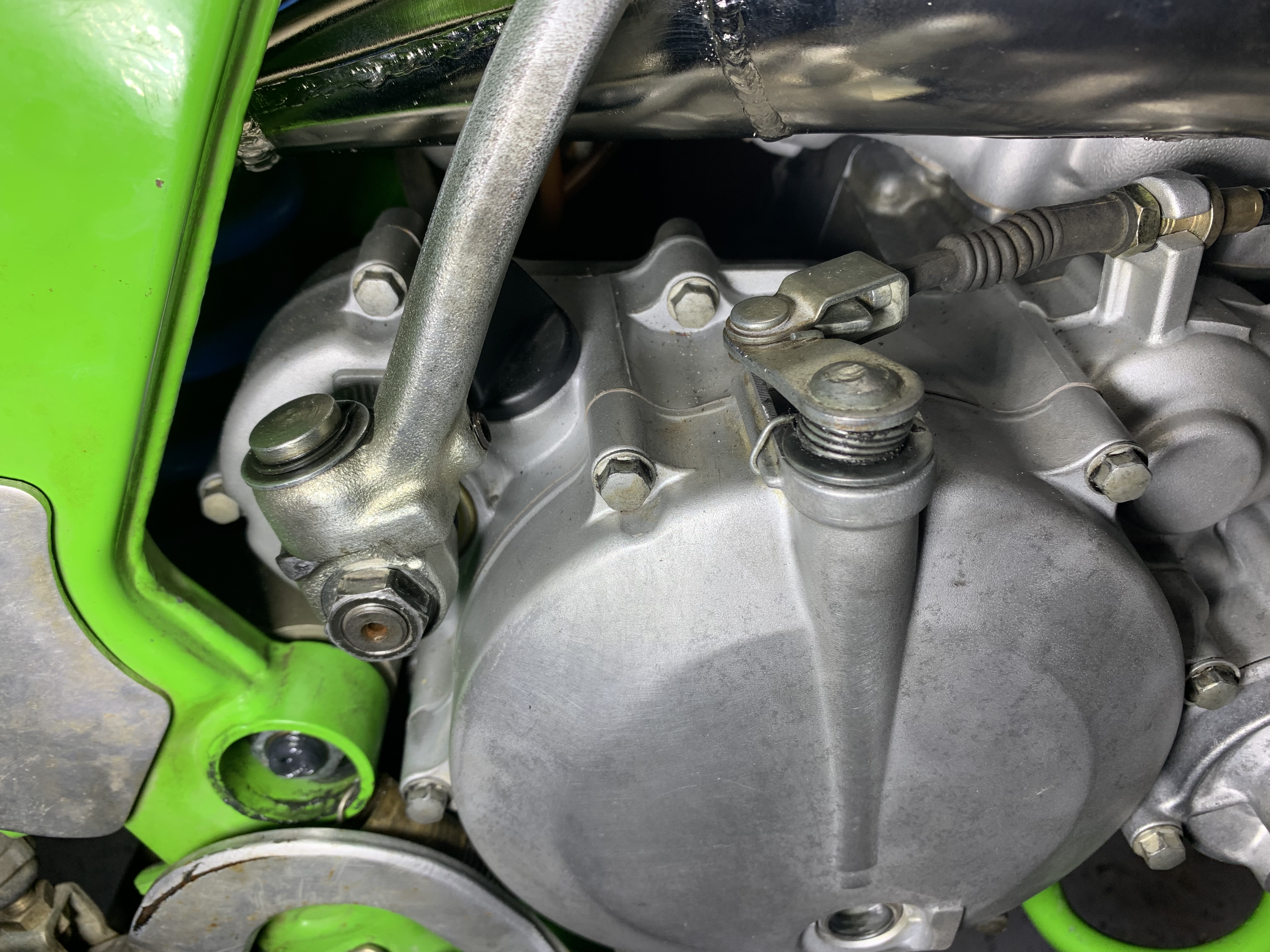

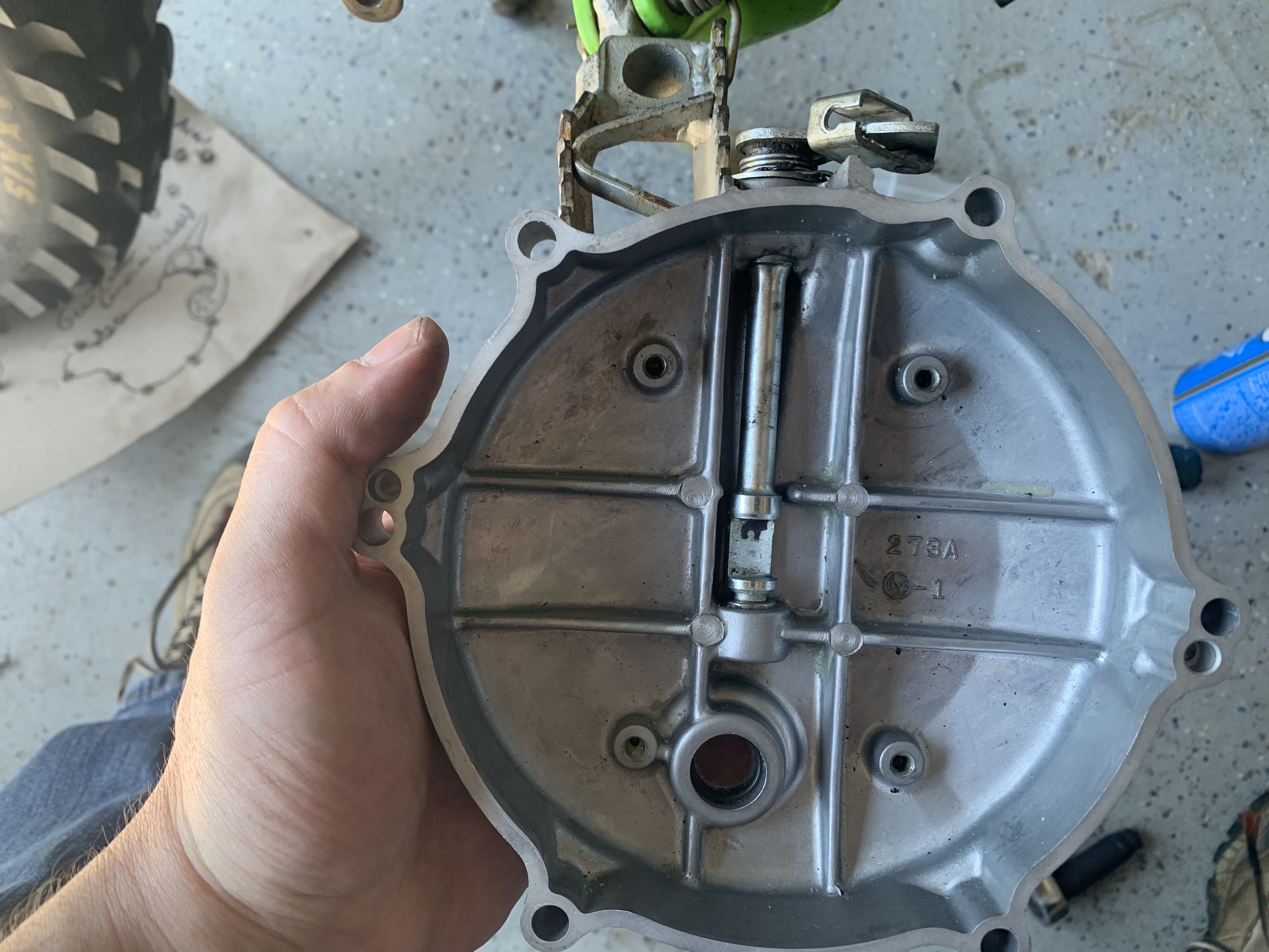

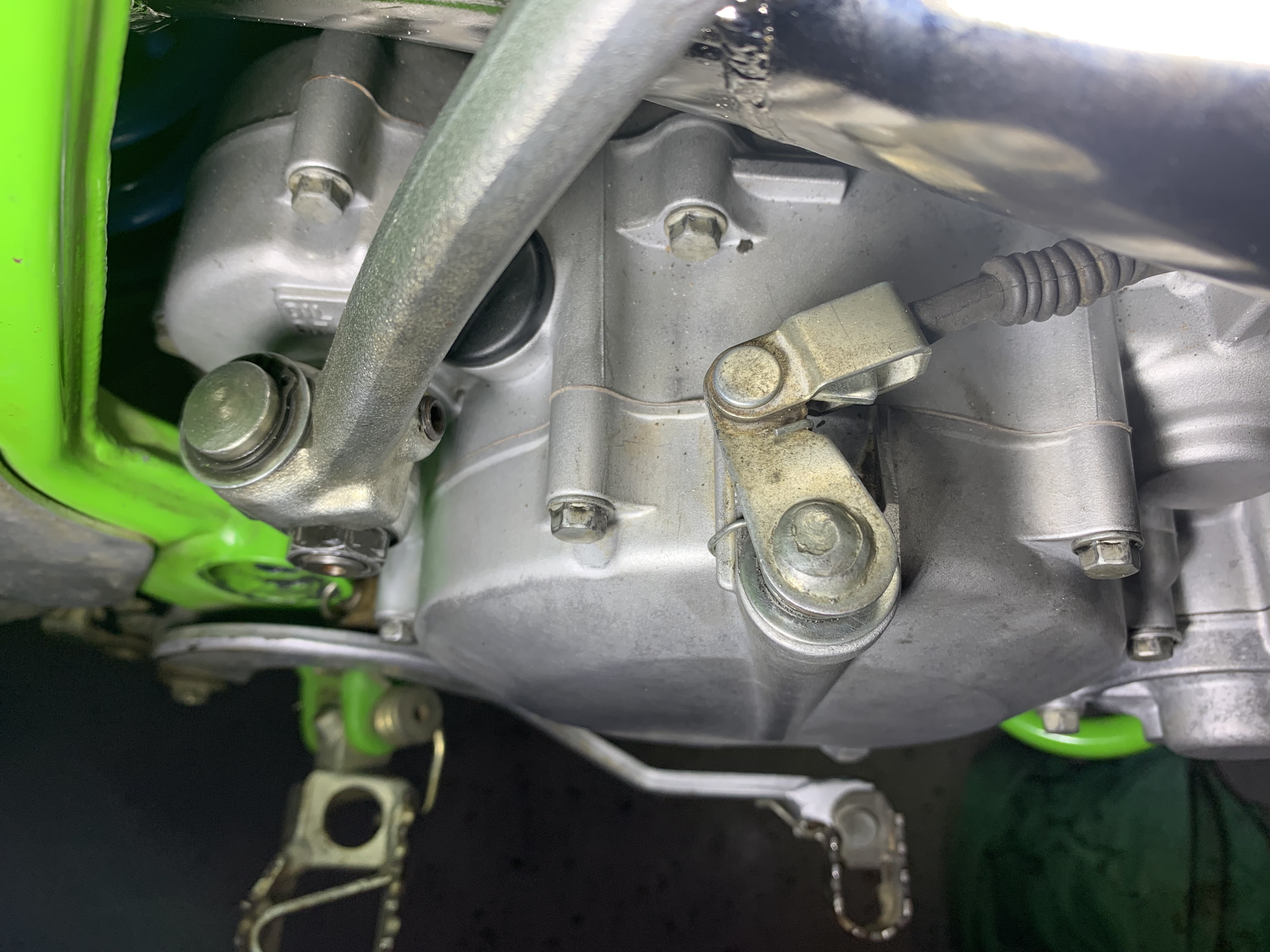

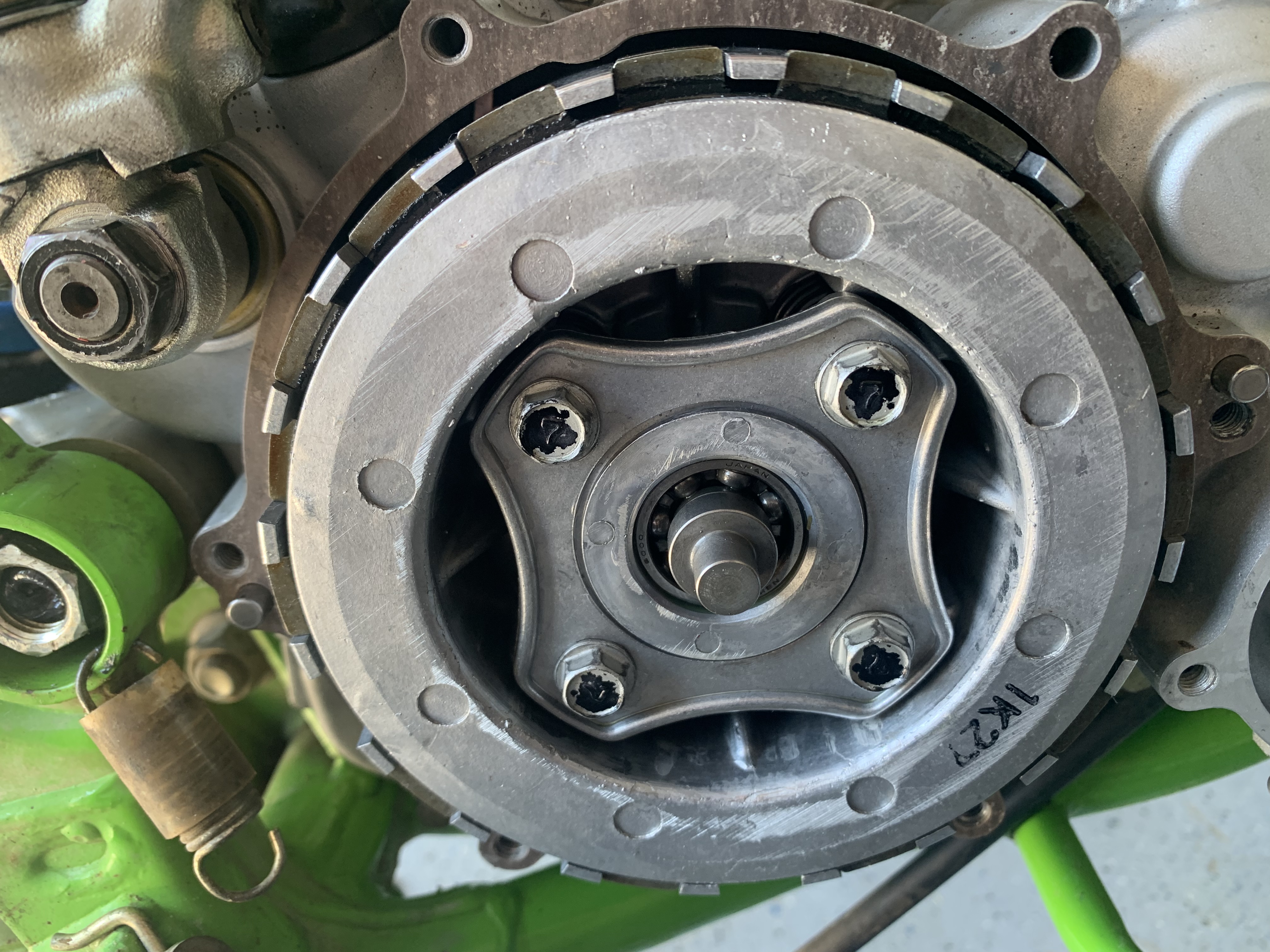

Hello all,
Complete rebuild done on bottom and top end. Engine runs great and I can’t wait to go ride!
I have one issue with the clutch though. I did not replace anything on that clutch and was expecting everything to work as it was when I would put it back together but it is not!
I felt some resistance in the arm lever when I hooked the cable to it and I also felt some resistance on the first lever action but after that single action the hand lever became loose. It is only coming back because of the spring on the arm lever. It is like nothing is happening inside that cover.
Here are some pictures of how I did put it back together. Let me know what you think.

Something was assembled incorrectly. Did you install the conical washer in the correct location and orientation?

Thanks. The conical washer was installed right before the center nut and pointing out.

Looking at my pictures I notice the marks on the clutch hub. Not linked to my problem but I am just curious on what did happen to make these marks!?! The inside of the cover shows no marks.

Make sure when you put the clutch cover on the actuator is pointed towards the rear of the bike.

Re: Clutch issue after rebuilt
I installed it exactly like shown in the picture. I had the right side of the bike in front of me. I did flip the cover 180 degrees and it went on like that. That makes the actuator pointing the rear once installed. You can see a picture of what it looks once hooked to the cable. Thanks again for the help.
As soon as I get some time I will uninstall the whole clutch and picture everything to show how I did it.

Check some other clutch parts on eBay pictures, as I think someone mentioned they were not exactly sanded to a high luster from the factory.

I wouldn't worry about the end of the clutch hub. If you notice, all the marks go in the same direction so it is not something caused by running the engine. It is from the manufacturing process or someone dragged it across something when it was out of the bike. Either way, no worries.

Dont worry, my clutch has the same... i was already wondering too. It has to be from the factory process.
