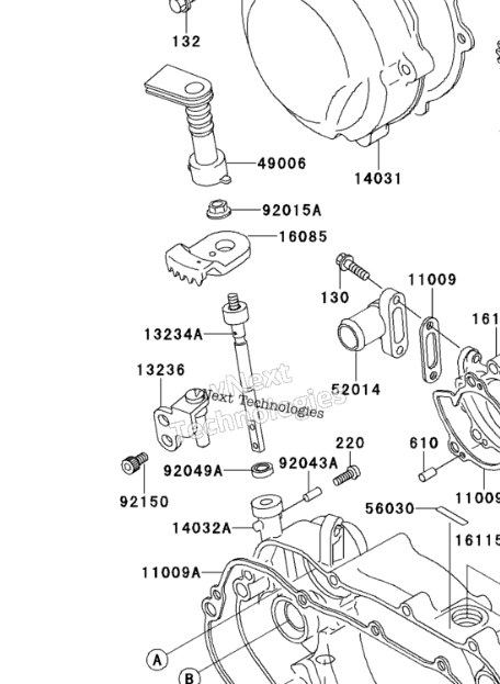

That said, double check that you installed the KIPS pawl (diagram number 16085 - they call it a gear) in alignment. Also wouldn't hurt checking on the stock silencer and making sure it is free flowing. To find and air leak on a 2T you really need to do a leak down test as there isn't a constant vacuum in a 2T but a push/pull of vacuum and pressure.
