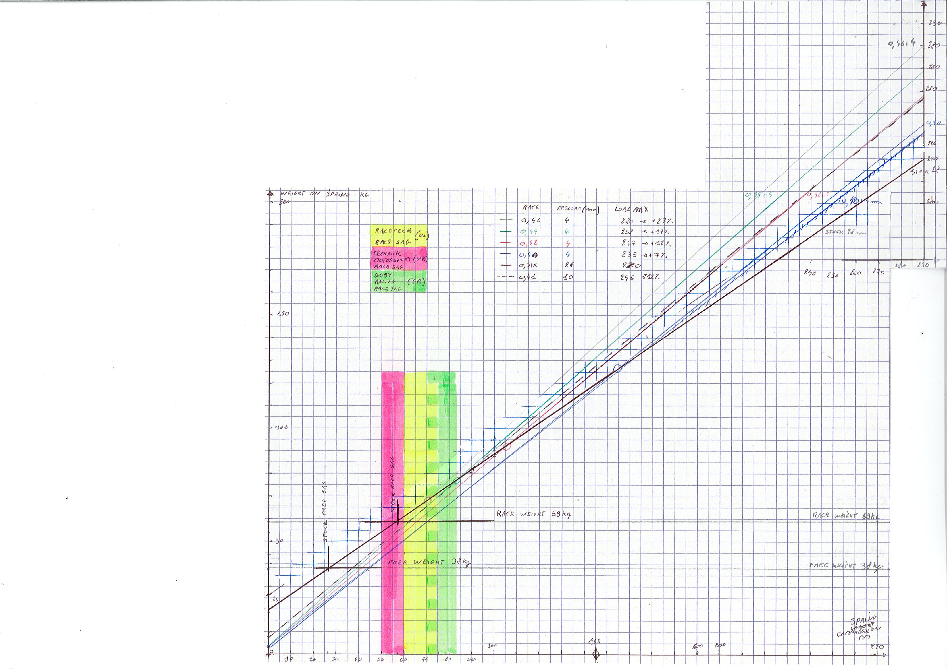

While waiting, I had fun studying Racetech's bible spring chapter, and drew a little graph showing spring rates. Please feel free to correct if my calculations are off.
The horizontal axis shown spring compression, in mm. The vertical axis show weight applied on spring, in KG. I drawed the lines for a pair of springs each time (double the weight, for the same length).
I added preload force ( F = Rate x Preload length, ex: 0.42Kg/mm with 10mm preload: 4.2Kg, times 2 for your pair of spring, 8.4Kg of preload), which does not affect the rate (the slope of the line), but moves the line up or down.
The first line I drawed, in black, is the stock spring. 0.345Kg/mm with 28mm of preload (Dear KDXgarage, I saw posts from you talking about 28 or 38mm, and from other post with measurements I guessed 28mm).
Now, I got on my bike and measured free sag (26mm) and race sag (57mm). I crossed this with the Stock Spring rate, and went horizontally to deduct the applied weight of free sag and race sag. This weight being independent of the spring rate, I should now be able to predict free and race sag with other spring rates and preload values.
I highlighted in yellow the recommended race sag range from Racetech. I added recommandations from other tuners, but they feel a bit odd to me.
I should add now that this graph only shows the spring rate, omiting the "air spring" effect that is tuned by the oil level. This curve, according to RT's book, is quite like an exponential, with almost no effect at the start of the stroke, and huge effect at the full compression. However, this air spring rate is the same whatever spring rate we're using so we can forget it and compare springs.
Now the fun begins: I drawed the common used spring rates, with 4mm preload. 4mm preload with various spring rate gives about 3.2Kg (.40 springs) to 3.7Kg (.46 spring). In comparison, the stock weak ass .345 spring, once preloaded to 28mm, produces almost 20kg of preload force!
I drew small circles where the lines cross the stock line.
The graph shows clearly that there is lots of ways to get the same Race Sag, heavy spring with small preload or light springs with stock preload. However, albeit having the same sag measurement the soft spring will be stiffer in the first half of the stroke and weaker after that.
We can see here that a .40 spring (blue line), will be weaker than stock until mid-stroke (145mm), and stronger to the end of the stroke.
Even the .42 spring is lighter until being 105mm in the stroke.
I added a line for .41 springs with 10mm preload to show the effect (dotted black line). While having the same full-stroke force a the .42/4mm, it will be harder throughout most of the stroke, albeit quite close.
Lastly I compared the force needed compress the springs 290mm, based on the stock spring. (Mistake on the .46, it's 270kg, +23%). The difference seems a bit small to me (but what do I know?) compared to the huge effect of oil level at the end of the travel. So maybe the bottoming problem should be dialed in with oil level. We'll get to that once the spring is sorted.
Now, I could just get whichever spring rate has been advised for 30 years but, isn't it enjoyable to get some stuff down on paper and verifying it afterwards? I'm going for .42 springs.

Thank you for doing the math and posting it.

Wow! You really dove from the 10 meter platform straight down into the rabbit hole! I applaud your commitment! Nice graph too.
For the riding you are doing, you are on the right forks. Those springs will really help. Save your money and get the gold valves done and you will be all set. I’m riding similar terrain here in Virginia/ West Virginia and both the slow knar and fast flowing jumpy stuff. My forks leave nothing to complain about. Improving my riding skill and having my weight in the right place at the right moment has also improved my bike’s handling.

That is an awesome chart. Thank you for posting it!

I also re-used the springy washer that clips inside the spring and the cupped washers from the stock spacer.
I stayed with the exact same oil (7.5 Motorex), 120mm level, 4mm preload.
Low level of preload are tricky to measure, 4mm is almost nothing. After doing the first leg, I compared it with the stock one by compressing it. It feels really softer in the first part of the stroke and significanlty harder after that.
Can't wait to try the bike!!

- Posts: 55
- Joined: 03:16 pm Feb 21 2021
- Country: France
Re: 96 KDX200 - Suspension Setup
Hey guys!
I finally got the chance to test the bike today, a quick 45 minutes ride in the easy trails around the house. Didn't dare to push too much though, having not ridden for a month.
First impressions:
Definitely less deflection, the front wheel tracks the terrain variations and the fork actually function. I was able to speed things up on little rocks that used to send me off the bike (5th gear wot, 2-3 inches rocks, didn't dare more)
Less dive under braking, which is nice because it allows to brake much harder, and on steep descents it's less scary.
Less preload on the front, eases up the load on the rear spring => More grip exiting corners while pushing the pegs. More grip on uphills.
More lively and faster response when wheighting the pegs to pop the wheel up
On the donwside, on the top part of the stroke (which is used when accelerating), the fork feels very soft, like being on a flying carpet. Like there's no feeling at all. But maybe I'm just too much used to feel each little rock on the trail impacting my arm bones!
Overall the bike just feels "proper" now, and I believe it was weirdly unbalanced with stock springs.
Next time I'll push harder, try some jumps and some rough stuff to test the deepest part of the stroke.
I definitely recommend changing both springs to anyone hesitating. Don't lose time like me, there's no point bothering with the clickers or shim stack mod or whatever before getting the right springs. Especially the rear.
I would love to try making longer spacers to get a little bit more preload. Or maybe fabricate an adjustable preload fork plug, to get the things just perfect before digging more into suspension black magic.
Next step: Gold Valves or... Shim Restackor and more hand drawn graphics?
First impressions:
- Posts: 14643
Congratulations on your success! Thank you for writing it all up for the benefit of others to read and learn.
