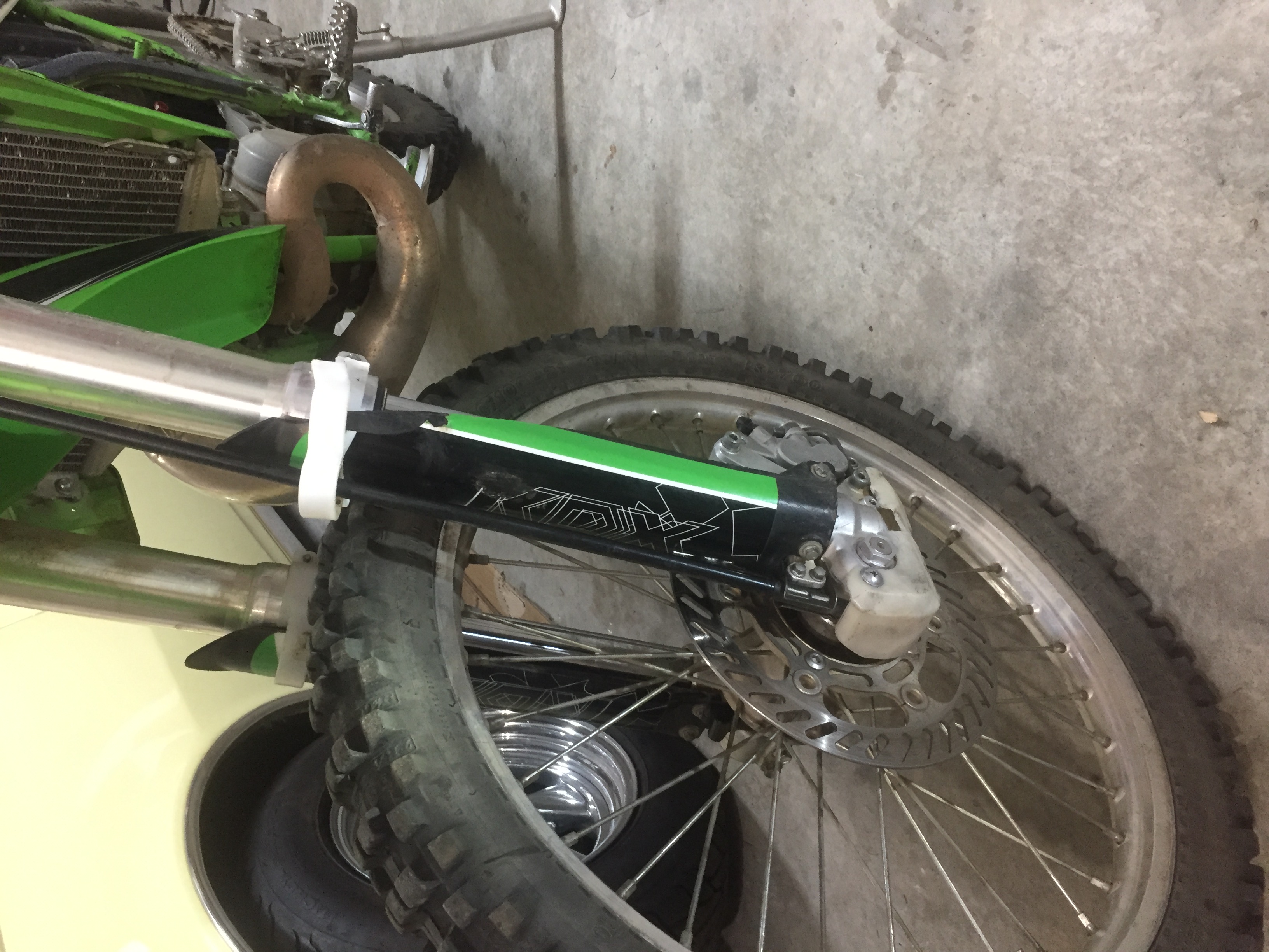

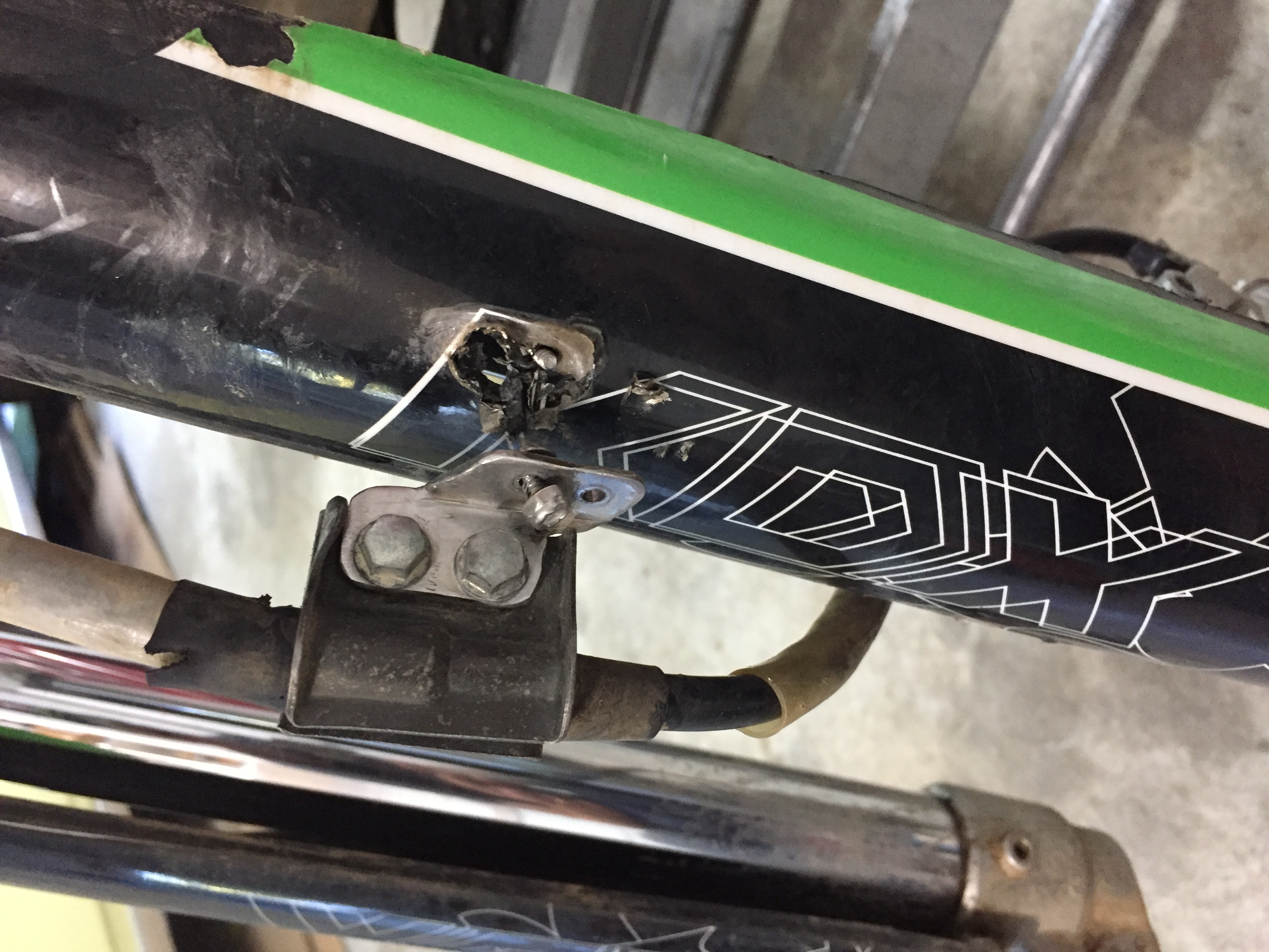

So much for my fancy Honda front brake routing setup. Not sure what I hit this time. I used my handy dandy HF plastic welder to patch the hole, and went back to KX brake routing. I also could not find a good way to keep the odometer cable routed so it didn’t get goobered up on every other ride. So also pulled that off before it got ripped off. Too bad, I quite liked the Odo. But nice to have one less thing to fiddle with.

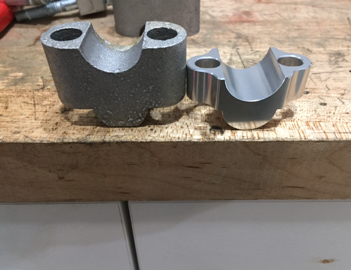

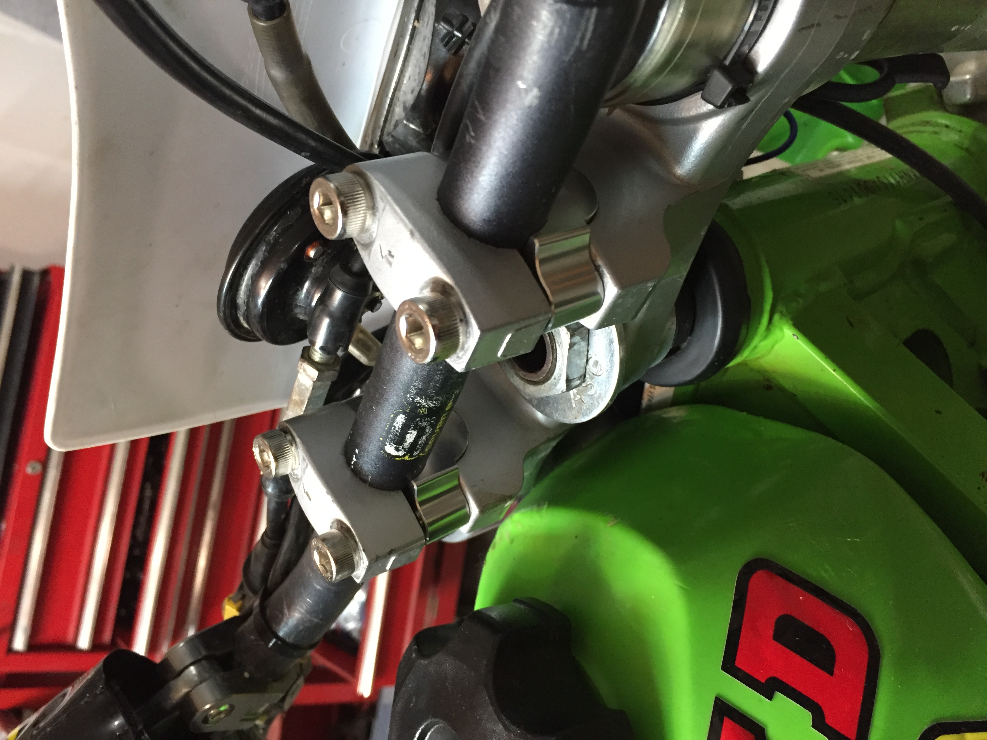

A while back, RMATV got the Tusk 1/2” risers back in stock at normal price. So now I am running them with the forks 27mm (30mm if you include the top plug), and swapped out the CR Highs for the CR normal (lower) handlebars. I am sure more fine tuning to come.
It is very interesting to find that the very small difference in these handlebars gives the bike a different feel. When hauling freight in “attack” position on relatively horizontal ground, the low bars are the deal. When climbing nasty gnar, I like the taller (more forgiving bars). If I get out of position on hard climb the low bars want to pull away. I thought my throttle was sticking on first hard climb with them. Until realized that it was just me trying to lean back & hang on at same time. Need another track day before I decide if I switch back.

Meant to say forks are at 27mm above TT. The Tusk spacers are way better build quality than the others, but do look a little too shiny for a work horse like mine.

Yes KDX line worked fine for KDX/Honda style routing. I made error of using the KDX upper hose guide on lower triple clamp, which is a little too low for KX fork travel. So it ripped off my mounting bracket when I cased it bad on a track jump. I think the KX bracket will avoid this since it is higher (and since I am no longer using KDX as MX bike).
So eventually I will go back to the Honda style. It’s on the to-do list, but pretty low priority since KX routing (under caliper) works fine too.

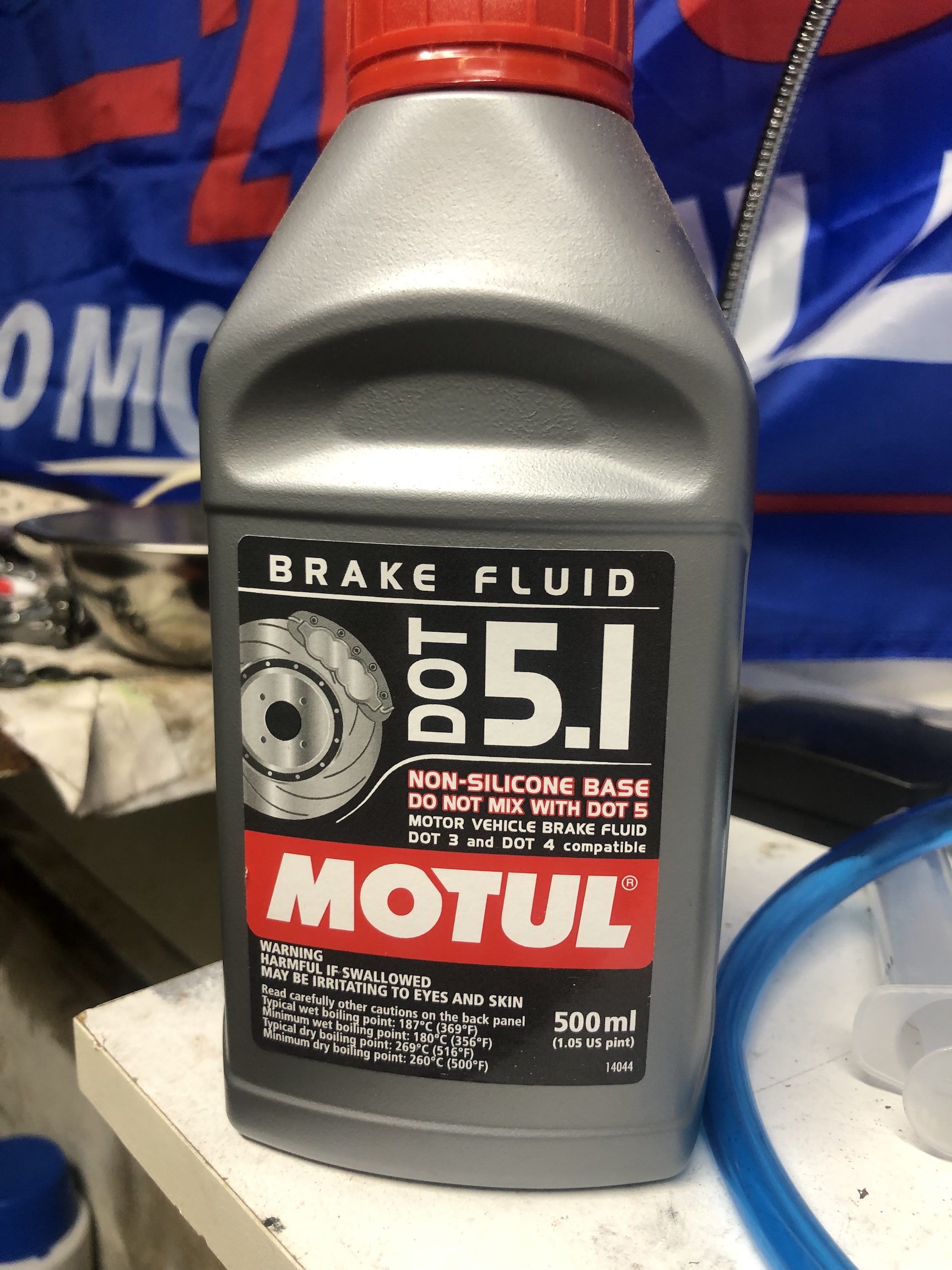

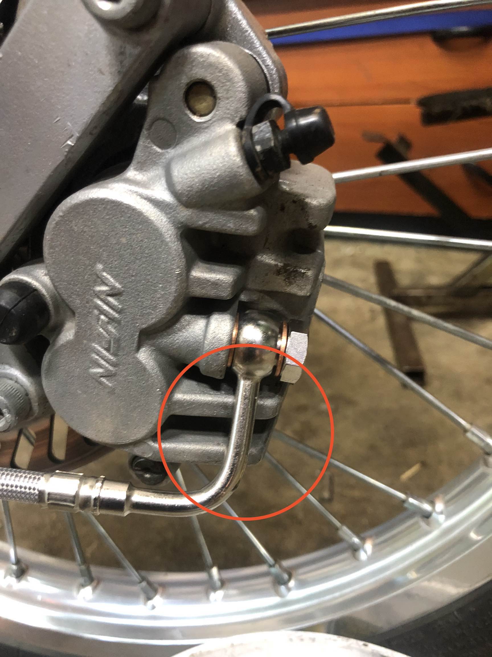

Finally got my Galfer re[placement line for the front. Im using the KDX caliper, RB axle mod, KDX front wheel. I know the calipers are different, so would grinding some area off the bottom work? Need the KX line to better fit under the fork..
And I have some Motul Dot 5.1 on hand. Ok to use for a new clean line?

DOT 5.1 can mix with DOT 3 or DOT 4 so no issues and you don't have to flush out anything special. Just do a standard bleed of the system. It will probably take you 5 or more times filling the master cylinder, and then bleeding it, to get all the old stuff out. Small note... NEVER mix any of those DOT fluids with DOT 5 or you'll have real problems!
You should be able to grind the support ribs on the caliper but keep it to the minimum you can. Otherwise, you risk the caliper flexing (leading to a mushy feel) and it will hold more heat.
