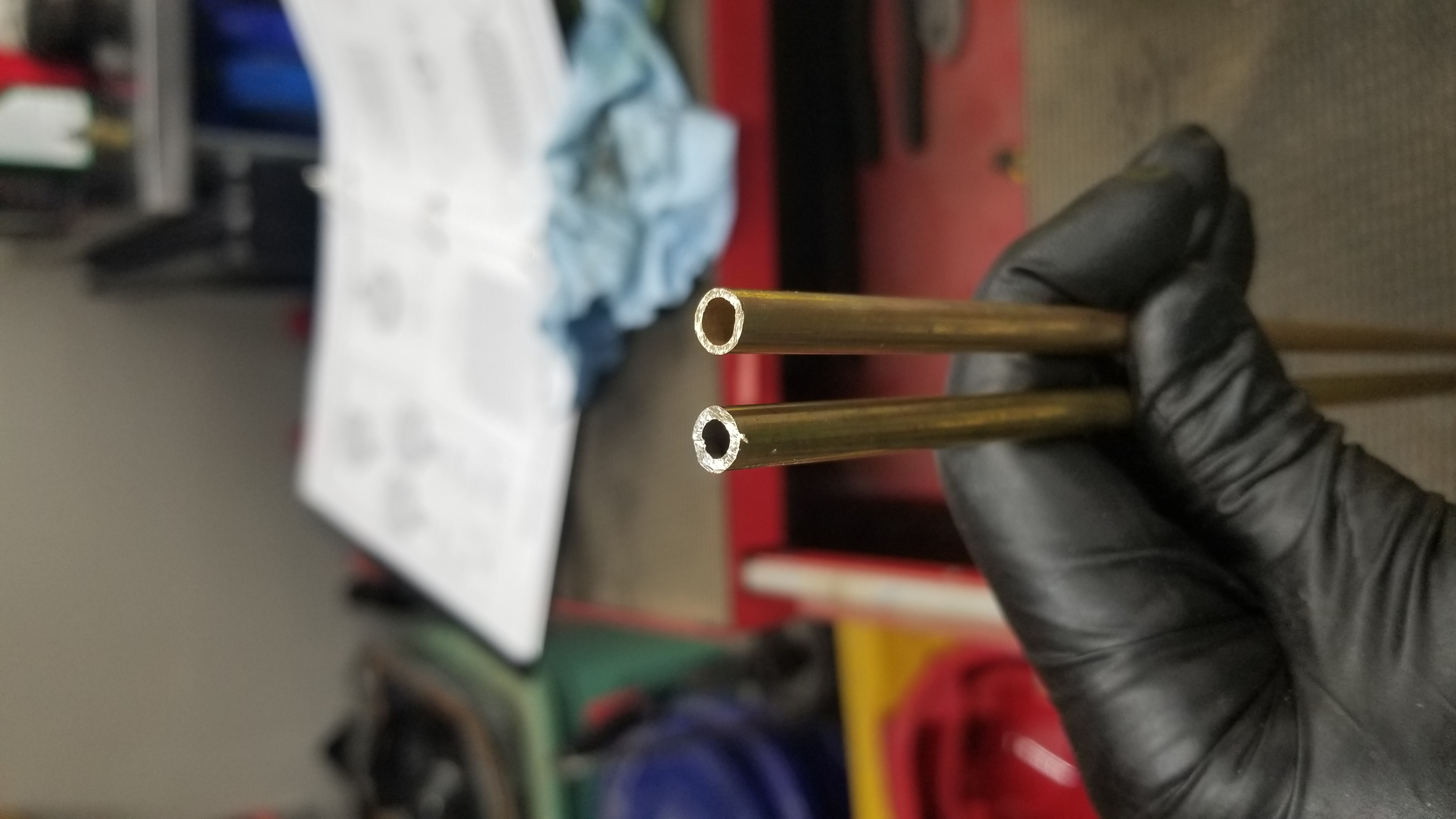

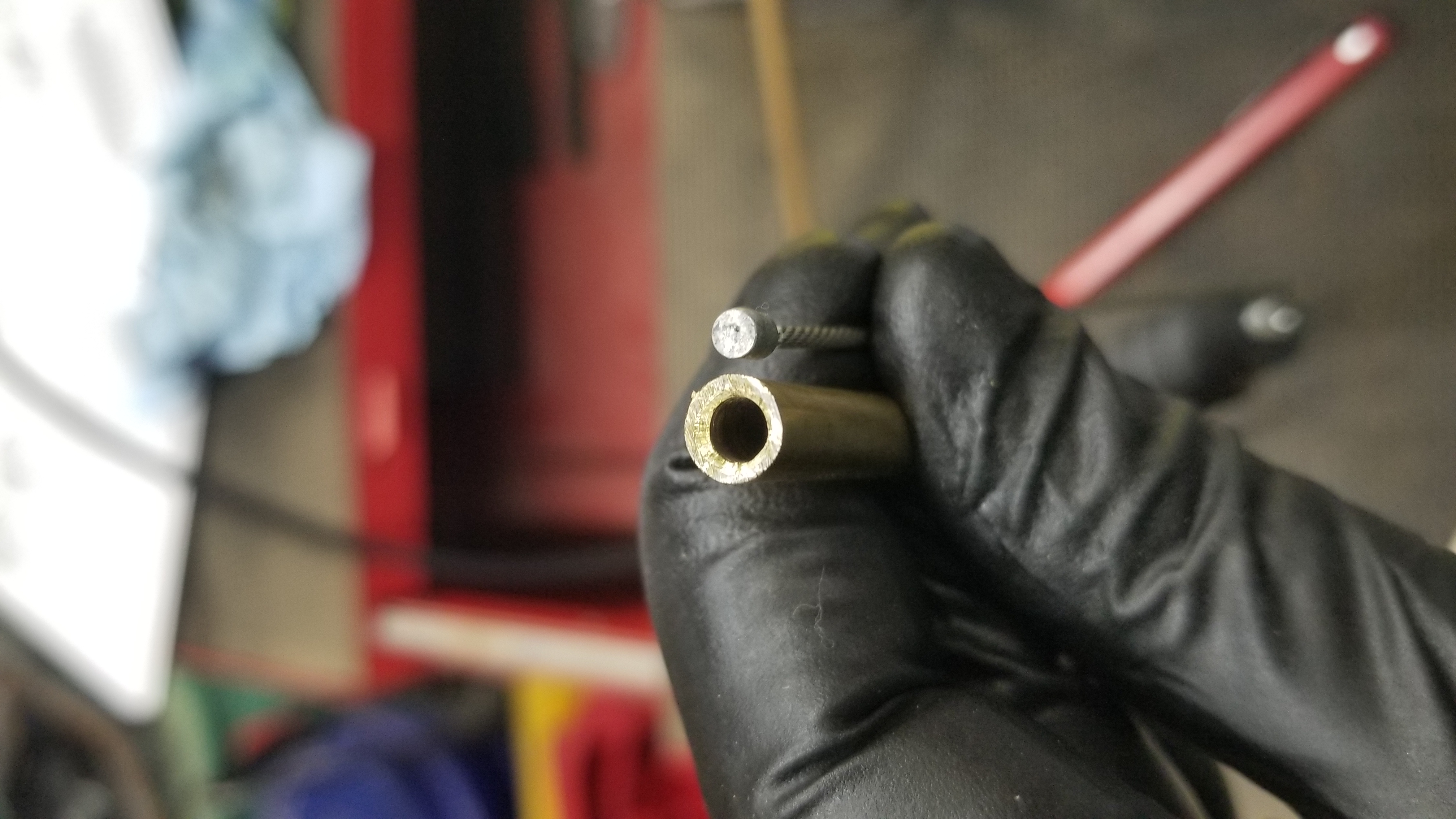

35mm PWK Throttle Cable Guide
Just got my tubing in!
The larger wall stuff looks like it is going to work, measured OD and it comes in at 0.253 vs 0.250 of the oem tube, which is loose in the cap.. Cable end fits in properly and should give me no hassle. Tubing is crazy strong, might even be too much so. If it is, I will use the thinner tubing. Either way, expect a move this week on bending and threading!
Now the question, do I polish something I will never see again??

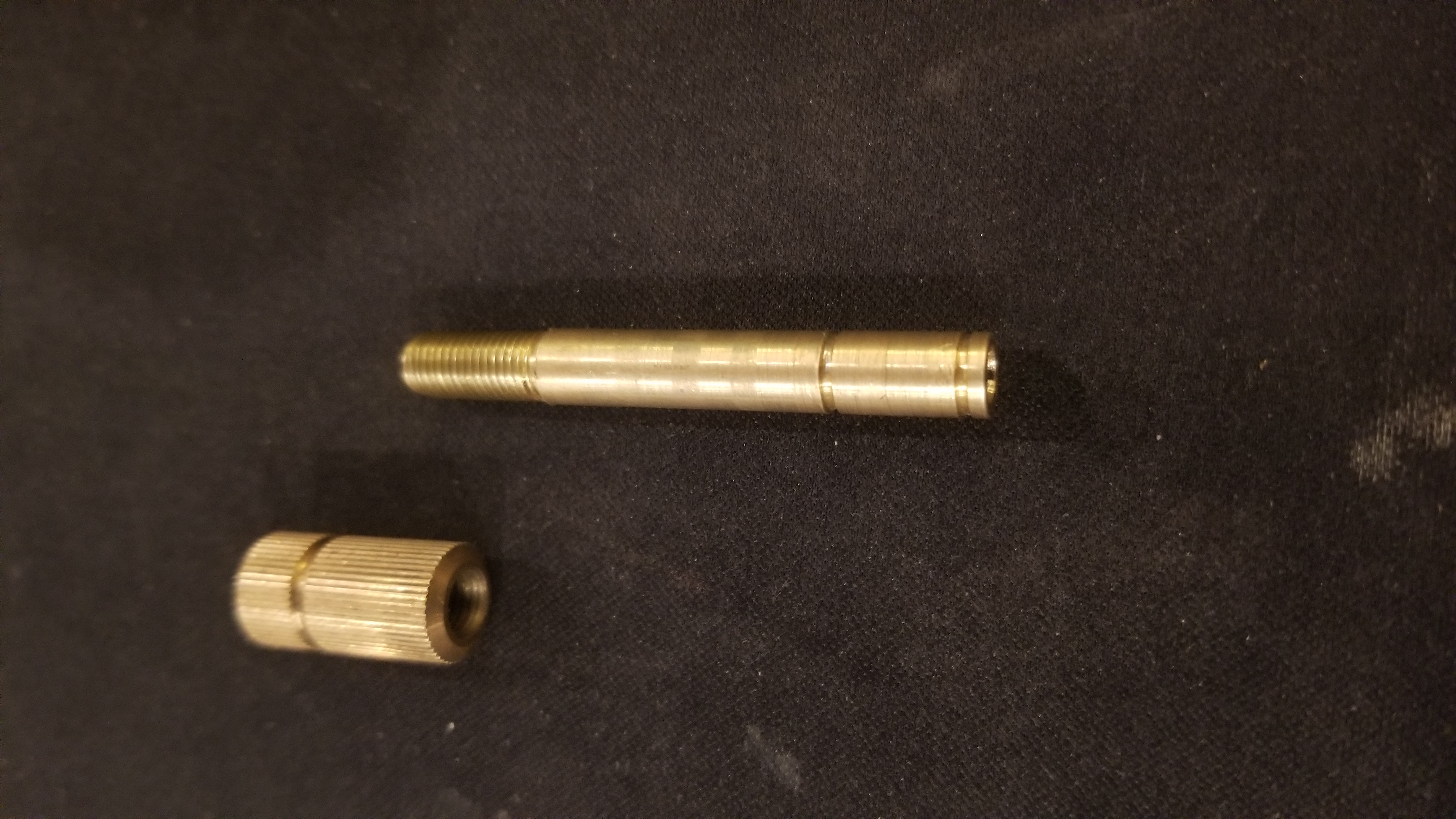

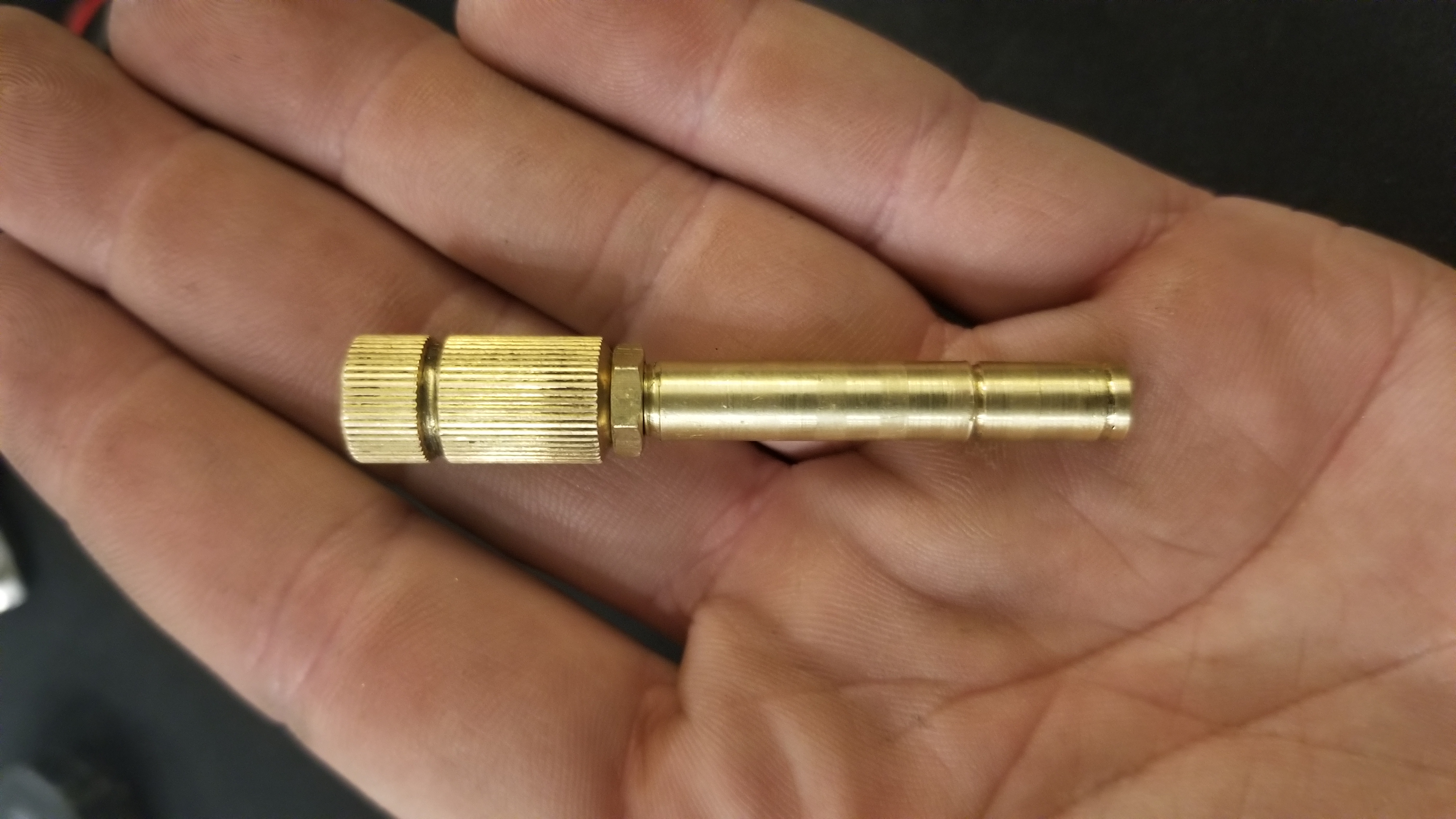

Here we go! The big reveal!
Took forever because it was like the first time for anything. First I need to figure out thread size, which is an odd size and hard to find dies for, then my buddies lathe tooling was all garbage and couldnt cut warm butter, so I had to source some new scamazon stuff(which worked quite well on this brass..), and then I was busy, then the Nevada 200, then every other excuse. So anyway, let's get to it.
I had to design the part in order to make it serviceable in the future(hopefully never), and that took a bit. So once I had the CAD drawing done, I got to work, cutting, measuring and making chips. And to my surprise, my first iteration fit the cap snug and better than factory. All that was left to do was thread the end and bend it. Well, I forgot my die and die driver and when I got home, I realized I left too much material on to start the die, so 7 to 10 business days on getting back to my buddies to chuck it up in the lathe and turn a mouse ass hair off it and taper the beginning to make starting easier. Worked like a charm and the thread form turned out perfect! A perfect fit on the nut and adjuster! So I was happy about that.
All that is left to do is bend it, and I. Am. Nervous. I know I need to get it red hot, but I gotta go get a pencil torch to heat such a small area. Hopefully make it to the hazard fraud tomorrow and get one and finish this off! Would that be something?
Sorry for lack of photos and updates. Didnt want to post a bunch of garbage and have it fizzle out. I guess it still could, but I remain hopeful and optimistic!
As far as making these for people, I'll do it, but i doubt anyone will pay what it's worth. This stupid part takes a lot to make between special tools and tubing and whatever else. If you really have to have one, message me.
That's all for now!

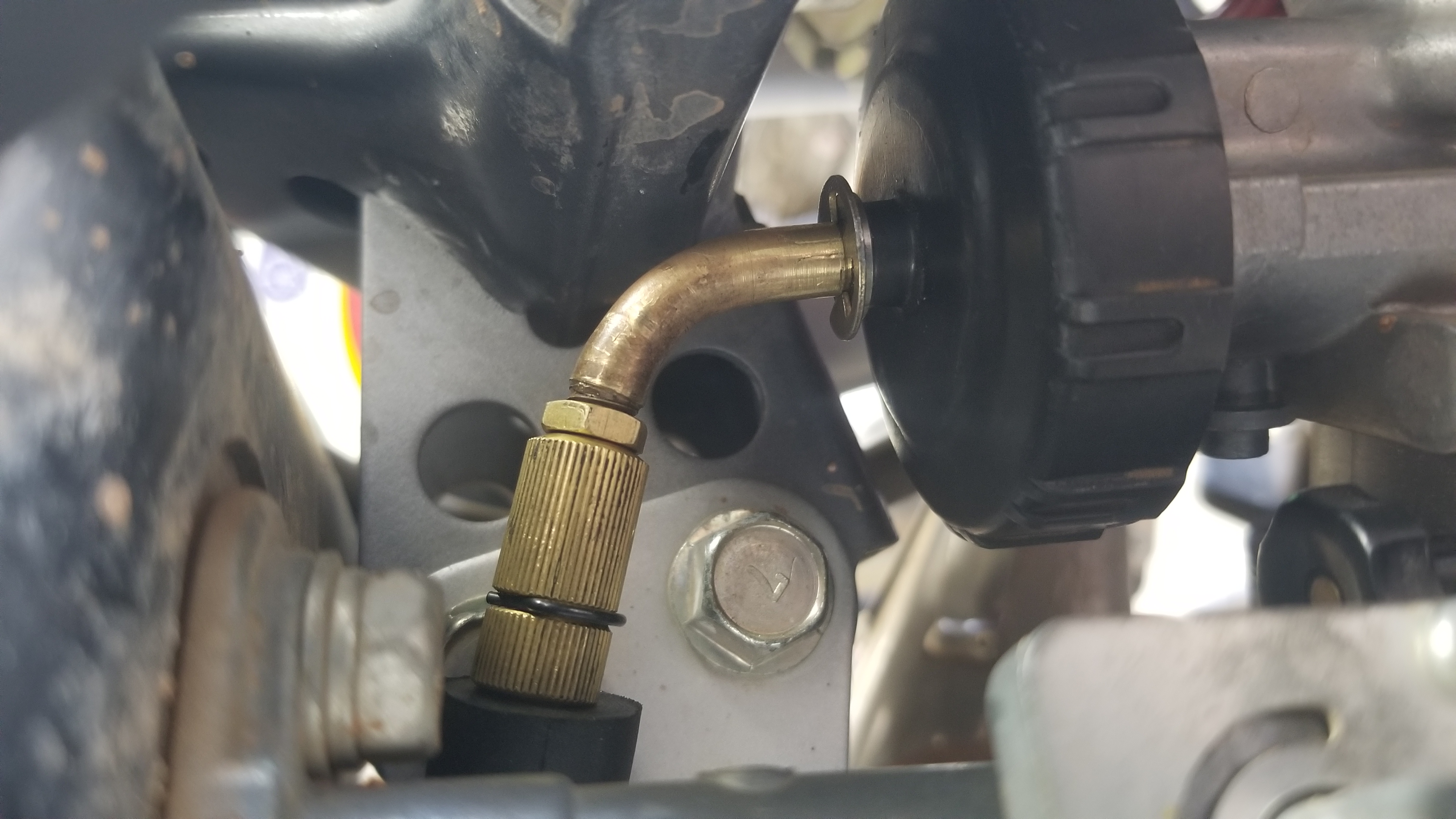

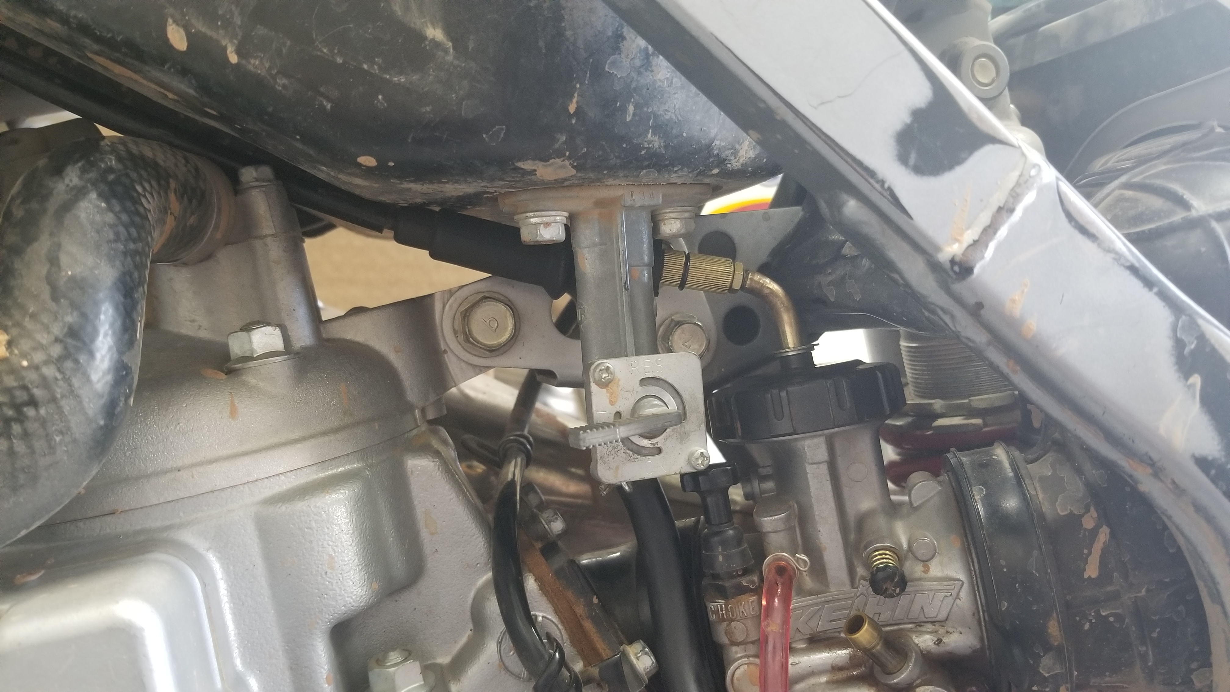

So here we go again..
Got the part done and installed and ready to zip!
To bend the tubing, I had to anneal the brass first. Get it to 800 degrees for a couple of seconds. This reforms the bonds and structure to make it more malleable, like copper almost. Once you anneal brass, you cant un-anneal it though. But I'm not worried about strength. This tubing is ridiculous. Metallurgy lesson for the day.
I did have to bend it a couple of times to get it right. It required a more steep angle than the stock elbow as it sits higher and closer to the tank(see pics). On the next one, I wont leave the neck as long to the bend because I still had plenty of space to get the internal snap ring on. So the next one for the hybrid bike should be a bit better in the fitment department. Otherwise, I need to reconsider the e clip I used on the outside of the cap. I cant get the boot over it. I have a new cable I need to put on, so I might just waller out the boot seal to make it fit. I'll see what mcmaster has for other options.
But otherwise, it feels super smooth, and fits very well.

Re: 35mm PWK Throttle Cable Guide
It does slide over the elbow and the seal of the new tubing and tighter tolerances reduces any potential air leaks to zero. currently trying to figure out if I want to use a snap ring or circlip to potentially replace the e clip I used. I like the E clips size, but that is also its down fall. I really need some custom clips made for the inside and outside clips for this piece, but I will make do with what the world readily offers.
Will post if I change the setup and what the results are. Have to pull carb again this weekend to lower float level as the bike just leaks gas like a harley leaks oil. So I will have another go at it shortly.
