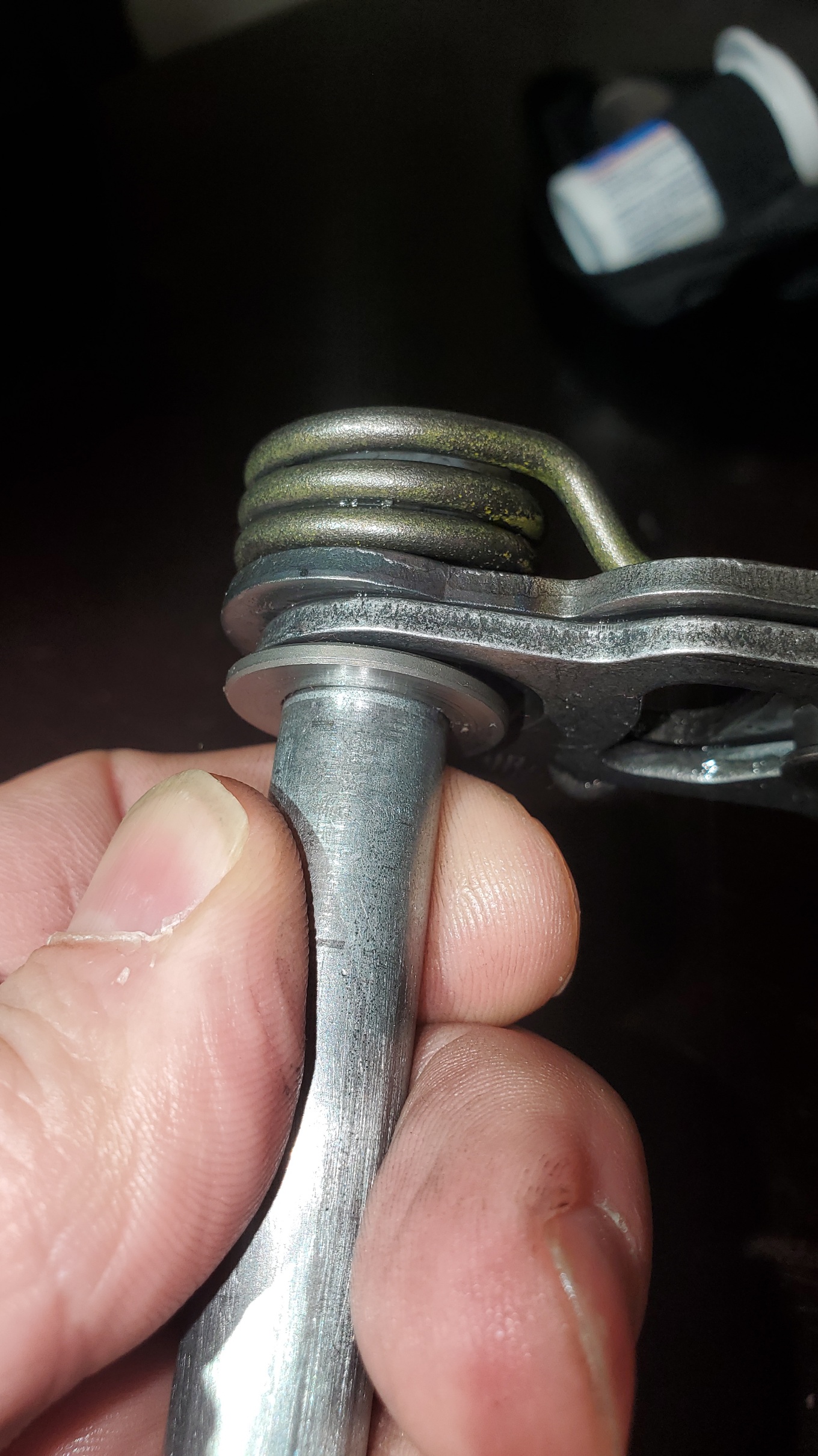

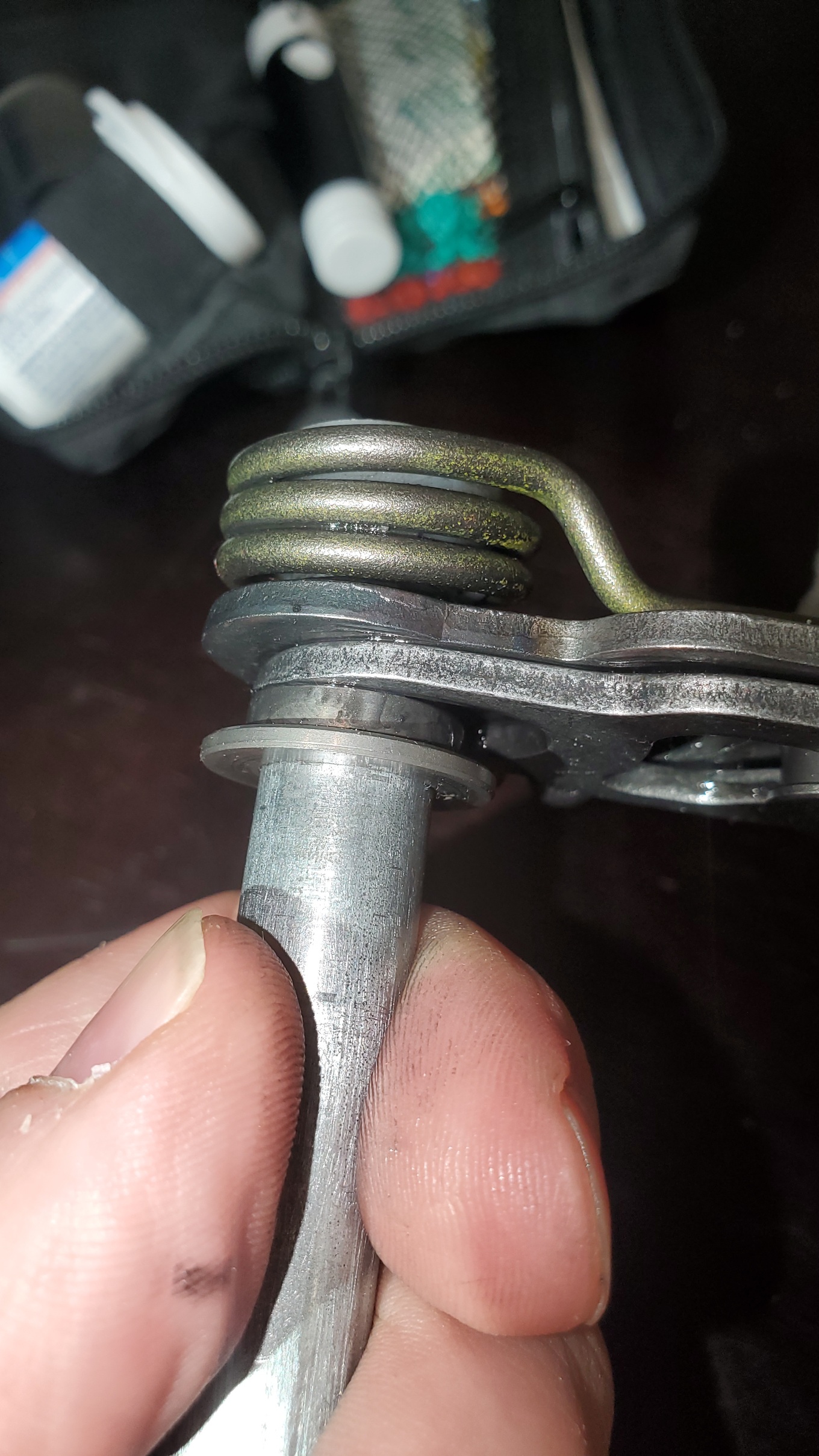

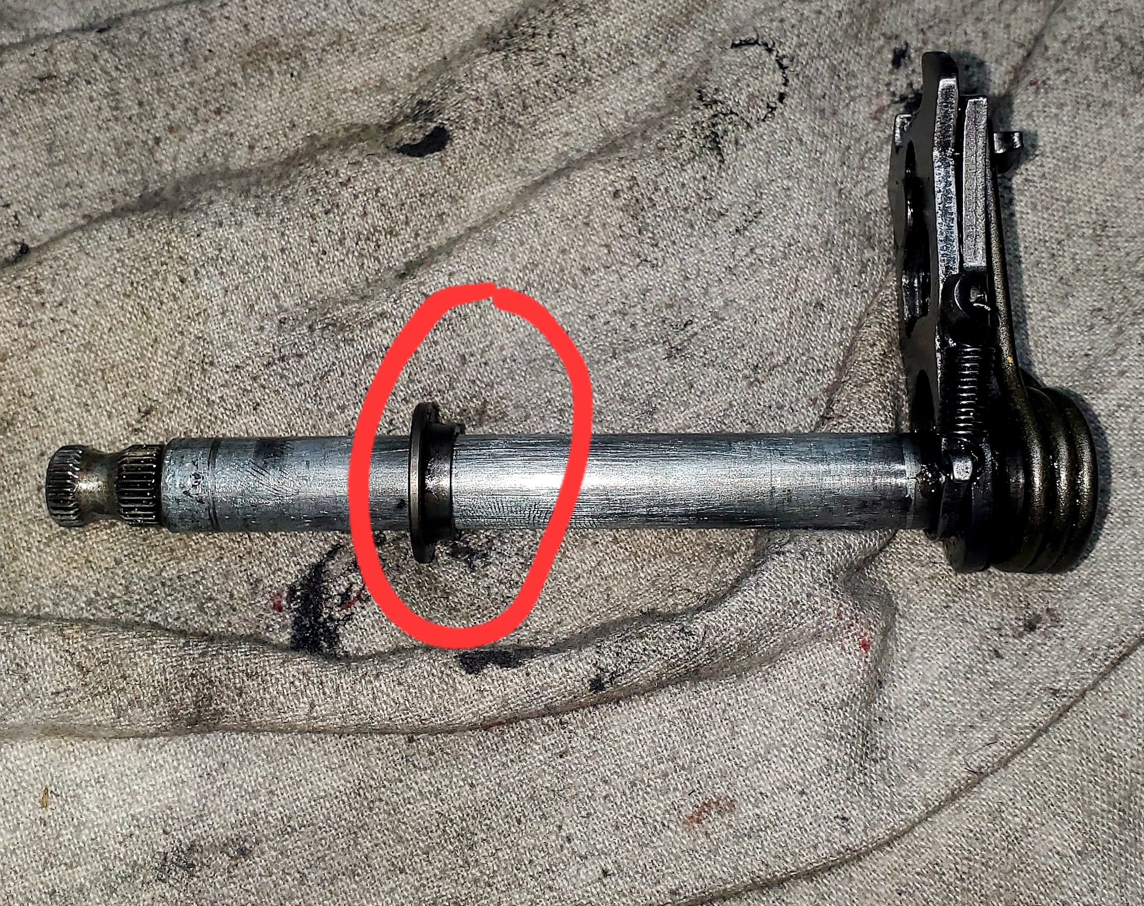

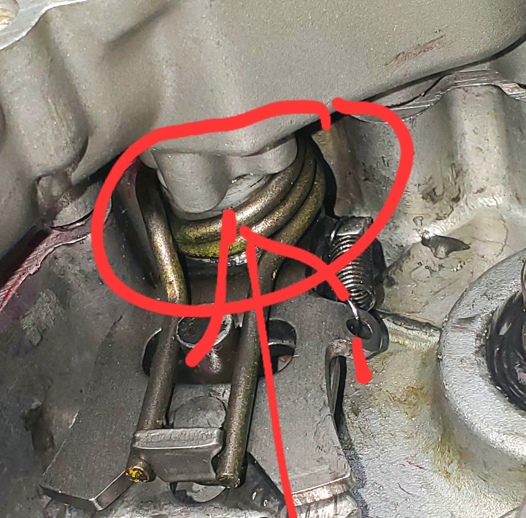

Ok has anyone ever run into thus problem.
Trying to install my engine cover on this rebuild. But the shift shaft is bottoming out on the engine cover itself (see pic).
I triple checked the orientation of that washer/collar. And it's in the proper position and everything. But the ONLY way the engine cover will install is by removing it. But that also seems wrong.
Am I missing something here?????

Are you getting the collar seated in the shifting pawl fully?

SS109 wrote: 08:51 pm Apr 02 2022 Are you getting the collar seated in the shifting pawl fully?
At first I didn't understand what you meant....but after sleeping on it I put fresh eyes on it. And yes you are correct. Ya have to slide that plate back so the collar fits inside of it.
Thank you SS109!
