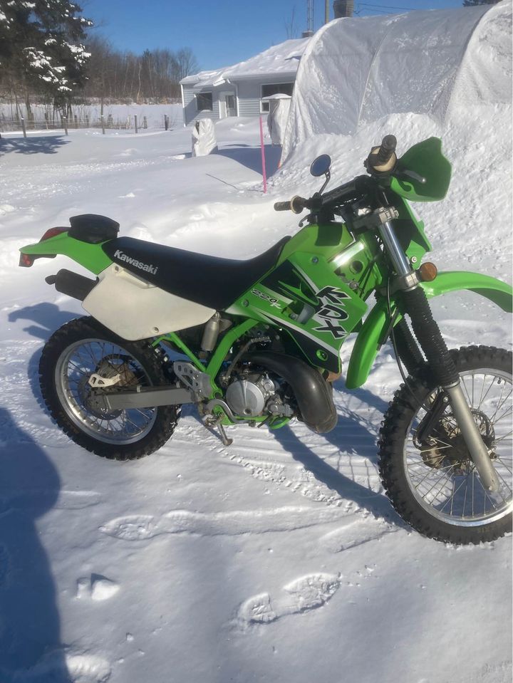

Hello all,
I took my new 220R home today and I’m pretty happy. It is a clean bike. Like mentionned in a previous thread, I know the cylinder was hone. I will remove the head to inspect. I did test the KIPS and it does NOT move at all! When I test it with the side cover off to see if it moves it does not and there is a small amount of smoke coming out. I hope not too much damages but we’ll see! The last owner was running very rich on oil! Not taking care of the ratio…mixing with his eyes….so I imagine it was more than enough oil!

Nice! Looks mostly all original! 2001? Is this the one that was for sale up in Edmonton?

It is a 2002. In Quebec. There are hard to find around here!

She’s a beaut! Those power valves will clean right up and be good as new - hopefully they aren’t broken, but if they are Fredette usually has them in stock.

Super nice original bike! It should be a runner!
Follow the service manual precisely when removing the KIPS linkage! of course, that's probably what's wrong with the KIPS. When they did the top end they more than likely didn't support the shaft and broke the KIPS governor pin.
Posts: 14643
Re: Here she is!
The nut is LH threads. Many suggest to keep the arm held steady with an open wrench or adjustable wrench when removing the nut.
