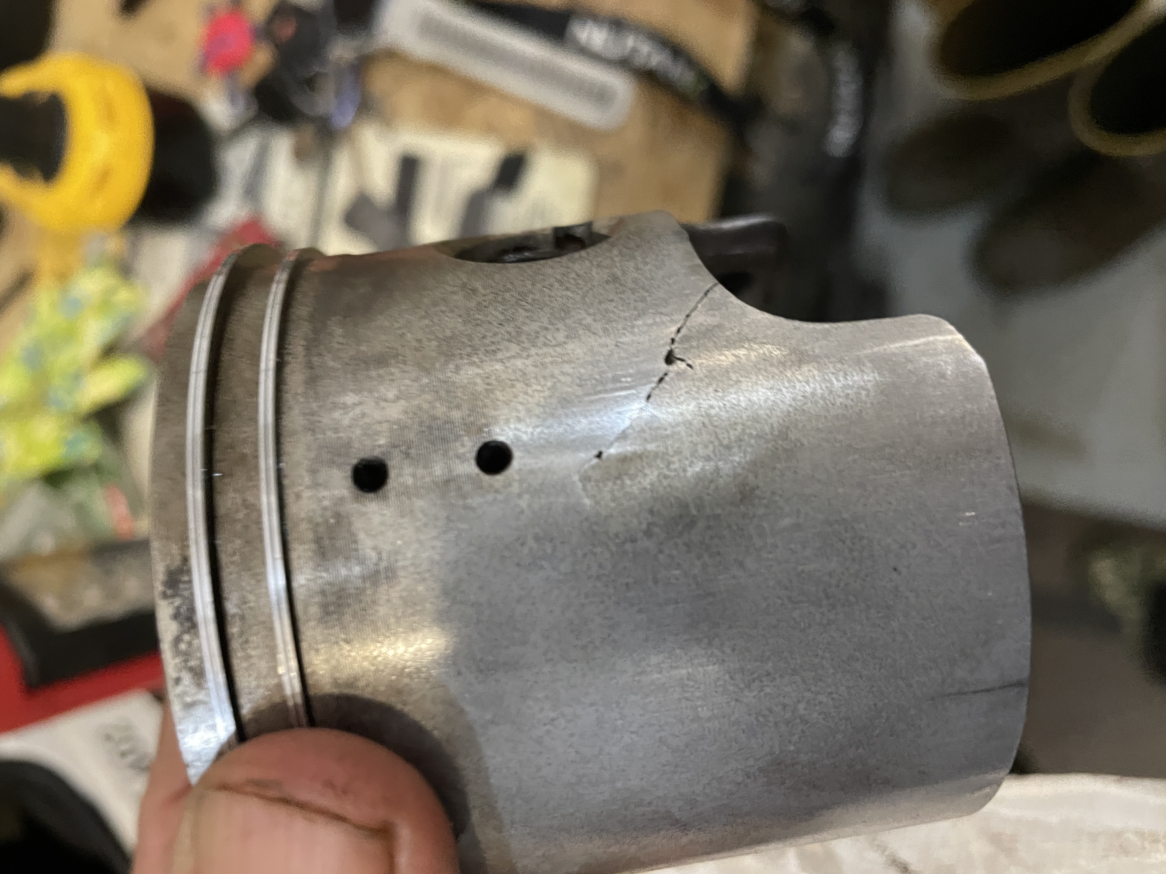

Following sound advice on multiple forums, I decided to tear down the top end of my 2001 KDX 220R. Look what I found on the piston. Can you say 3 major cracks? Wow. Major disaster avoided.

50 hours is a good benchmark.
That thing was ready to grenade. Good thing you took heed of the advice!
Re: Top End Rebuild
Run about any piston for way too long and it will look like that.
You might want to (if you have the fancy, high dollar tools to do it yourself) check for oblong wear in the cylinder / egg shaped / etc. or take it to a machine shop to have it measured. A piston can slap around for a while wearing out the cylinder.
I don't know how many hours are on that piston, but it was installed in the summer of 2000, so it has had its time. I would not suggest letting a new piston go for that long. :-)
For my putt putt self, I would do 50 hours on rings and 100 on a piston. The more you twist that throttle, the sooner the maintenance needs to be.
