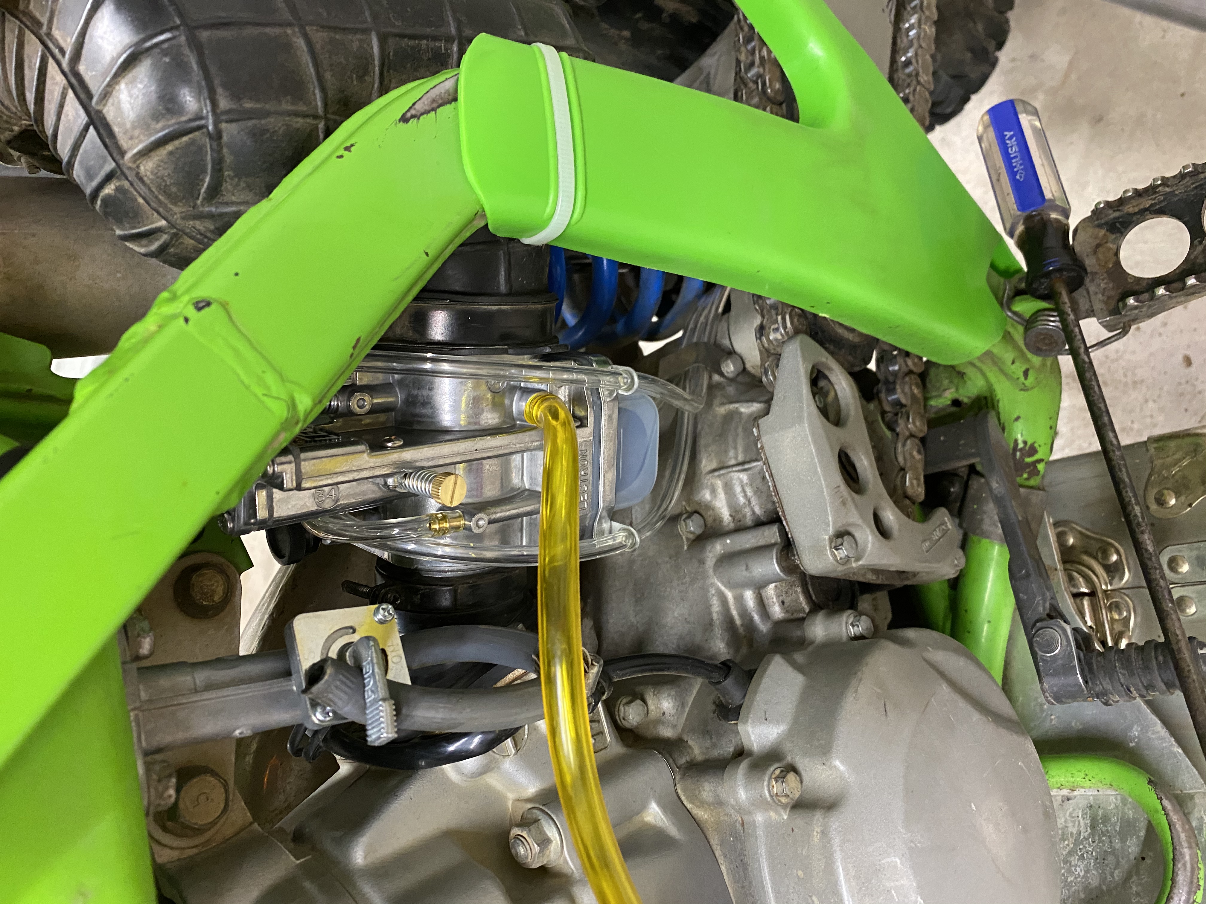

I just ordered one for my 97’ 200! I just got back into riding dirt, and remember the old days of having to dork around with jetting and whatnot depending on where we were riding. I’ll post up a install report and ride report after it’s all squared away.
- Posts: 29
- Joined: 01:16 pm Aug 09 2020
- Location: Eatonville, WA
Re: Lectron: KDX happy customers ????
I have a few rides in with the Lectron now, Much more responsive than the stock carb!! Some people were saying that they couldn't get it to fit, Lectron machines a small portion of the top and side, to allow clearance. Once in, I had to make a few adjustments to the metering rod, and it was as simple as loosening the reed and air box boots, rotating the carb out and pulling the 3 Philips head screws. Very easy. I did do the new throttle tube assembly and throttle cable that Lectron recommends, and everything went smoothly!!! First ride on it went from about 1000' to 6000', no issues that I could tell. Ran great!!!
