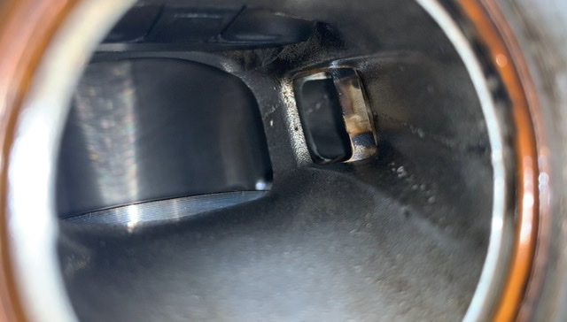

KDX220R- Millenium did a replate, cleaned pv. After new top end, bike won’t rev out. Removed advancer pawl and pipe, looked inside. When gear is cw, the sub valves open far enough to be seen in side ports. (See pic). I’m assuming this my problem?

Which version of Service Manual did you use? Some of the older OEM ones had the valves backwards in the reassembly. That would lead to poor top end performance

The KIPS was cleaned and reassembled by Millenium, is this what backwards looks like?

If that is what is supposed to be the fully open position then it looks like they mistimed the sub-valves. It happens.
Re: KIPS Help! Does this look right?
That cylinder wall is quite lovely though!

Kdxgarage- do you agree? Are they miss-timed?
From what I remember of other people's pictures, I think it is.

Follow up, yep, sub valves one tooth off! Easy fix. Thanks for the help!
