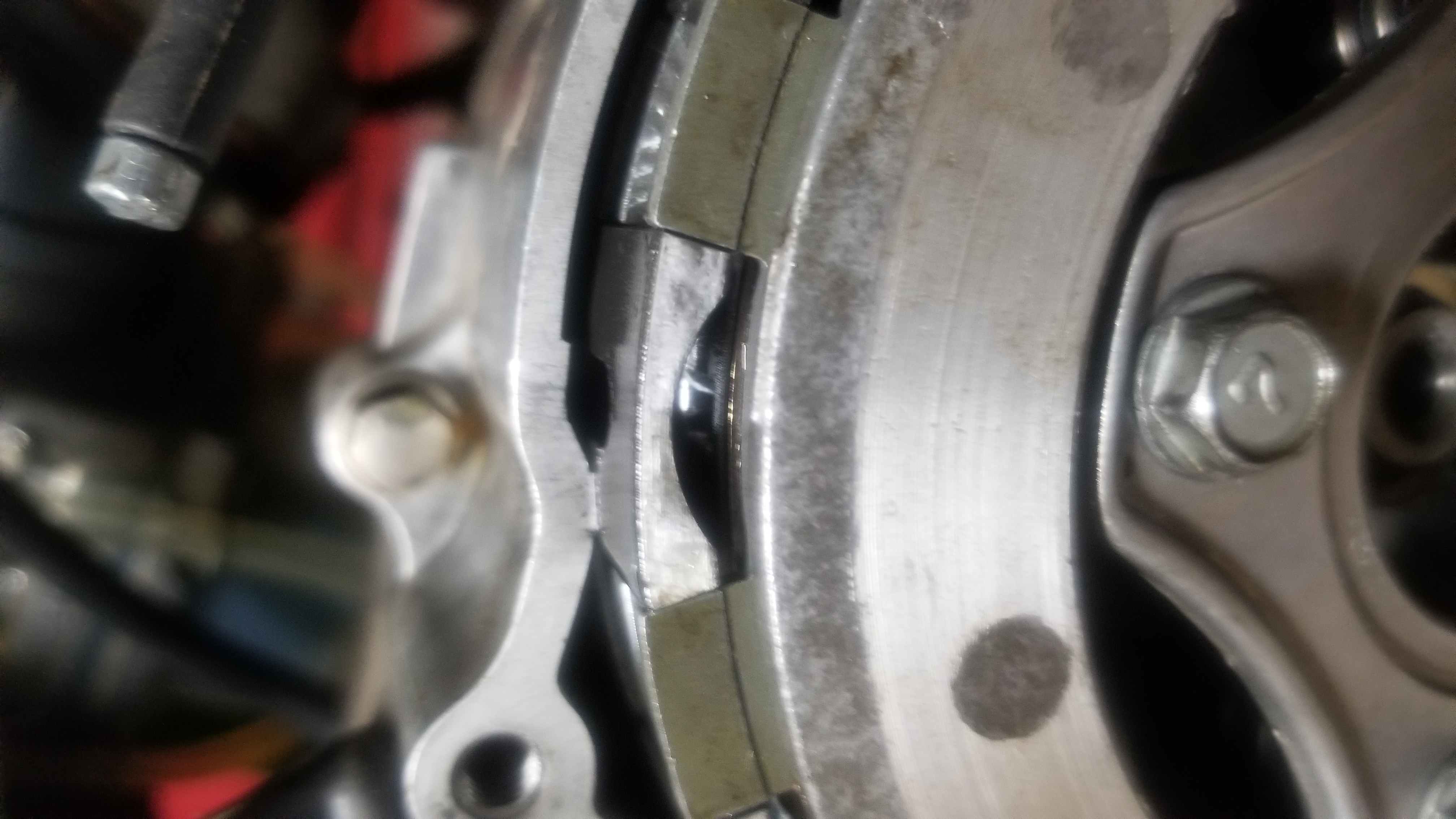

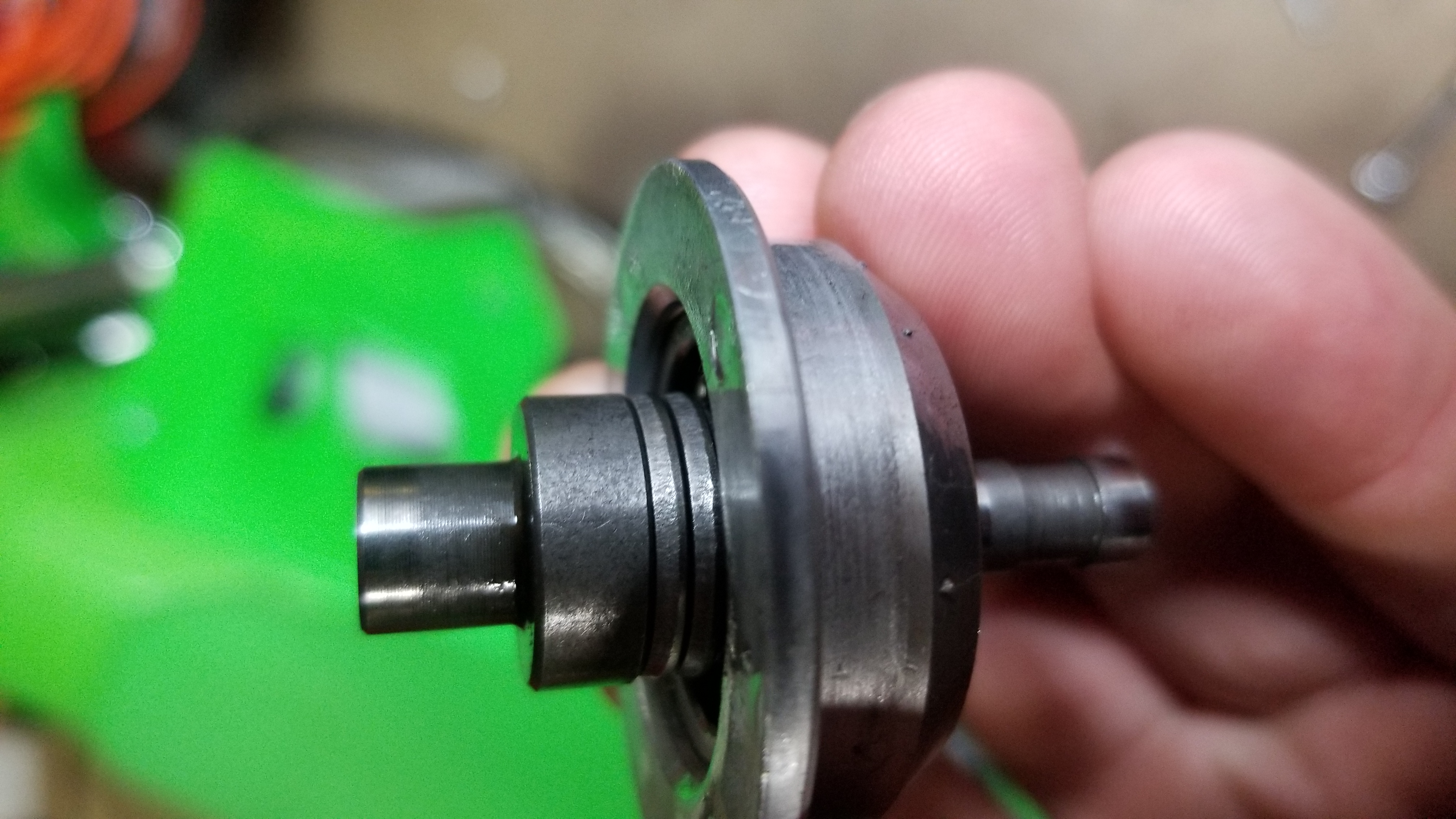

Well I got the clutch plunger spaced out the other evening and got a first attempt at adjustment in today. I'm fighting clutch slip at high RPM in 3rd gear and higher. 1st and 2nd also aren't as snappy as they were before. I'm sure I can correct most of this through dialing in the adjustment. I don't think stiffer clutch springs will help as stock ones held the power fine on my standard clutch.
That being said the setup does function fundamentally as it is supposed to. Nice easy starts from a dead stop on inclines and perfect power application for low speed technical maneuvering. Clutch lever still fully functional. I know all these things can be accomplished with a standard clutch but it's never been possible with the hands attached to my brain.

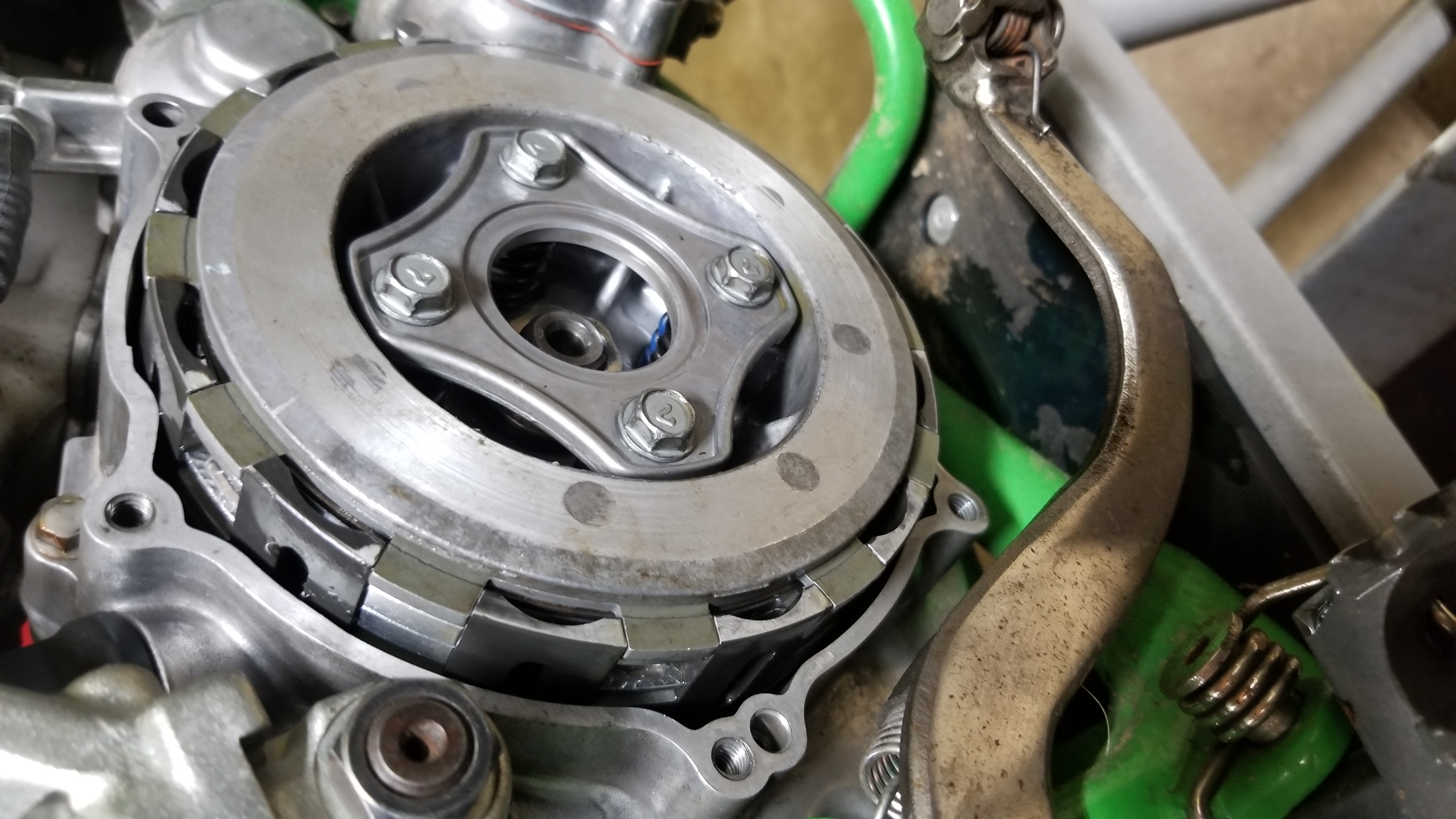

decluk13 wrote: 04:16 pm Feb 01 2021 There is a raised boss on the gear side of the YZ basket that will need to be machined down enough for the KDX gear bushing boss to reach through almost flush with the inside surface of the basket. This works out to around .070 material removed on this particular basket.
I had to have the same 0.070" inches removed when I went through this process a couple years ago. I also used a YZ125 basket with a KTM EXP disc and Honda 250F frictions and plates.

Don't know exactly why, but I always heard that the EXP disc could be placed anywhere in the stack other than first or last.

I got this tuned in as best I could tonight. Little grabby at idle but manageable by applying clutch during prolonged stops. It chuged along right up some steep loose bank gravel no problem. I may try some of the lighter weights to see if it corrects the idle grab. It holds the power in higher gears without slipping and it's back to lifting the wheel right through 3rd like before. Difference was about 1/2 turn in on the perch adjustment to get where I'm at.
I'll ride it for a while to see how I adjust my riding. If I don't like it I can always put the original back in as it is fully intact.

I have the rekluse disc installed as second from the outside with another steel and a friction between it and the fixed outer ring. No jutter spring installed as rekluse instructs their removal for all clutches.
