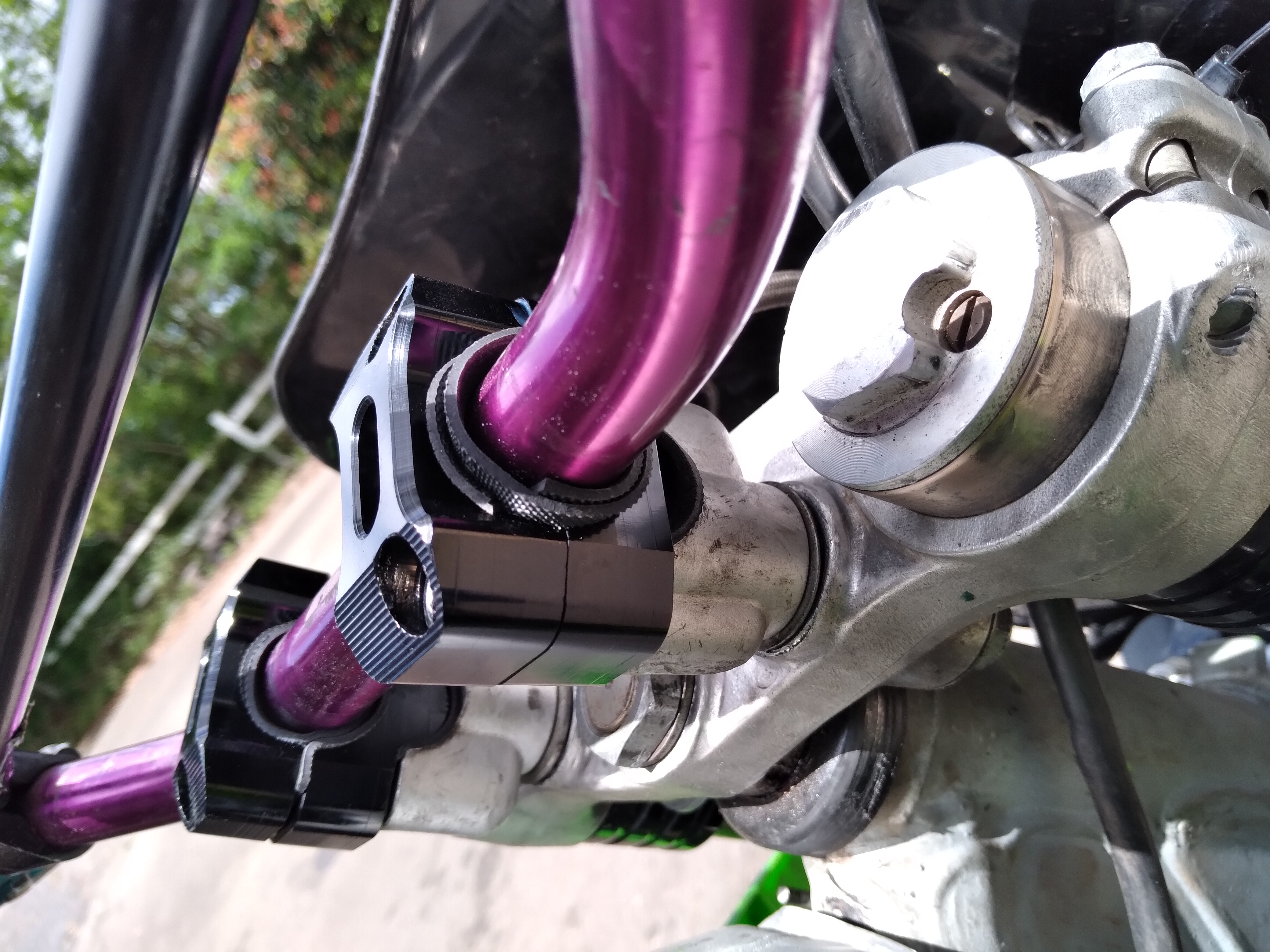

I have 1989 kdx200sr.
It has rubber mounts. The triple is off a kx and forks off a klx. I tried putting ebay bar risers for a fatbar and squishing strips of rubber in the gap difference and road bike bar ends which eliminates idle vibrations entirely, but when powerband comes on, the pegs and bars still rattle enough to make taking boots off a mission due to loss of grip strength.
