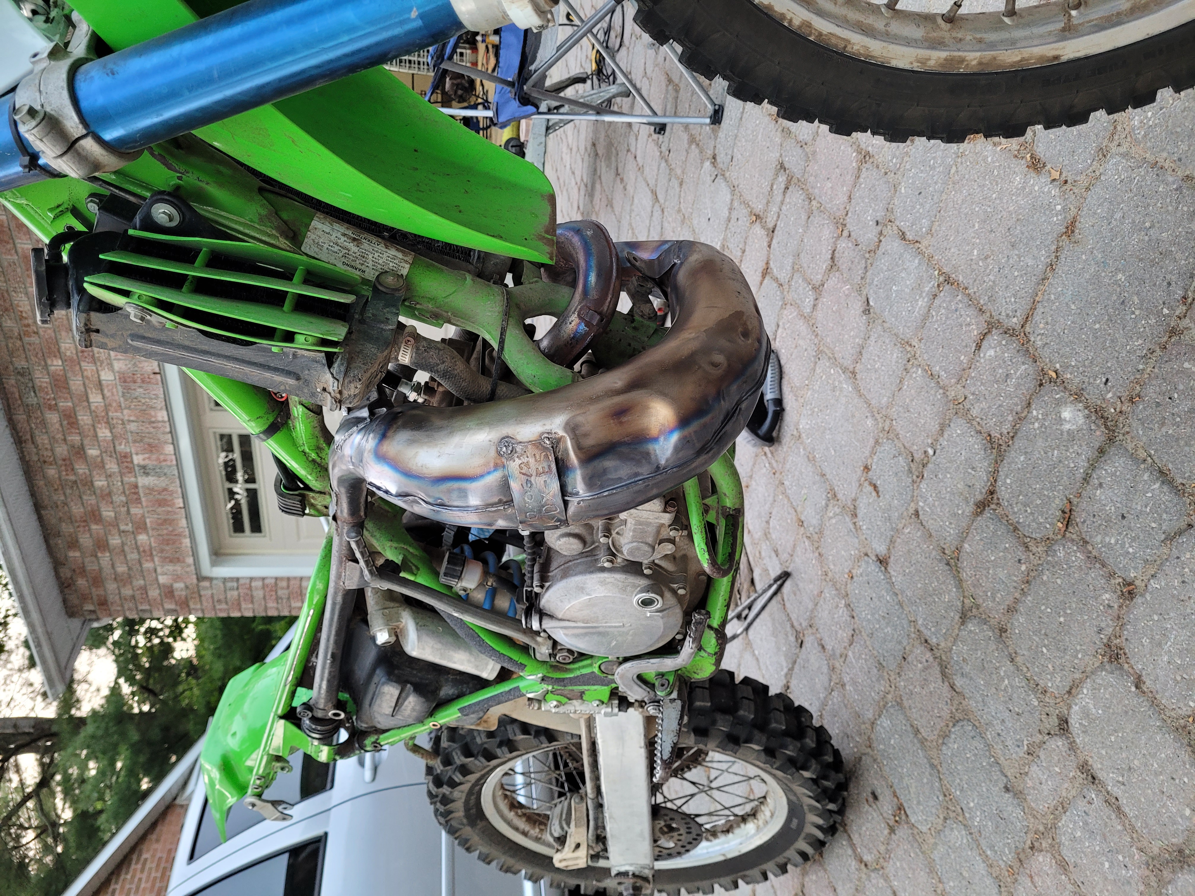

This is how my pipe turned out. Made a custom name plate as well. Still undecided if I want to redo the coloring or not because I wanted more of the blue coloring, but this is what it looks like.
Re: Stock header material?
Hey, not bad!

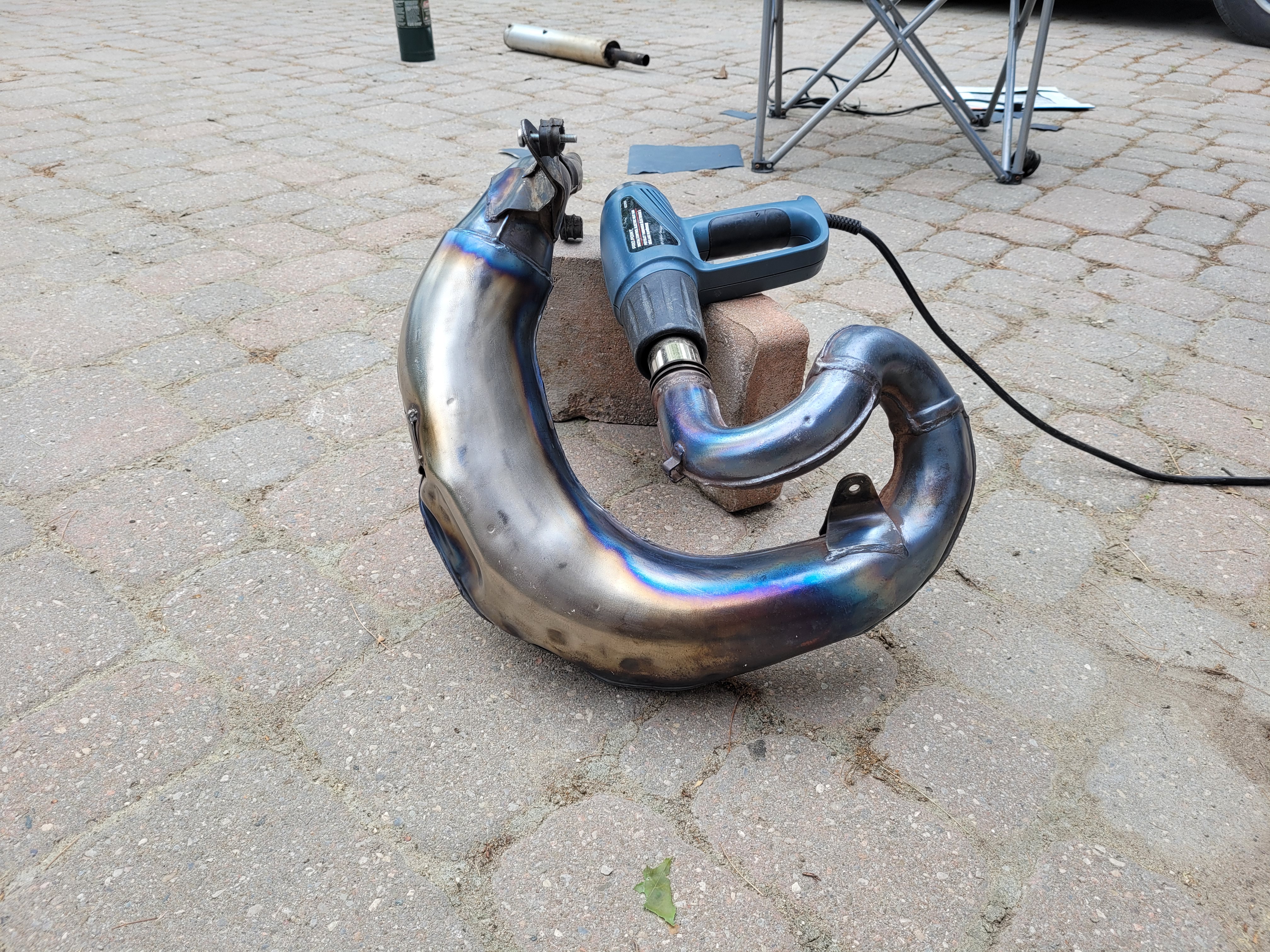

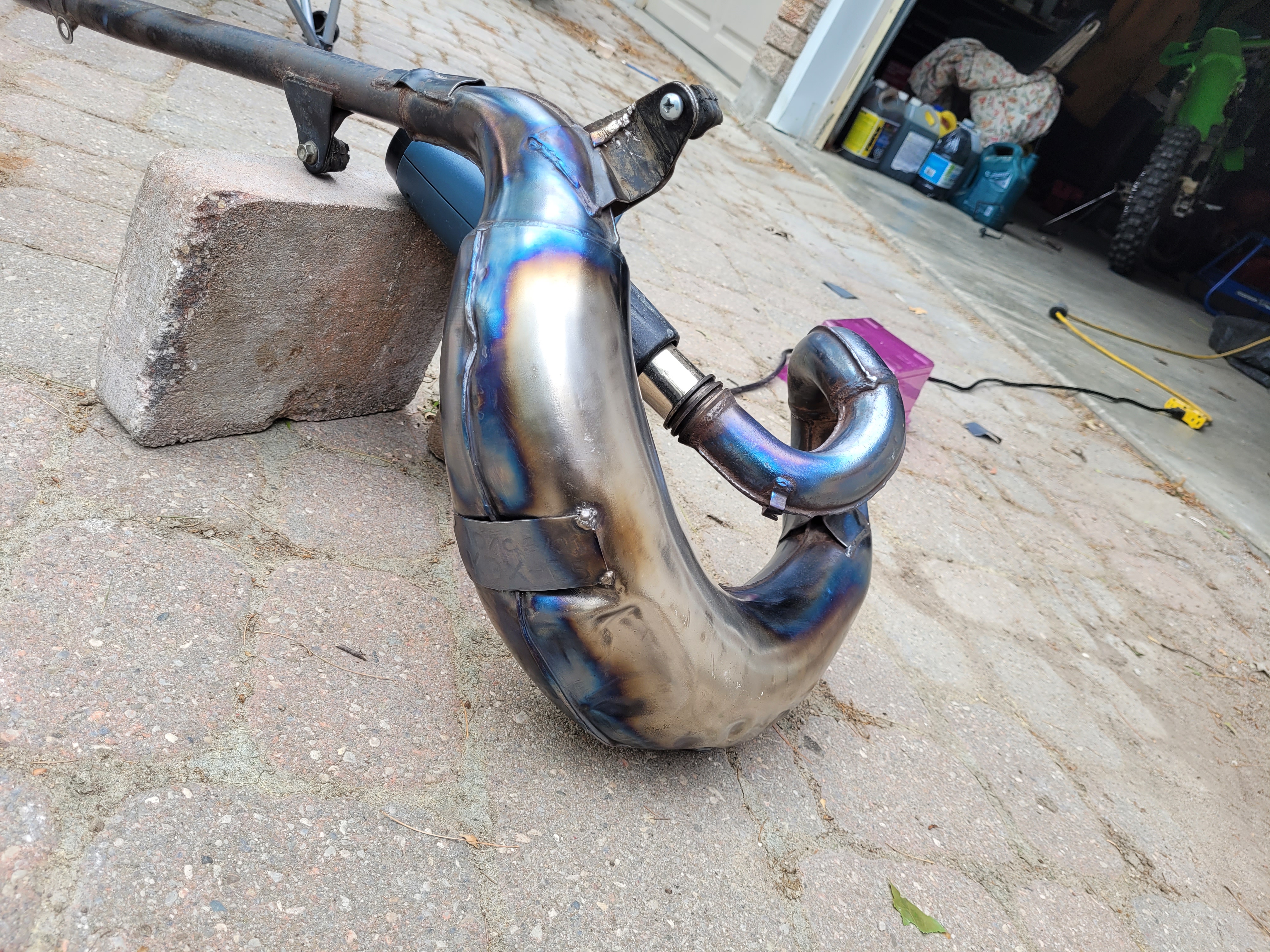

Redid the bluing. Turned out much better.
Posts: 6117
Looks almost like one of the factory racing pipes. How did you get it to blue?

SS109 wrote: 04:42 pm Jun 11 2021 Looks almost like one of the factory racing pipes. How did you get it to blue?
Yeah, that was the look I was trying to go for. I started by stripping the paint off, sanding the pipe starting at 100 grit up to 600. I got it to blue by using a propane torch along the pipe seams and welds. Also, to get that bluish purple on the section closer to the inlet, I let a heat gun run blowing through the inlet of the pipe. Also was able to burn out all of the baked up carbon that has been in there since 1993 🤣
Posts: 6117
Awesome. I was curious if it was just old school heat or you did some other kind of magic. Thanks for the info!
