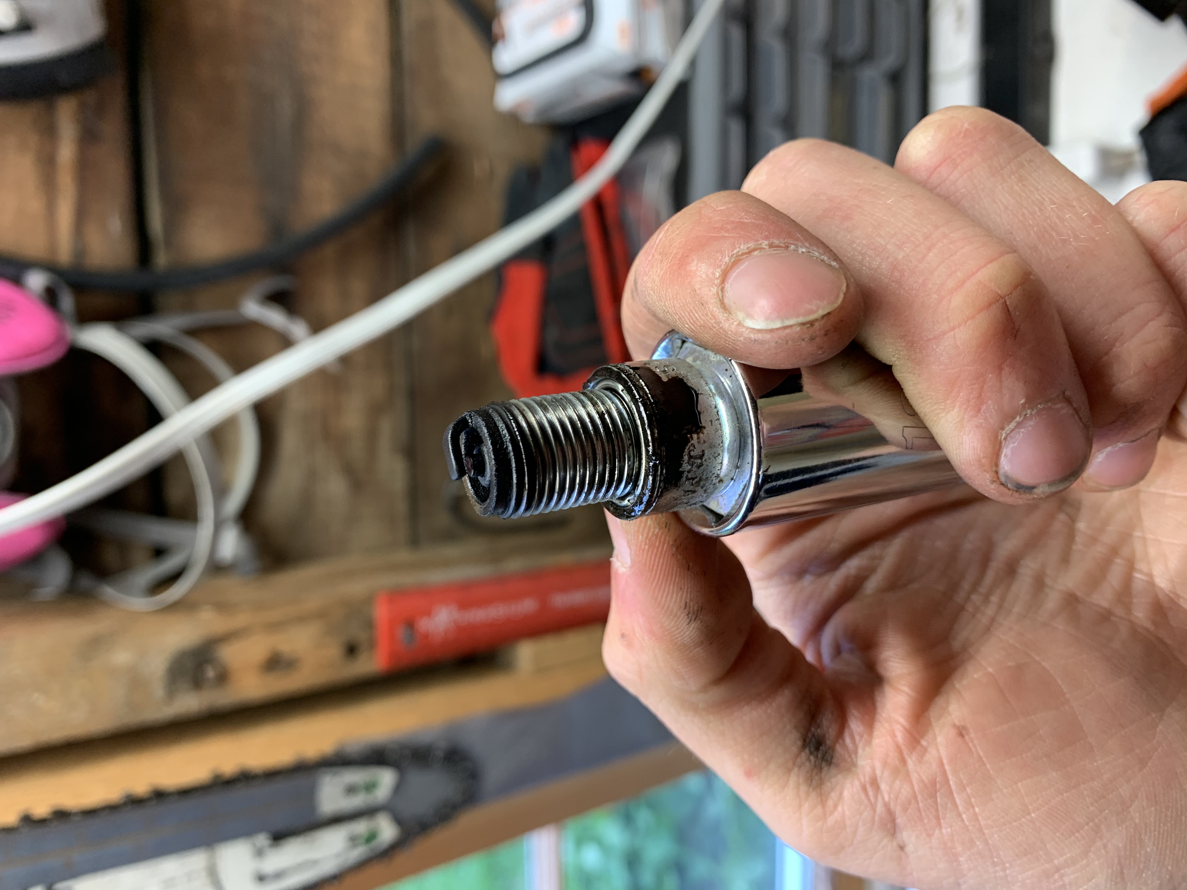

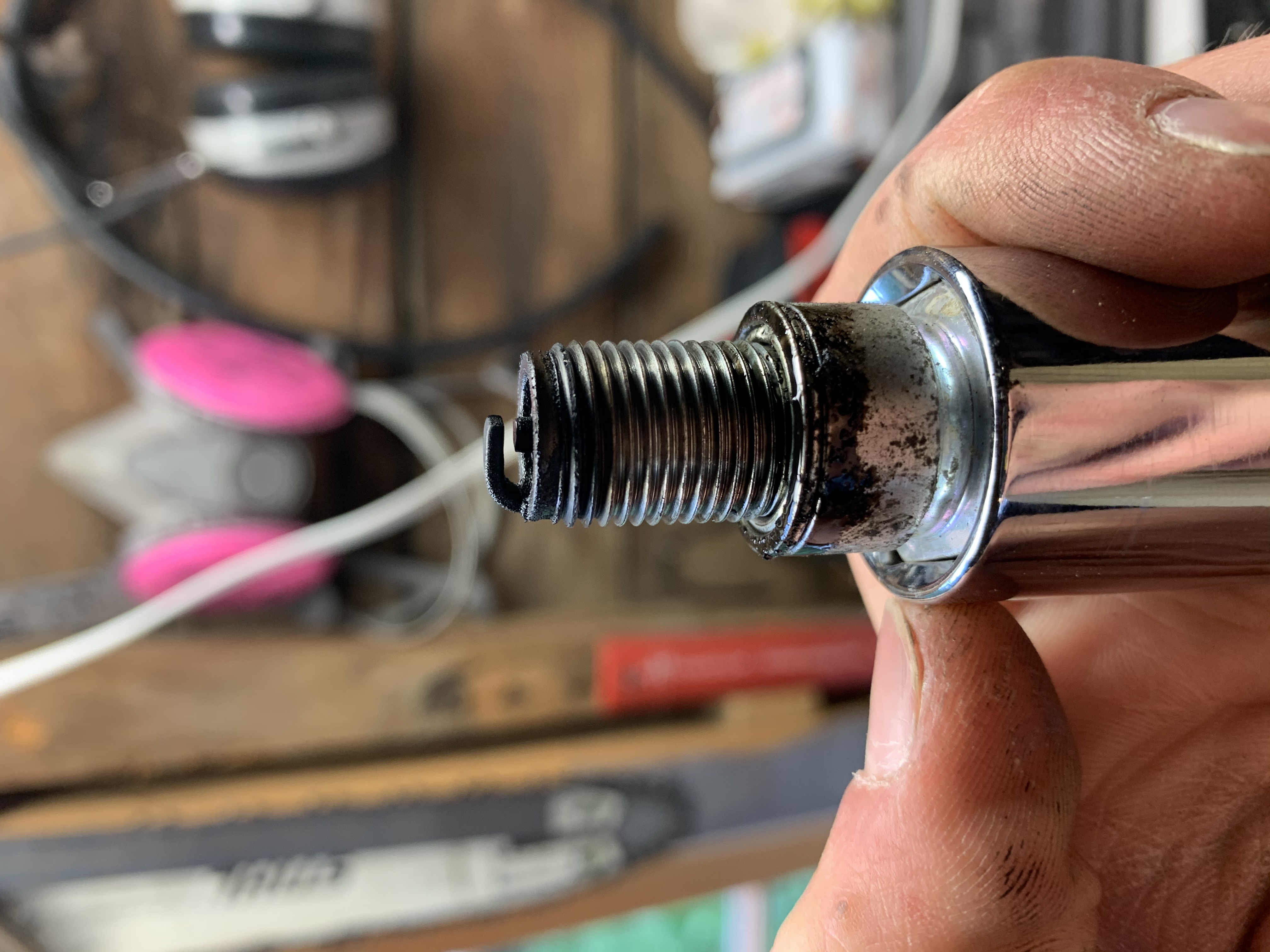

kickstart slip is still there unfortunately. Good news is i got the plug out. It was only finger tight.....
Some carbon built up but definitely not the worst ive seen.
ill put a new one in and properly tighten it. This one will get cleaned and put in the tool pouch in case i foul a plug on trail.

Not that I know of. I’ve never used those plugs but it’s probably fine. The question is how loose was your plug?
That could certainly contribute to your pinging issue if in fact it is pinging.
The plug you pulled out looks pretty carboned up. Gotta wonder if it could be worse in the chamber. What does your air filter look like?

Looking at the picture of the plug it looks like it was pretty loose. Either clean it or stick in a new plug and run it. That might solve your problem but you still need to look at your air filter. That could certainly be part of this puzzle.

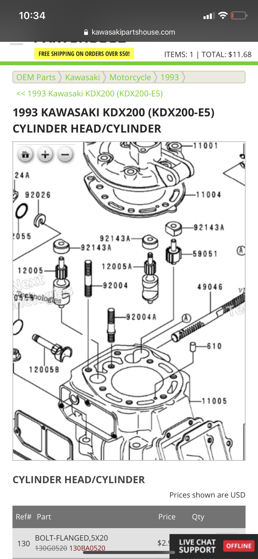

One of the bolts on the head seemed to be spitting a little oil as if theres a leak. the bolt directly in front of the plug. not surw what that bolt is as it doesnt seem like one thats holding the head on. maybe inspection port? going to pull the tank to get a better look when i have the time.

92004A in the diagram. i guess it is one of the head bolts...
front and center bolt

Are you sure that bolt wasn’t already dirty from the plug being loose? If you think it’s leaking just snug it down for now. If your antifreeze is clean and your oil isn’t milky you probably don’t have a head gasket or water pump seal problem. I’m not where I can look at my bike right now but I think the bolt you’re referring to might just be a plug that can be used to burp the cooling system. You’ll be doing that when you replace your radiator(s).
For now let’s see if your noise is gone. That plug looks like it was very loose. Your motor was blowing off some compression but more relevant is that it was sucking in unmetered air on the downstroke. That could very well be the culprit here.
