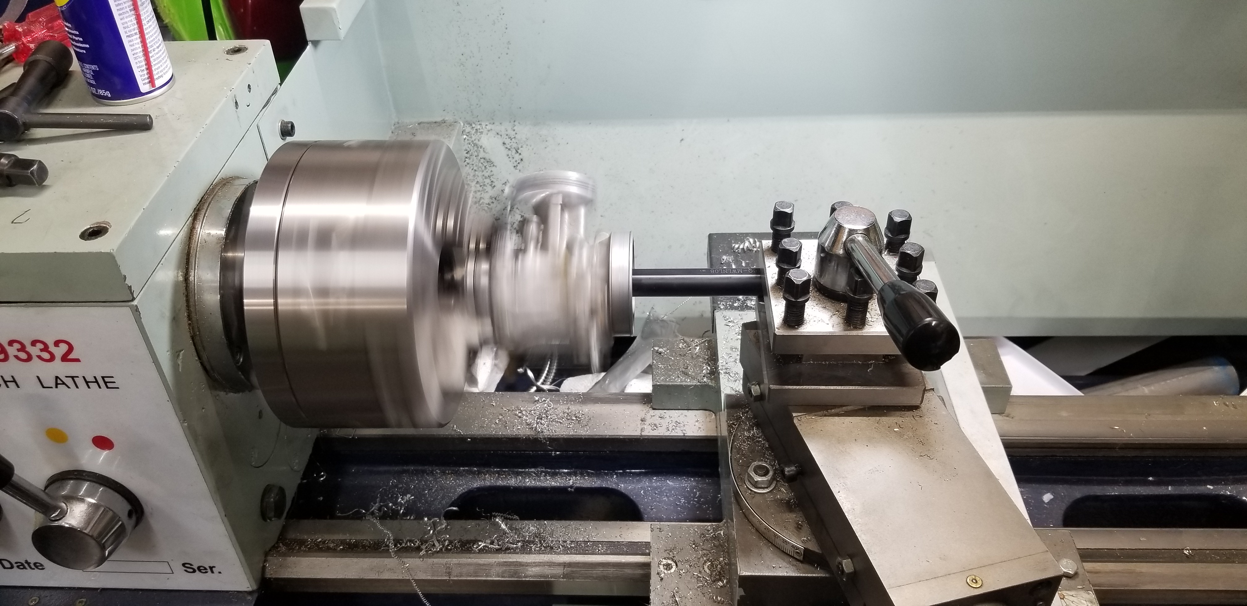

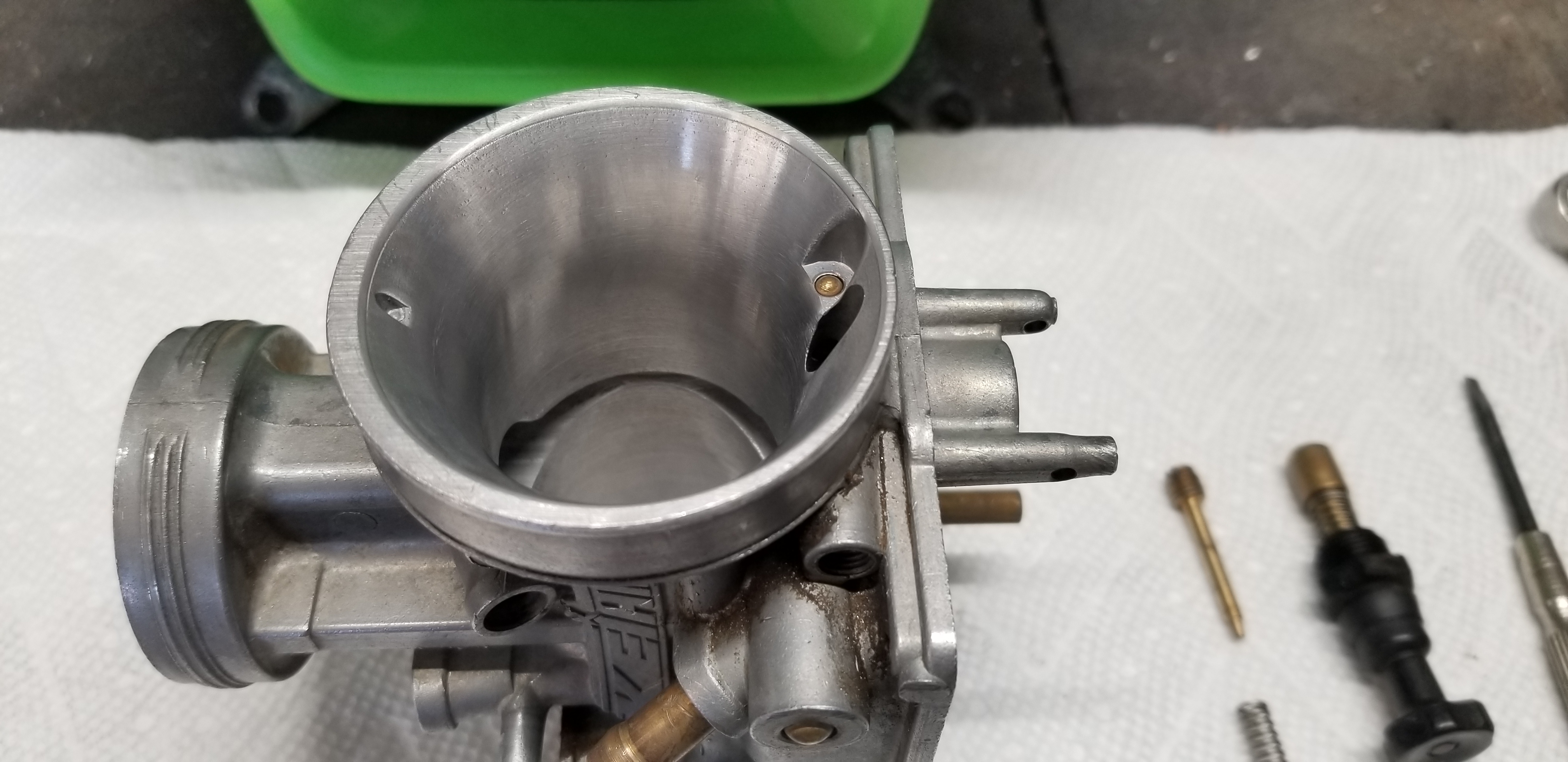

With Ron not doing OE carbs anymore and being semi retired I was wondering if anyone has some suggestions on how to modify the jet block and air screw passages.  I have already bored one of my carbs to 35.5 and may bore the second to 36.5.  Setting up to remachine the squish clearance as well.

Nice!
Welcome to kdxrider.net. Congratulations on being able to do that.

That's a lot of stickout! Did it wobble on you at all? I've had success with a boring head on a milling machine instead (if you're so equipped.)

Slick_Nick wrote: 08:47 am May 11 2021 That's a lot of stickout!
The boring bar is only about .500" longer than the carb throat so I have to be careful to stop the feed of the carriage in time. I had just started cutting. It did cut pretty nice. I give it an 9 out of 10.

Hey Shane. That is badass! Thx for posting.
