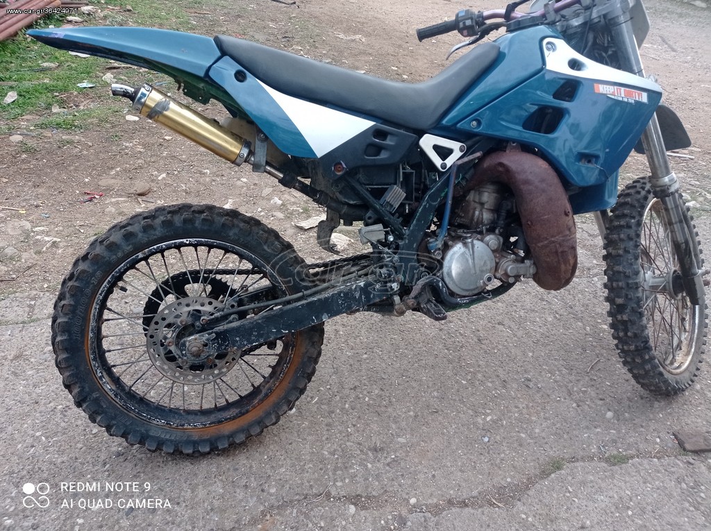

Greetings guys I’m interested into this ad https://www.car.gr/classifieds/bikes/vi ... ki-kdx-200
It’s like Craigslist but in Greece. This bike is sold 450 and the owner claims this is a ‘00 model, but I see the radiators reserve cup at the back which looks like an 89 model, I asked him to give me the frame number but he doesn’t seem eager to pass this info away..
Do you think it might be stolen and what model would you believe this bike to be?
I can take it at 380 euros around 330 dollars , I believe it can be a bargain
Should I buy this?

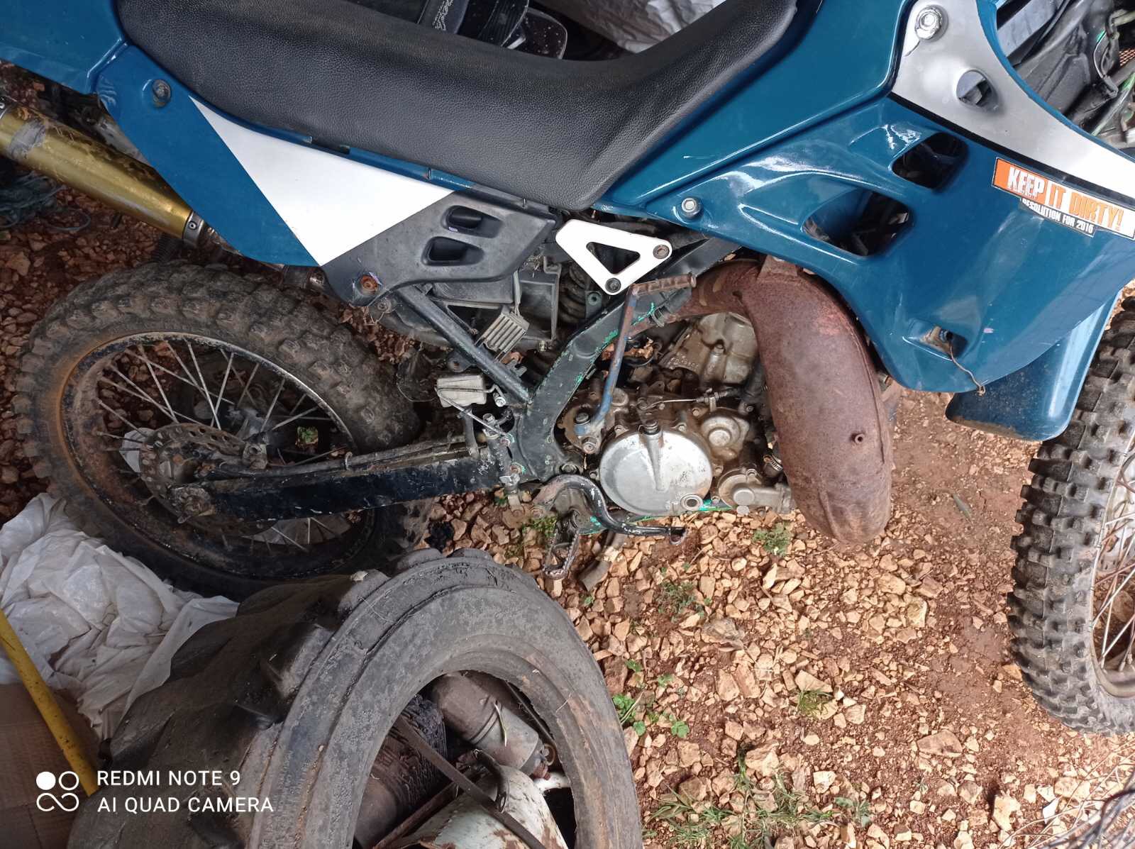

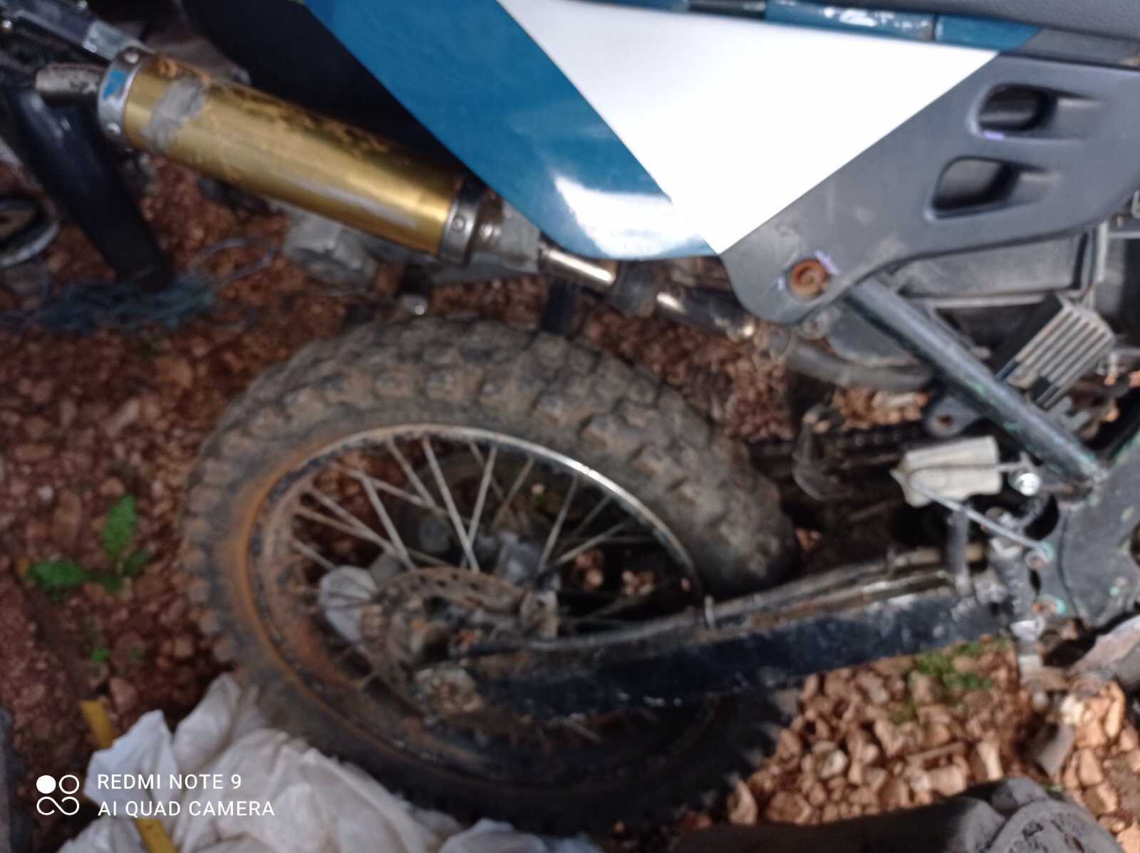

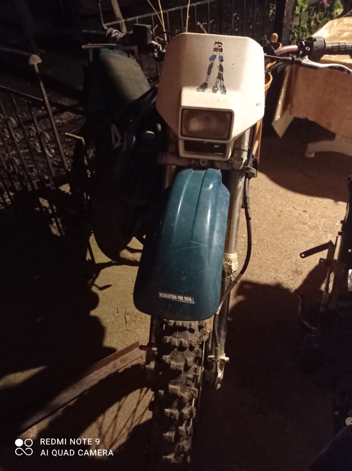

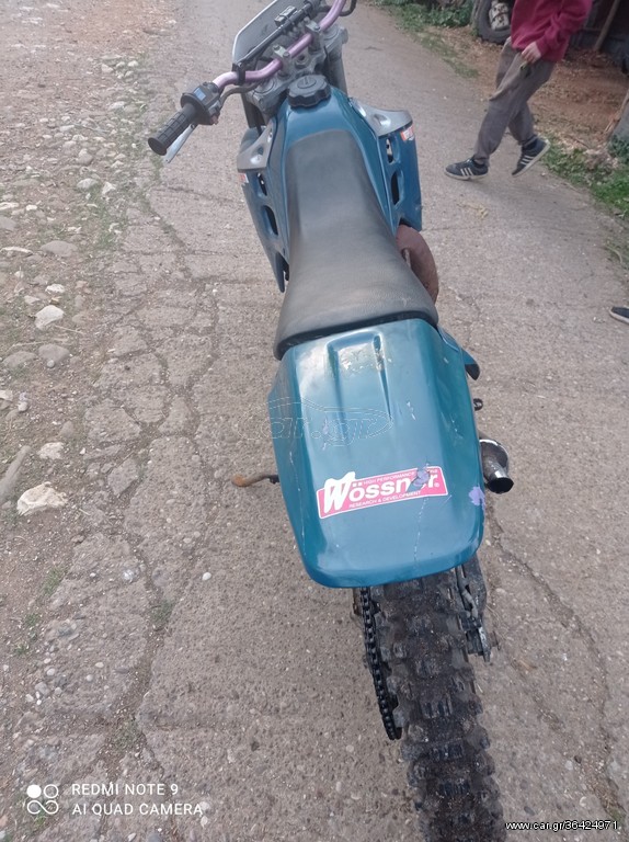

Some other pics the guy sent me also I watched couple of videos the bike sounds decent and idles ok

Frankenbike?
Is it a Chinese made bike?
I'd have to pass.
I'd have to pass.

Thank you for the answer KDXgarage! I know it’s ugly but the thing that alerts me is that he doesn’t tell me the frame number so maybe I should pass too...cheers man!

DX200g-021318 the frame number finally, and the funny thing is that the owner claims this is a ‘00 bike!

It may be a KDX125, which is a model they didn't sell in the USA.
It looks like it is missing a few parts and several have been modified or are just wrong (kickstarter, side panel, etc.)
Do you see how the kickstarter is not lined up properly?
Do you see how the pipe does not fit properly?
If you are buying it to use as a parts bike for your current KDX200, then not many may work. If you want to buy it to have it as a KDX125, then you have two old bikes that are hard to find parts for cheap.

Thanks a lot for the advice KDXgarage !!! You saved me from a lot of trouble, in the beginning I thought I’d buy an H Model in good price, then I thought to use it for parts for my G bike, whatever the case it would be a bad choice.KDXGarage wrote: 05:37 pm Apr 04 2021 It may be a KDX125, which is a model they didn't sell in the USA.
