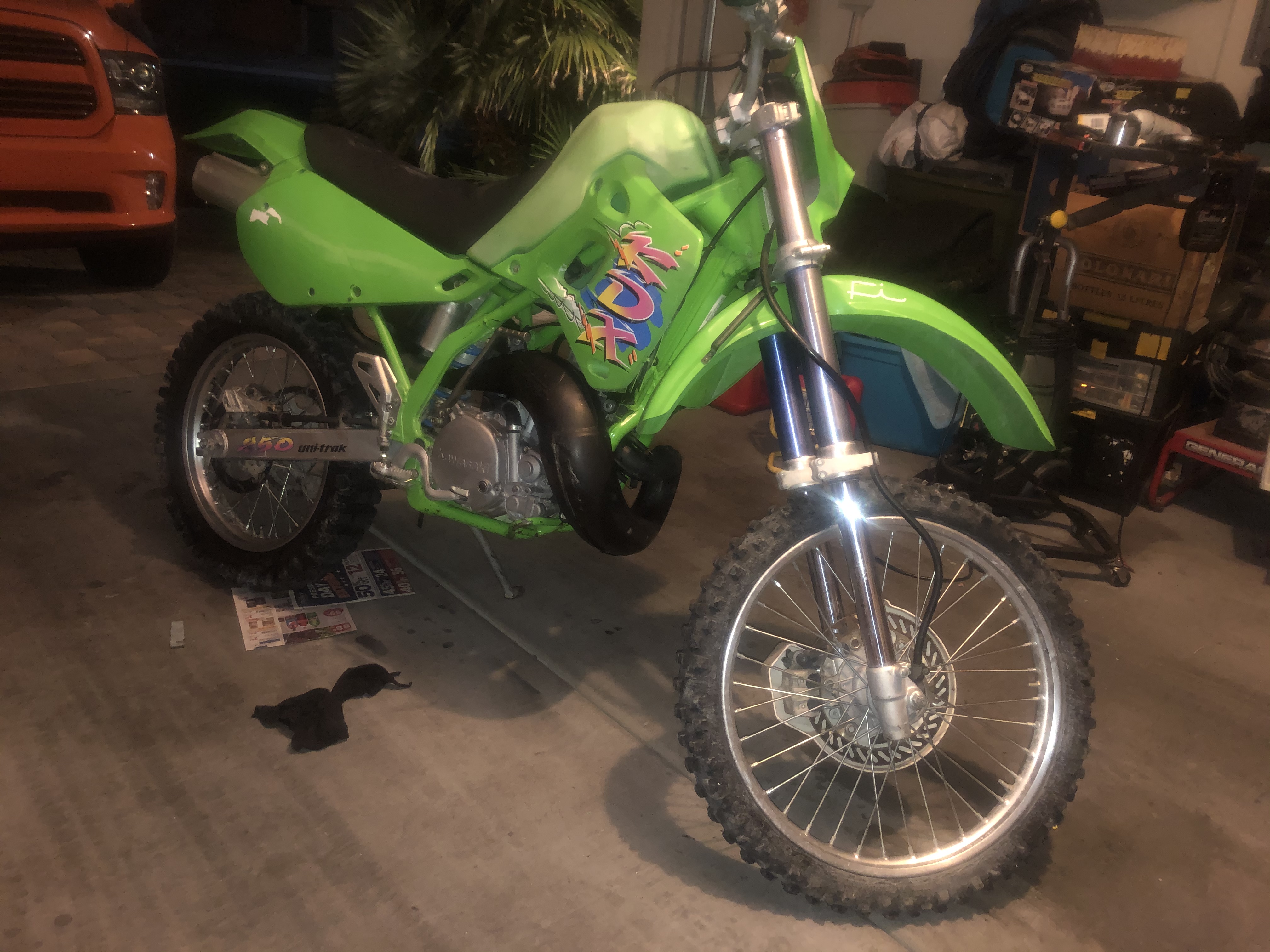

As you can see by the picture. This KDX 250 is almost perfect except someone changed the stock gas tank and replaced it with this Behemoth of a tank. And it’s the wrong color and sun faded.
I hate the look of the gas tank on the bike. I do like the stock tank look and the new after market tank with build in fins. I want to return this bike to stock or change the gas tank totally with a different year. But after some research nothing will fit.

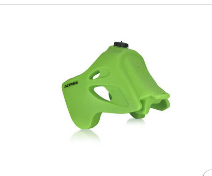

So my question is can I put a aftermarket KLX gas tank on this frame. I’ve seen it done but don’t know what they did to do it. In my pictures I added a picture of a aftermarket gas tank I would like to put on it. But it says it’s only for KLX. Not KDX.
Looking at a KLX frame and the KDX frame from a quick glance they look so similar, the frame on a KLX looks so close to the KDX that I figured the gas tank would fit even though it was not specifically made for this bike. Now it doesn’t have to fit perfect because the tank on it now fits and bolts up perfect but the Radiator fins do not fit perfect. Their close but still you can tell it’s not the stock tank that came on the bike.

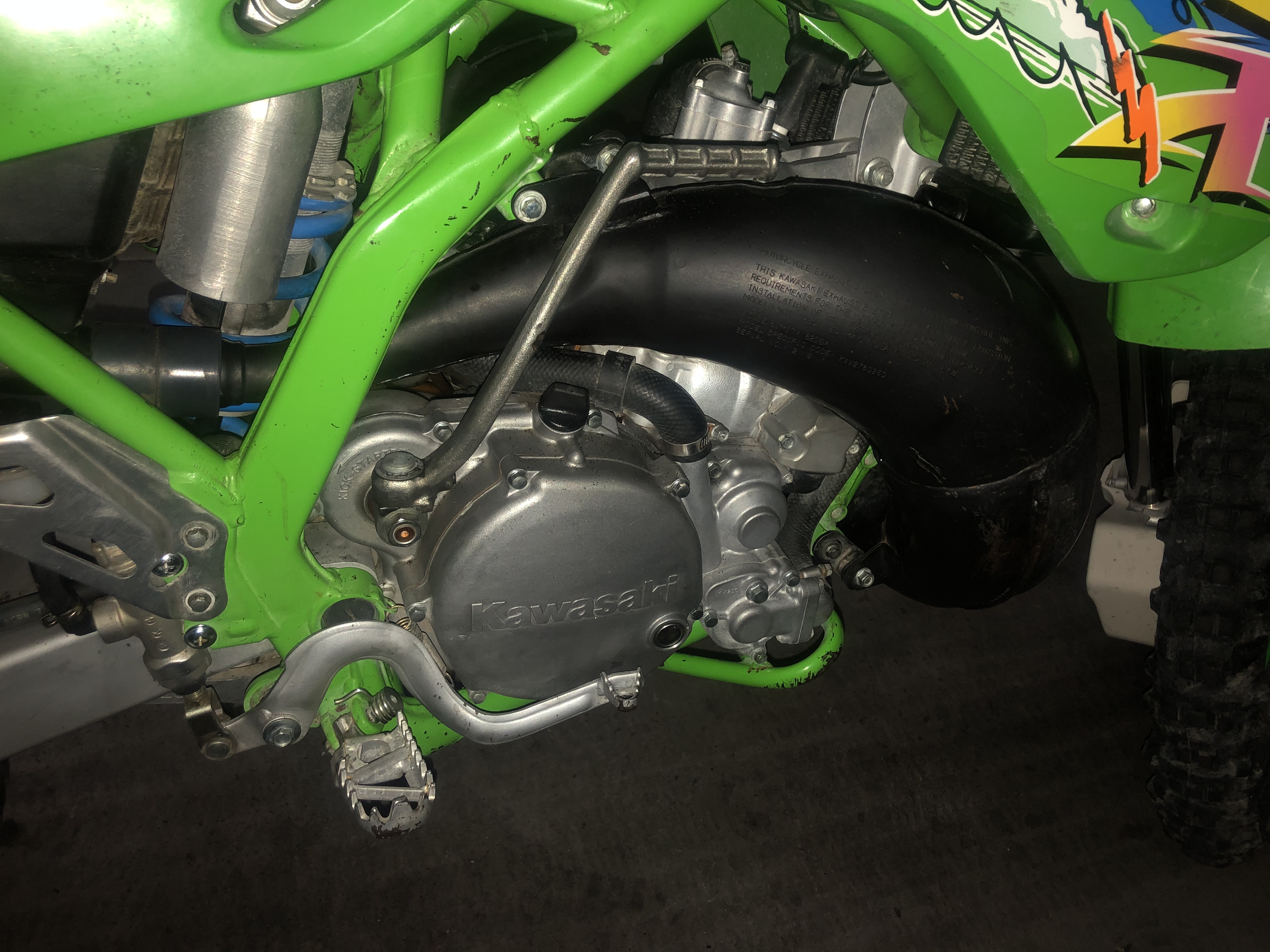

- Paint on the frame is perfect.
- 1D08CDF2-6D73-4CBE-906F-A871B5467D14.jpeg (2.58 MiB) Viewed 30410 times
- KLX Winged Gas Tank.
- F8C06643-7428-4A6A-B5DC-1C661B6C490E.jpeg (82.5 KiB) Viewed 30410 times
- 1993 KDX 250 / 740 miles.
- 3D4AAF27-93F6-4B94-B70D-D020AE815D9A.jpeg (2.44 MiB) Viewed 30410 times

Looks to have an old Clarke or IMS large capacity tank on it. You can sand it down and polish it and get the color to come back, just takes time and patience. For desert riding on a 2 stroke that big tank is the ticket, IIWM I wouldn't change it. Does need fork slider protectors. May be the picture, but it looks like the anodizing on the right fork leg is faded? That is a pretty great find of a bike, the 250s were great rides. Unfortunately parts have become pretty hard to come by.
As for other tanks that may fit, the KLX one may work, at least be close, you might have better luck with an H series tank (97-06 200/220). Might have to fiddle around a bit with the mounts to get it all lined up, but should be close.
