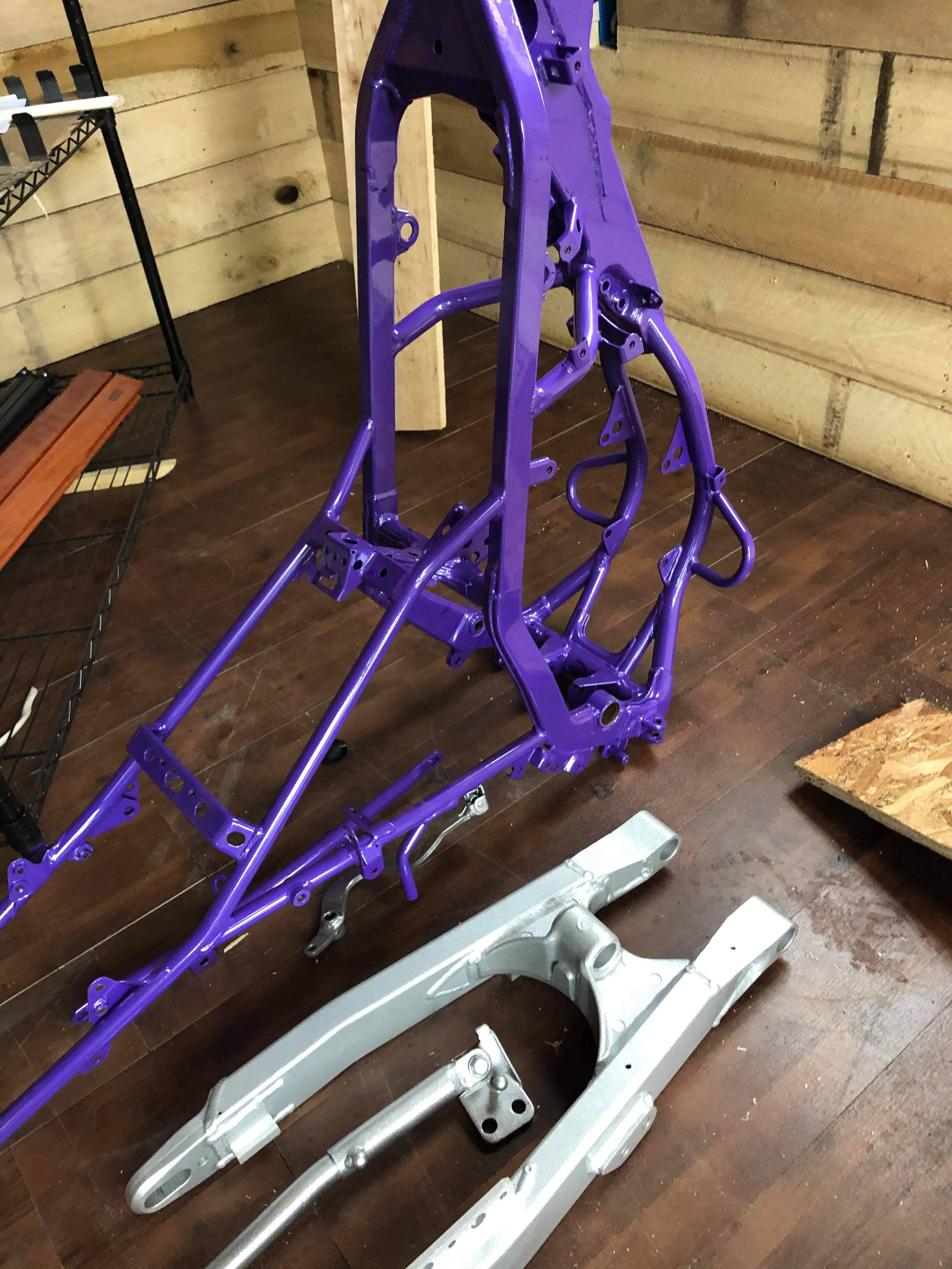

Hey guys working on revamping my 04 200. Just got the frame powder coated and now I am looking for a good skid plate option that protects the frame and motor. Any recommendations?

That is going to look outstanding! Can't wait to see the rest of the bike come together.

That purple frame is giving me ideas for my KDX!
I thought about starting to make skid/glide plates with and without linkage protection for the KDX. I just don't know if enough people would buy them for it to be worth me to investing the cash in doing it.

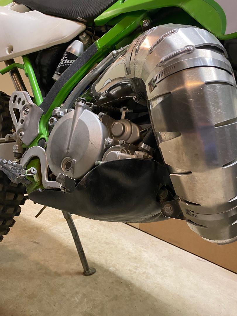

I have the Hyde skid plate and like the way it fits tight to the frame, protects well, and slides over obstacles. I bought mine through BRP Moto KDX Skid Plate

I would buy two of those skid plates that protected the linkage. The Hyde skid plates are cool but don't protect the linkage and the one with the pipe guard comes up too short on the left side bend. I'd end up adding add a few inches of the aluminum pipe guard material to extend the protection on each end. Hyde wants too $ much for skid/pipe guard. I might get it anyway. That purple coated frame looks better I could have imagined. I have a 97 220 with the purple tank. I like the black tanks, but now seeing that purple frame could change everything. The '97 was a race bike and likes to go crazy fast so maybe the wild purple look should be played up.SS109 wrote: 12:25 am Feb 11 2021 That purple frame is giving me ideas for my KDX!

Nice looking frame! Great color.

WOW. That purple looks amazing. Do you know the color code for it? Also was that oem purple KAW used? Thanks.

I have a Devol aluminum skid plate and a Devol water pump protector plate. Years ago when first armoring my KDX out, the water pump guard was a separate purchase. Now after rebuilding, frame up, I wasn't able to locate anything like the Hyde and the reps logic, via my local Kaw dealer in Rome,Ga., was that the frames loops/extensions acted as a case protector. Point being that the water pump guard came in package with the Devol bash/ skid plate.
I have been fortunate in that my current armor does an incredible job but that Hyde plate looks cool as all get out. I've been leary of plastics ability to continue protecting after the integrity is compromised from an uber hard hit but evidently it keeps on keeping on. I know my bash plates get bent and all and still do the job but that Hyde looks great.
Just remember to guard the water pump man. Period. It's critical if you actually do mix it up racing or even hard trail riding. I've seen many over the years get cracked/ broken from not being covered well enough.

It's not the OEM purple. I went with Prismatic Powders Galaxy Purple. Its got some silver metal flake and then I went with a clear coat over top to make it really pop.TwistedRoot wrote: 10:50 am Feb 17 2021 WOW. That purple looks amazing. Do you know the color code for it? Also was that oem purple KAW used? Thanks.
