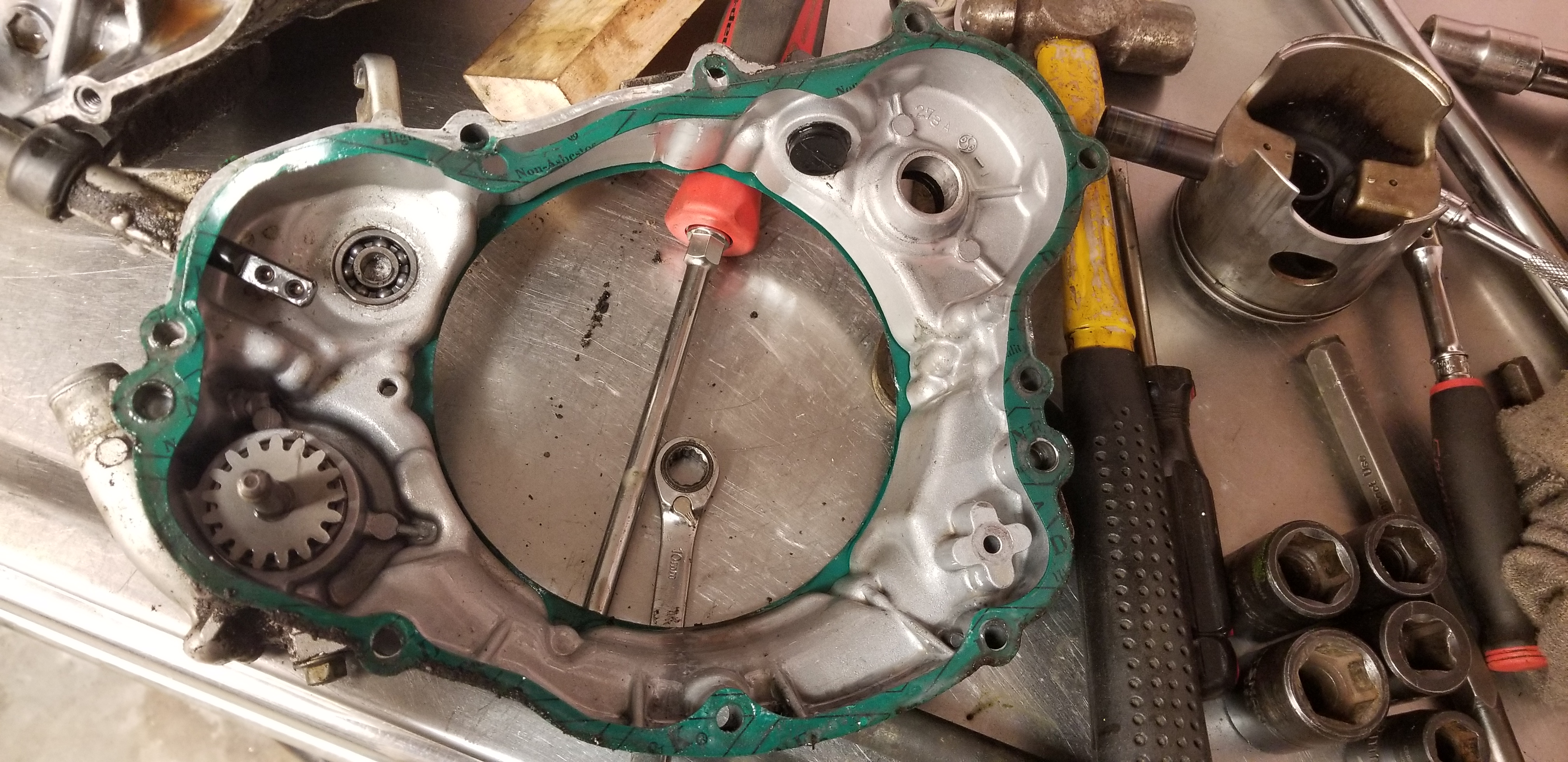

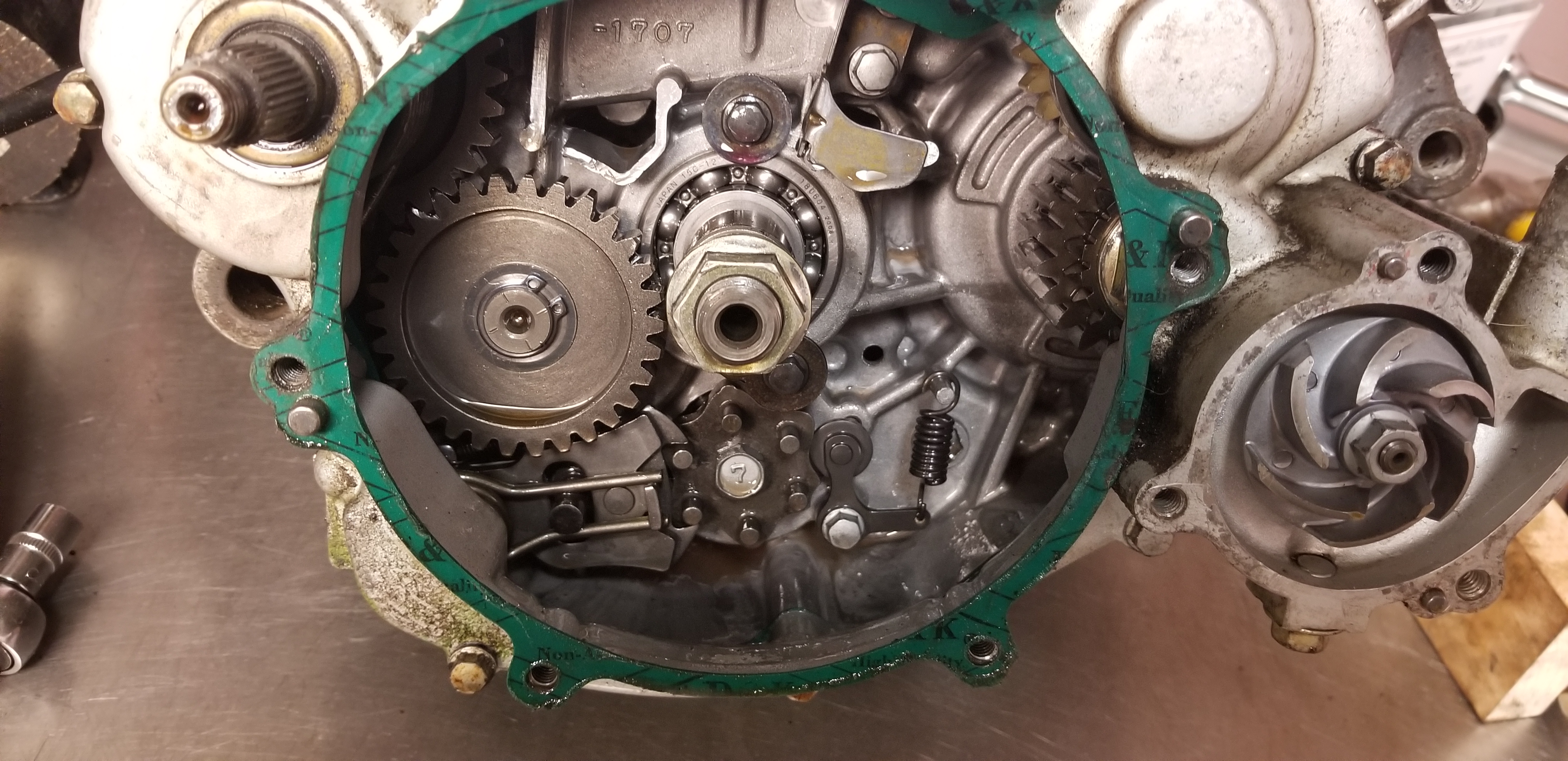

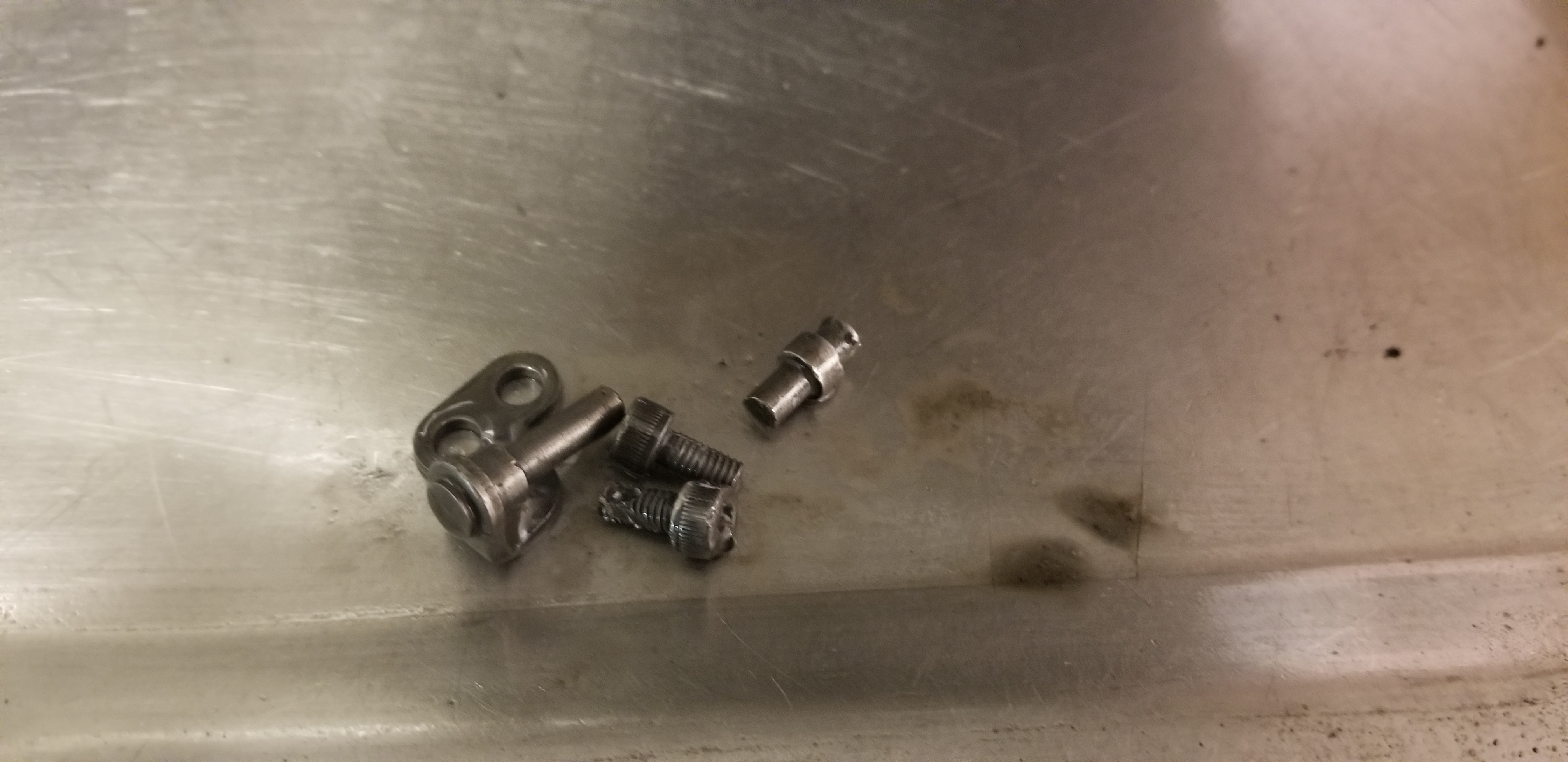

I finally got around to tearing down the KDX. Not good. After grinding the welds off the kick starter that was welded on to the shaft by one of the previous owners, I found a few "spare parts" in the case. Looks like part of the KIPS system. I have not got the rest of the cases split but after seeing this plus all of the other issues with this bike, not sure it's worth it for me to keep going. So far It needs re-plate, piston kit, kick start parts (for slipping half stroke). The pics are how it came apart.

Was the KIPS pin loose and floating around?

@KDXGarage, yes the KIPS shaft wasn't doing anything - 2 empty bolt holes. I could rotate the shaft and actuate the valves in the cylinder.
