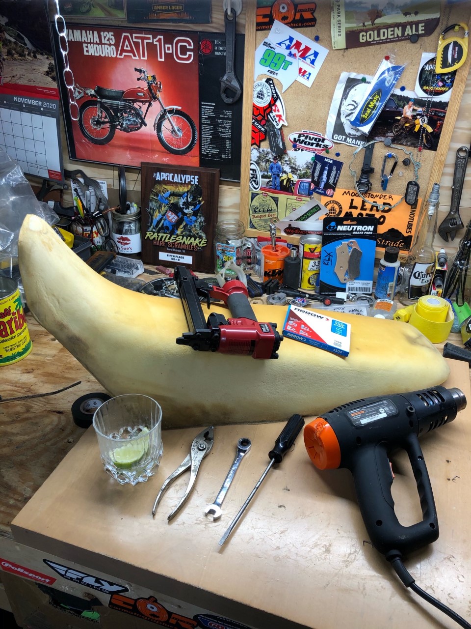

The old foam and the tools I used.
After carefully pulling the multitude of staples with a small flat head screwdriver I shook it out. I also pulled the metal rear mounts and the rubber feet from the seat pan to get better access to the plastic form when I re-stapled. I pulled off the old foam, and swapped in the new one. BIG difference!!! I flipped on my air compressor and hooked up my new Arrow T50 air-staple gun with T50 1/4" staples. Then after warming up the cover with my heat gun till it was feeling nice and pliable, I just followed Jeff's very detailed instructions:
"Center seat cover side to side. Stretch front to back and staple front and back. Then work each side in the center and stretch and staple. Then just work it down and staple the rest."

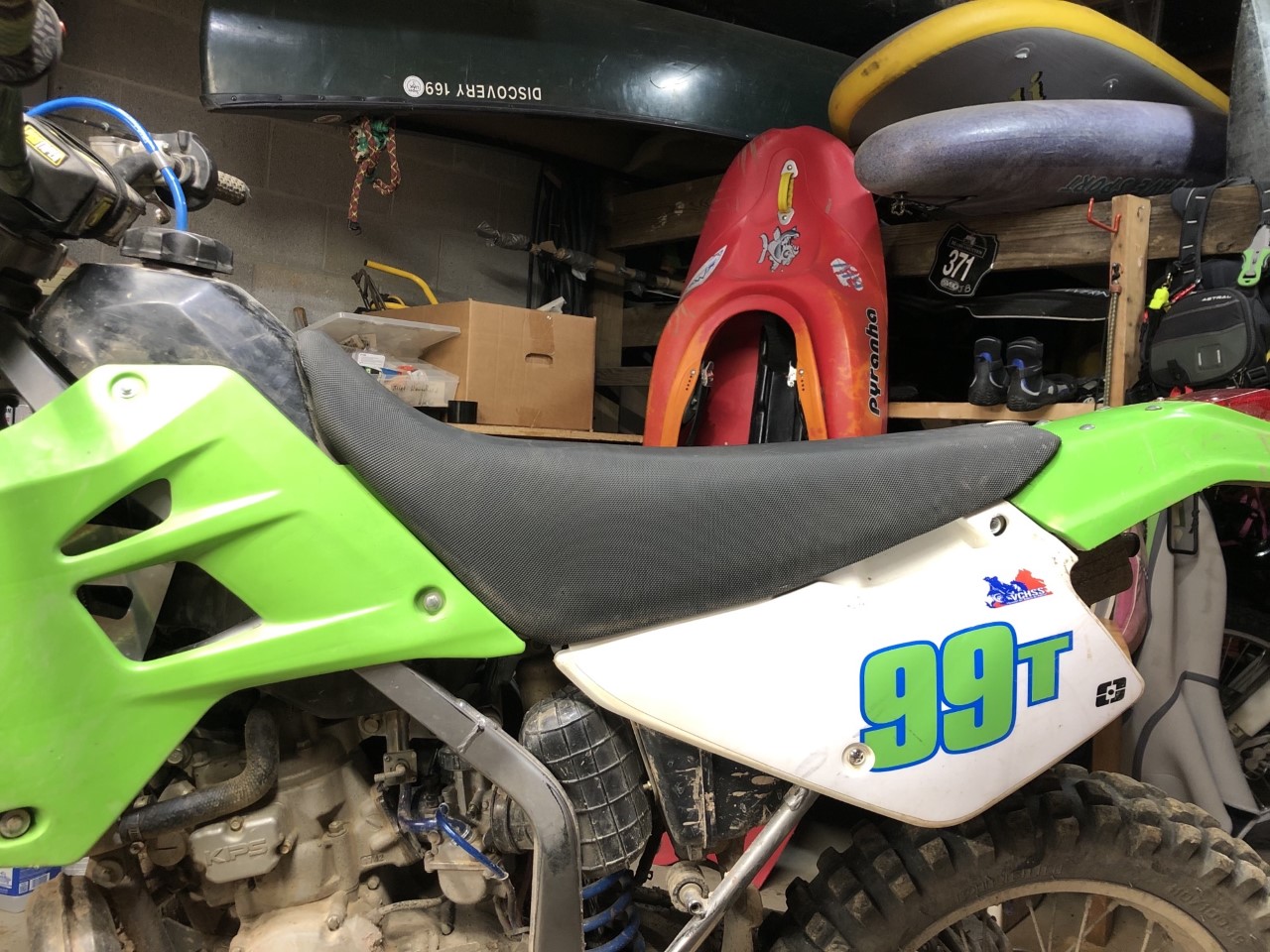

First attempt

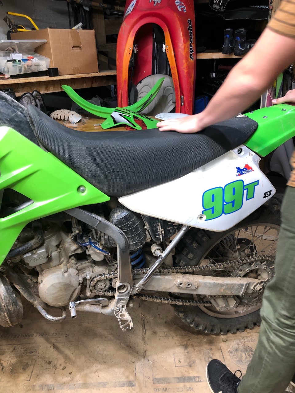

My first crack at fitting the seat went pretty well, but I noticed the nose of the seat seemed a bit high and away from the tank. Seemed like I could do a bit better there so I pulled her off and removed the front staples at the nose. I made sure the lip of the foam was pulled down evenly over the plastic pan nose (it actually wasn't somehow), then I heated up the cover a bit and re-pulled and and carefully re-stapled. This worked and when I refit the seat all looked perfect...
For $40 in additional tools, that I've now used twice (put a new cover on my son's KTM last week) and $65 plus shipping I have a really nice racing seat for my KDX. It was manufactured by CEET by the way. It feels so much more legit than the old foam, which really was too dang soft. I prefer to stand when I ride and all that additional effort needed to stand on this bike was making my old battered knees sore. Like the next day I would be really stiff in the joints which I'm not used too. I noticed this never happened after riding just the KTM. Can't wait to test this baby out and give her a review!

The weather improved during the day while I was at work so when I got off I hustled home to take advantage of the remaining 15 minutes of light. I ended up riding for better than 30 minutes (thanks KDX headlight!) and got a good feel for the new seat. I came away very impressed. First off I'm 5'9" and even with the taller seat can still touch the balls of my feet to the ground when standing over the bike on the flat. With the old seat my heels were solidly on the ground.
Getting on the bike it feels like you are climbing on a KTM. You are sitting 'on' the bike, not 'in' it. The improvement in seated riding position alone was appreciated. The higher seat combined with the additional firmness instantly changes the angle of attack from your elbows to the grips. This made it a LOT EASIER to keep your elbows up which makes the bike turn much better.
