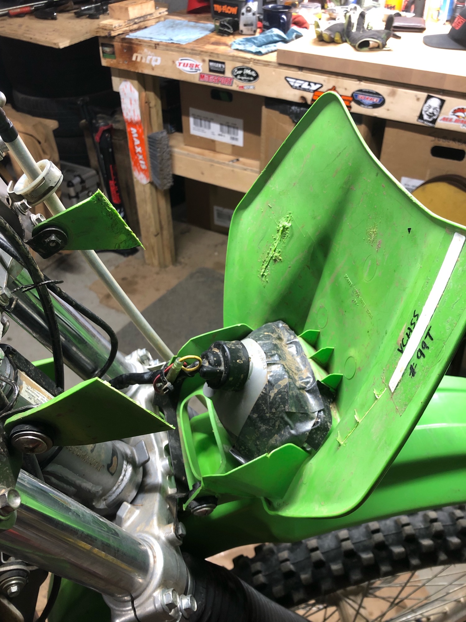

Like many folks out there, I've had cracked plastic over the years that I tried to repair with epoxy, super glue, wire - you name it. Nothing really did the job or ended up looking decent. We either had to live with a shoddy fix, a broken piece, or shell out the big bucks for a replacement. Recently I found the motivation to look for a better way. This past spring I found that my old push mower had a cracked plastic fuel tank. Pour gas in and gas would pour out. Now, the last thing I want to do is spend my dirt bike money on a stinkin' lawn mower!!!! The tank for that machine was $70 plus shipping everywhere I looked. So with a little research on youTube it was discovered that somebody had figured out how to 'weld' broken plastic. I set to work. Took a couple tries, but I learned some things by doing it.
A couple keys to remember:

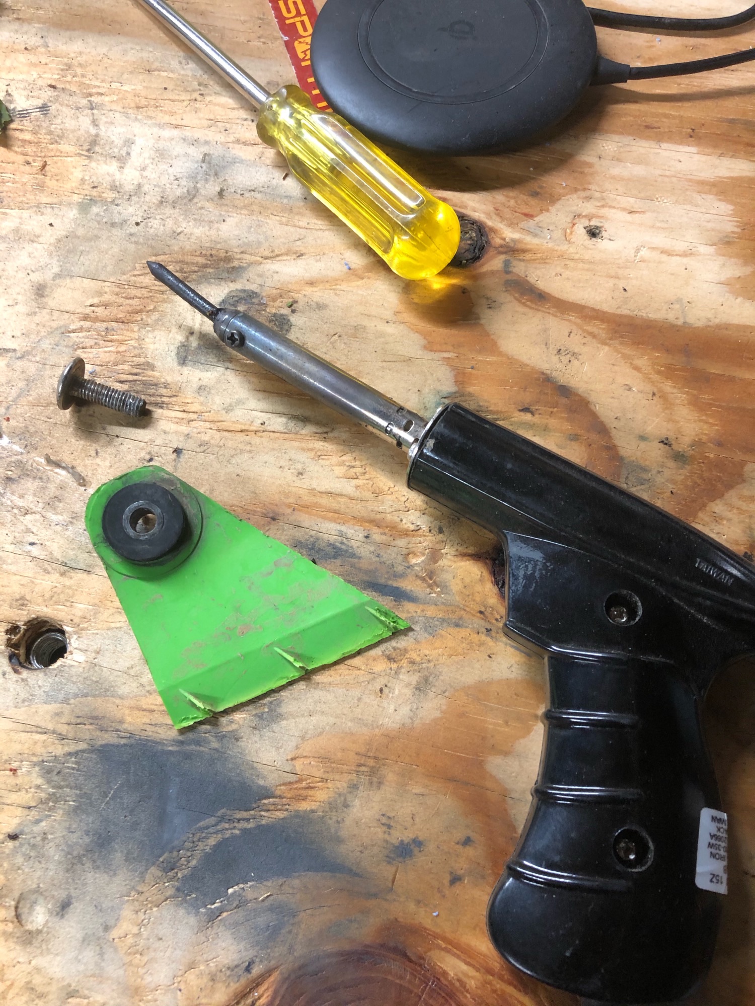

- Using an old solder gun, punch a hole through the end of each crack to stop its migration

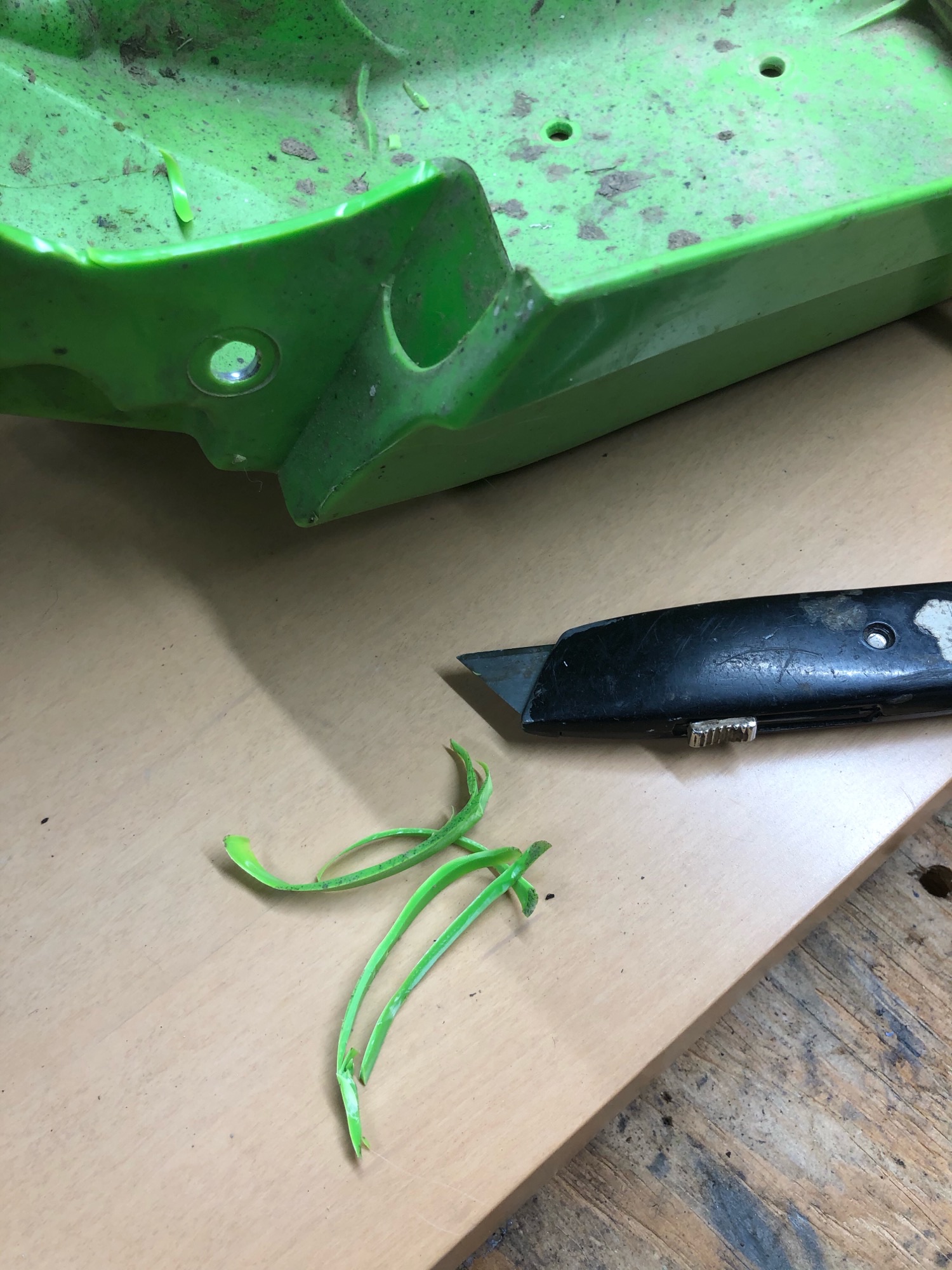

- Farm plastic material from an unseen area of the part being repaired or from a HDPE bottle or other plastic thing that has some material to spare. I use Tide bottles on my son's KTM shrouds and they work fine.
- Work your hot solder tip into the plastic being repaired but don't go all the way through, I try to burrow sort of a trench and then fill the softened gaps with the farmed material to fill it up and then press it in with the hot tip.
- I found softening up the farmed material with a heat gun can help, but isn't really necessary. It is nice for straightening out curled up pieces though to make them easier to place.

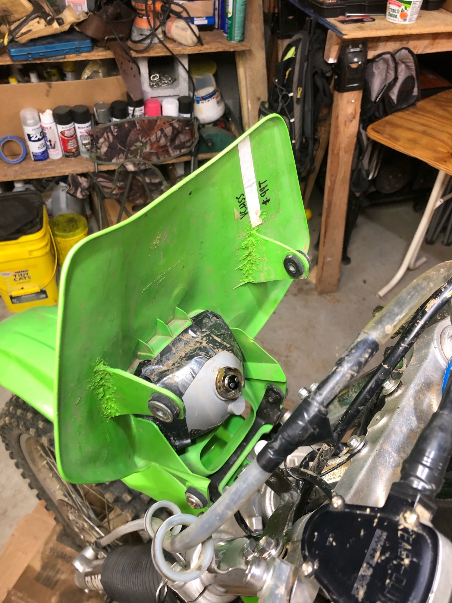

So anyways, on Saturday my beloved and once proud college football team got smoked by the Liberty Flames. I wasn't in the mood for pouting about it so I fired up the KDX for a long shakedown ride in the woods here at our house. Just before dark and literally two minutes from shutting her down I washed out over a tree limb in a downhill turn and the upper mounts on my fairing sheared... on the far side you can see where I had half-heartedly repaired a minor crack I'd discovered a few weeks ago.
A big ride was planned for the following morning with my KDX riding buddy so I knew I had to set to work and get this right. I took out an old broken rear fender that came with the bike and farmed off some material for the job... Next thing was to fire up the solder gun and while I waited for it to get to temp I straightened out the tweaked steel lower mounting bracket... After finishing the work and adding a fair amount of material to strengthen the connections I also flipped the upper brake hose routing bracket and tweaked it some. It has always annoyed me how the hose rode so high above the fairing before bending sharply down towards the caliper. This rerouting really helped hide it from snares and looked a lot more tidy. This winter I hope to upgrade all of my ugly old hydraulic lines when I rebuild my brakes. Got to make her look snazzy since she's going to be lining up against all these fancy euro machines next season! After a full day of HAMMERING at Kairos Resort and suffering my share of drops and oopses my fresh welding job held up to the task. Very satisfying! Having a working head light is nice insurance this time of year when somebody flats deep in the mountains where we are.

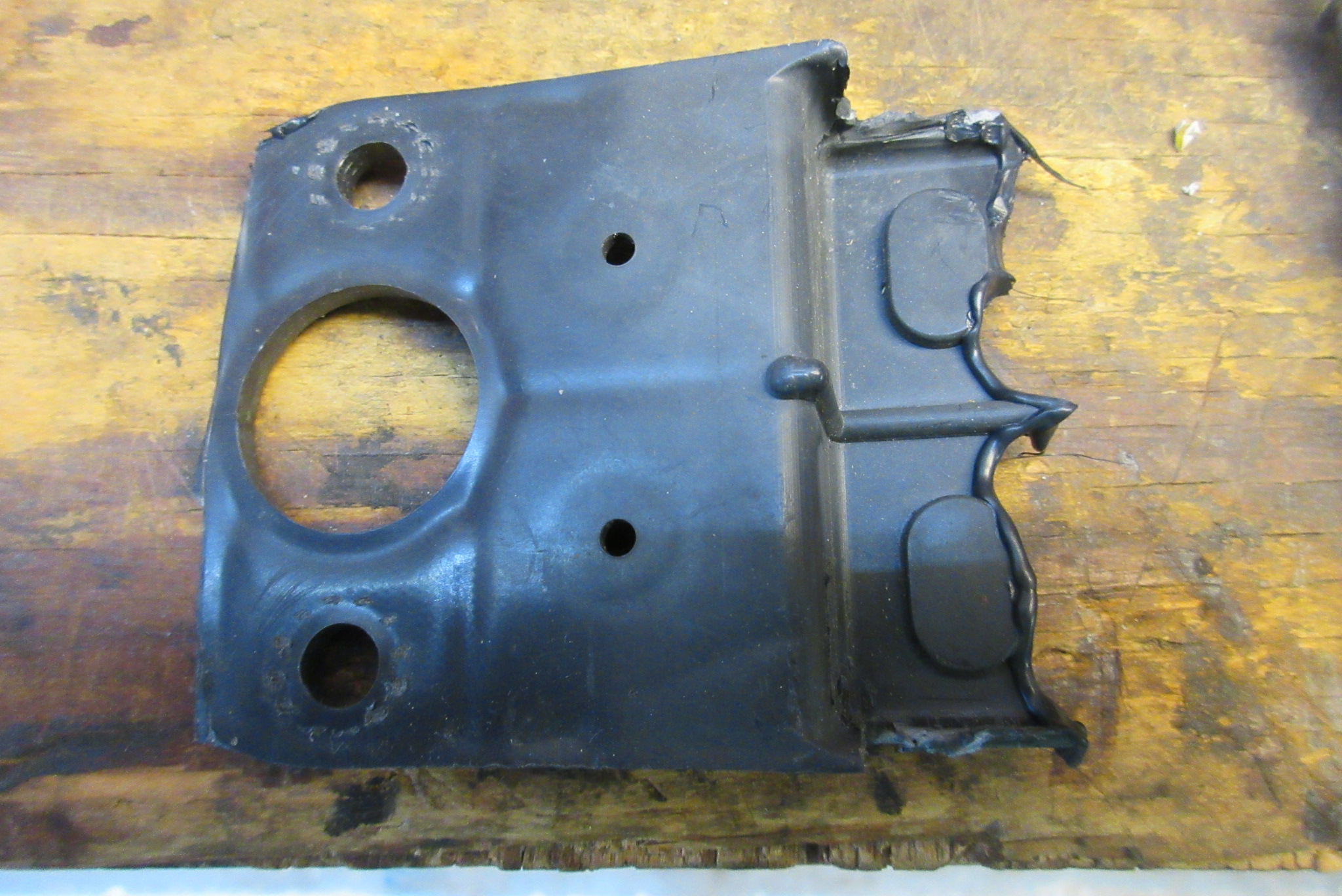

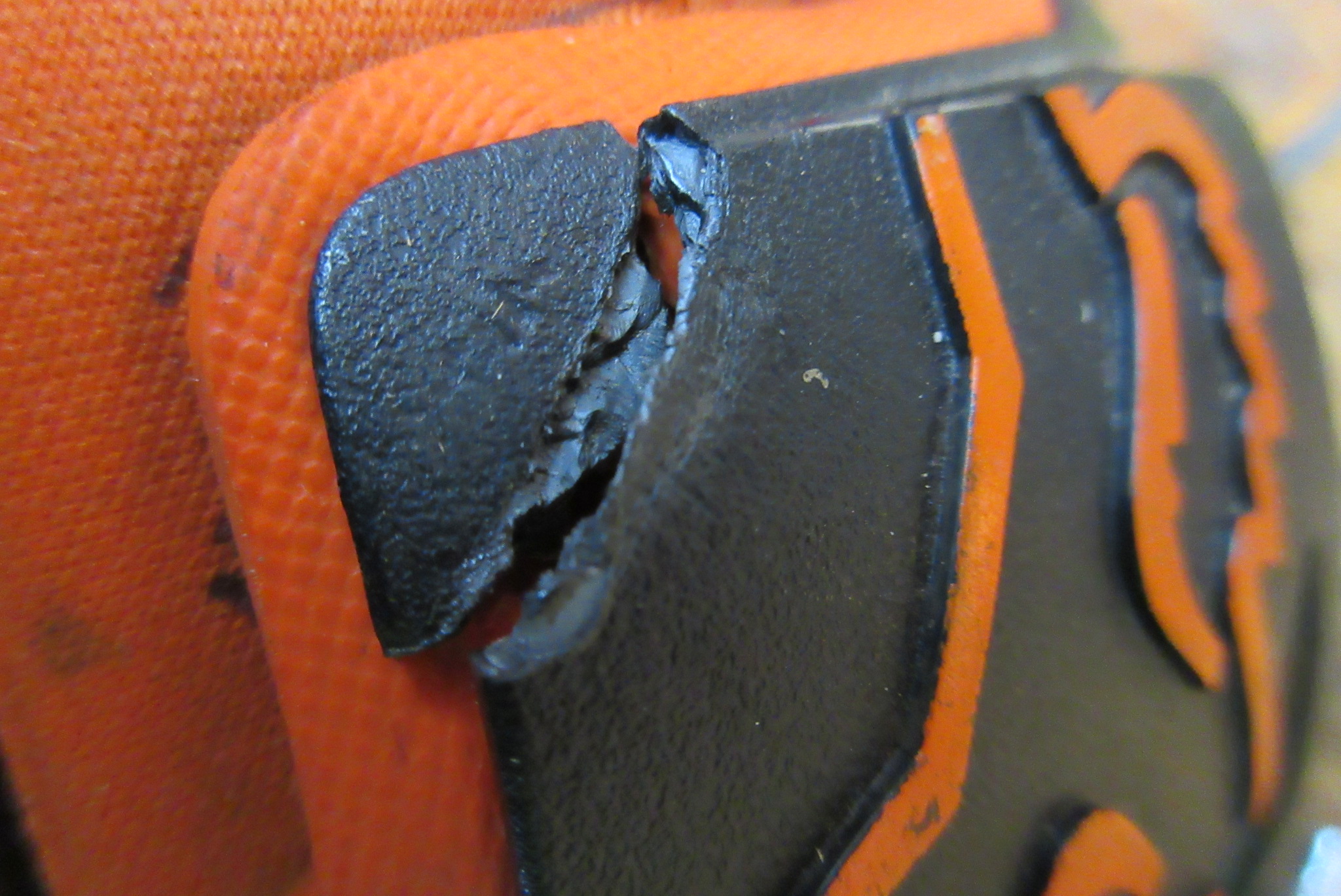

Chest protector repair
(the chest protector appears orange because the lens was dirty)

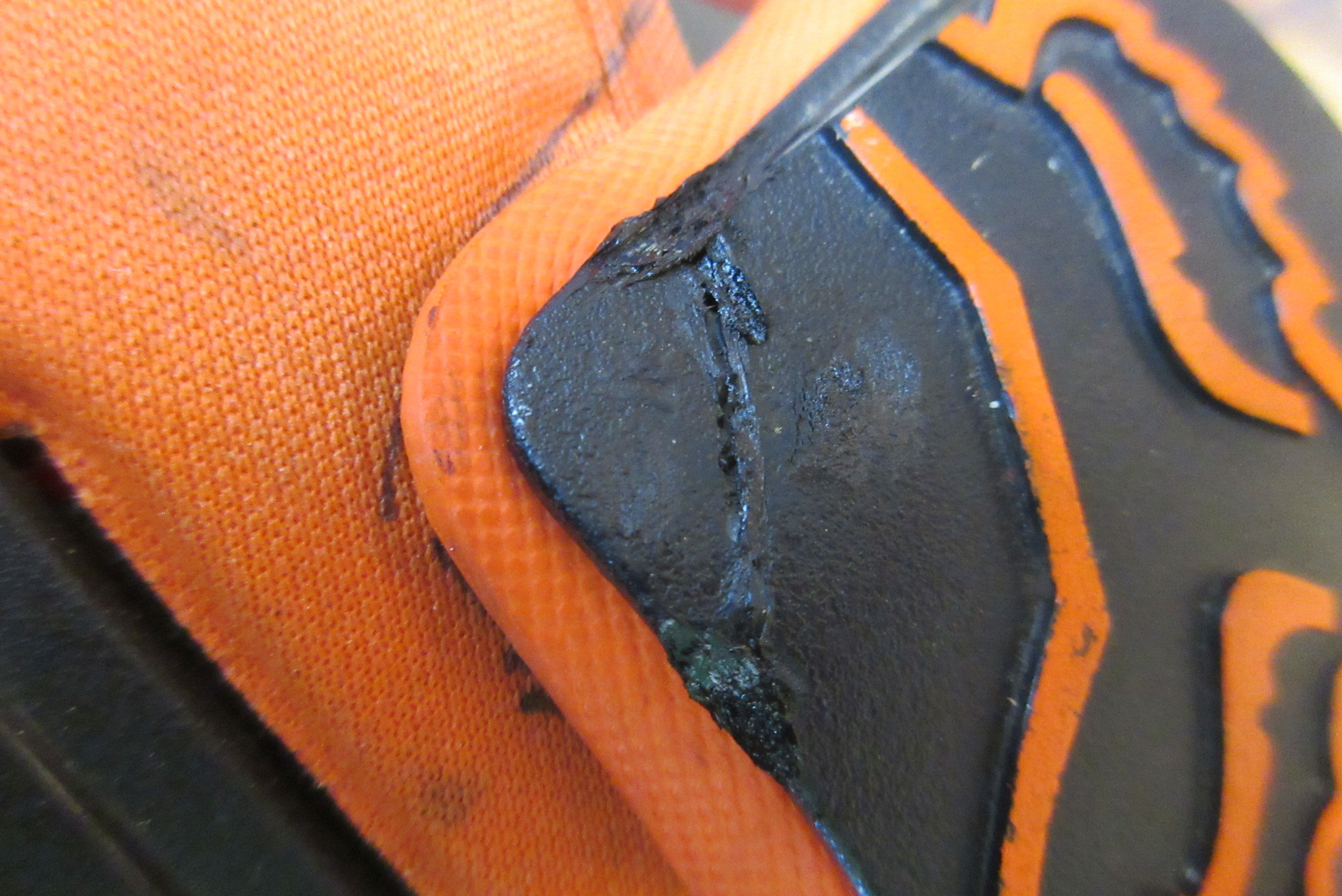

- Broken piece to be fixed
- IMG_1902.JPG (764.43 KiB) Viewed 3963 times
- Tack the ends
- IMG_1905.JPG (811.11 KiB) Viewed 3963 times

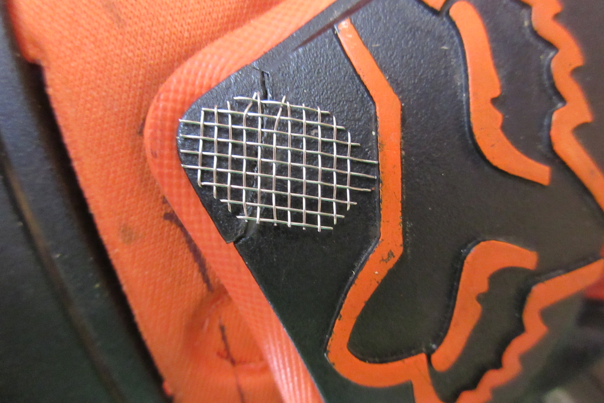

- Cut reinforcement screen
- IMG_1903.JPG (836.86 KiB) Viewed 3963 times
- Heat and embed the reinforcement screen
- IMG_1906.JPG (744.86 KiB) Viewed 3963 times

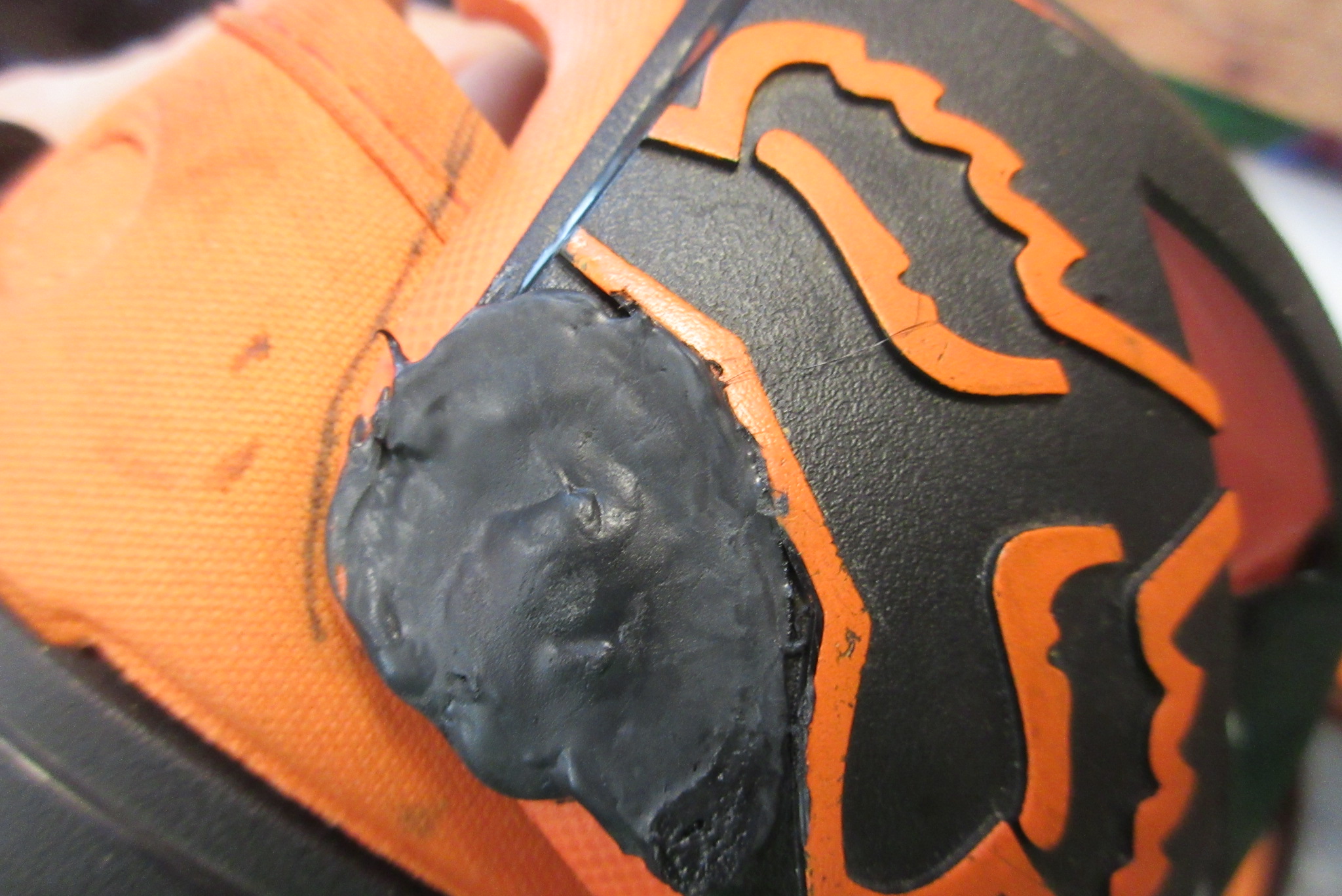

- Add reinforcement plastic(in this case from license plate holder
- IMG_1907.JPG (702.29 KiB) Viewed 3963 times

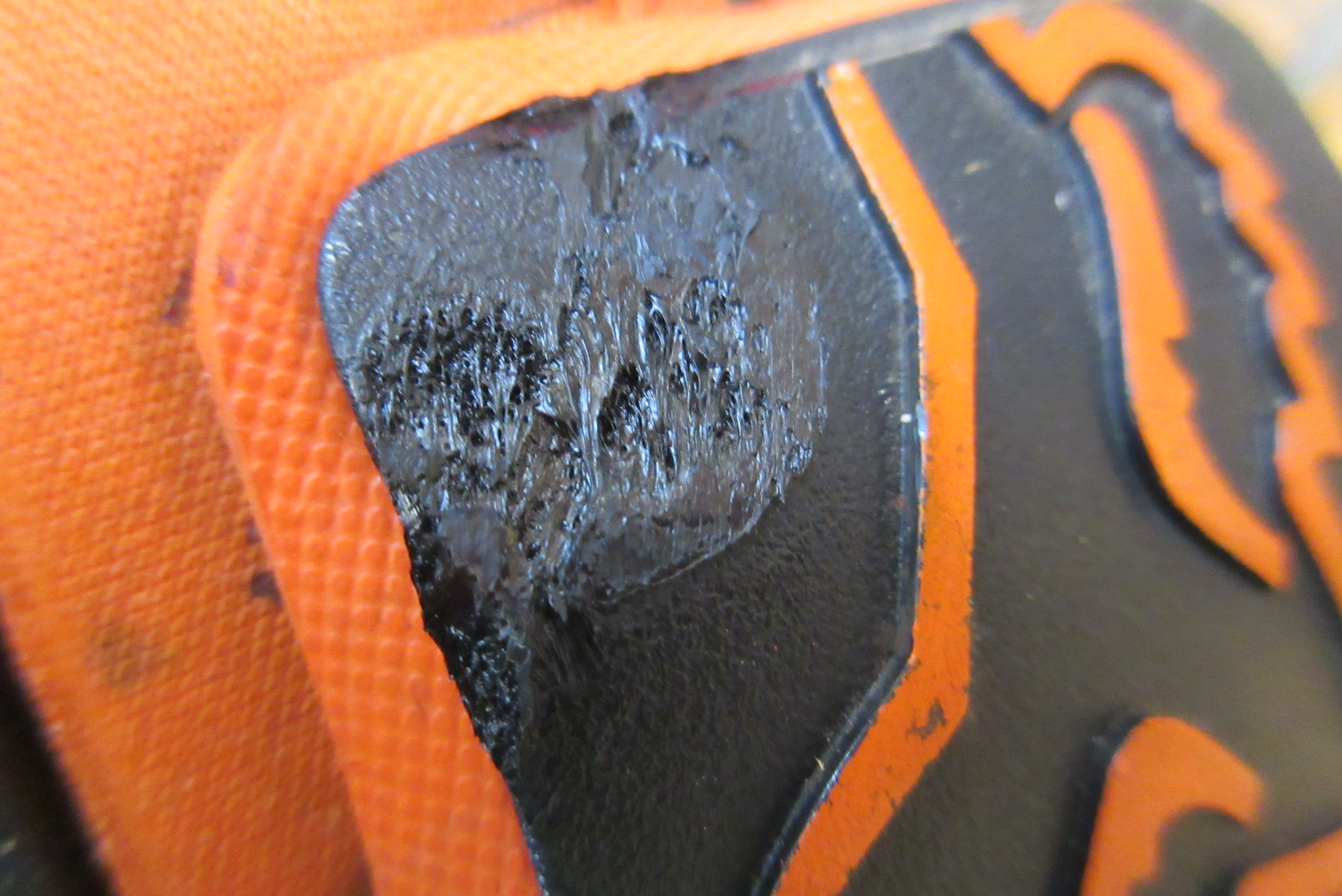

Obviously, I did not show you the finishing steps which makes it look like new. But, I'll do that another day.
As Moonstomper alluded to, the key is to match plastics. Polycarbonate needs a polycarbonate rod, Polyethylene(think gas tank) needs polyethylene rod.
Another key is to be sure your weld goes full thickness so you aren't just joining the outer surface. This takes temperature control to avoid burning the plastic. Smooth, even heat is key.
The welder came with multiple rods for repair and you can also buy them on ebay.
Stomper dun' did good. I probably would have added the steel screen reinforcement for added strength.
