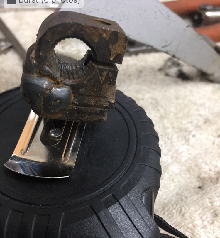

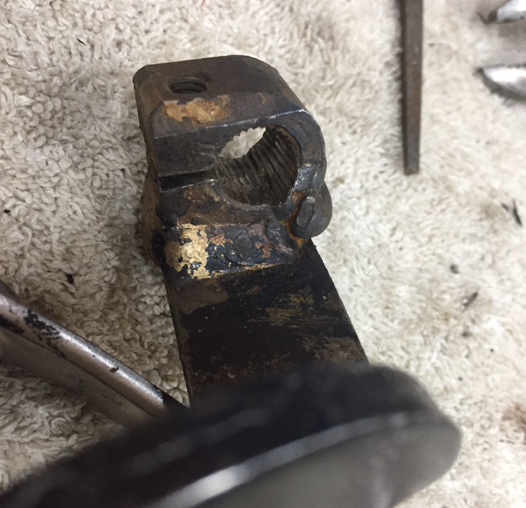

Well you called it Doakley. My fine shifter weld nicely lasted one full race + 1 rock. It broke again about 15 min into riding, yesterday. Lucky enough I just kept snugging the clamp bolt and managed to get it thru about 4-1/2 hrs of HD woods. So broke down and spent my $50 on order for new one.....$5k here we come.
Not sure if new one will make it for next weekend so may have to take another crack at it.

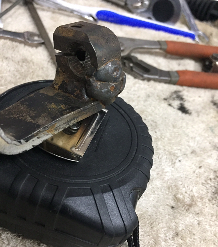

My new shift lever didn’t come in time. So, another 10pm welding job last night.
If I remember right from shop class, welds work better when there is some penetration on both sides of the joint! Even got a little fancy and ground a notch first, this time.
Track today, so should be bouncing off any rocks.

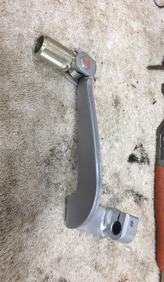

Yea! Shifter still in tact after 5 motos, yesterday.
I decided to go with OEM since the RE bendable metal seems to fit my riding style. (+ extra $30 towards the $5k minimums.)

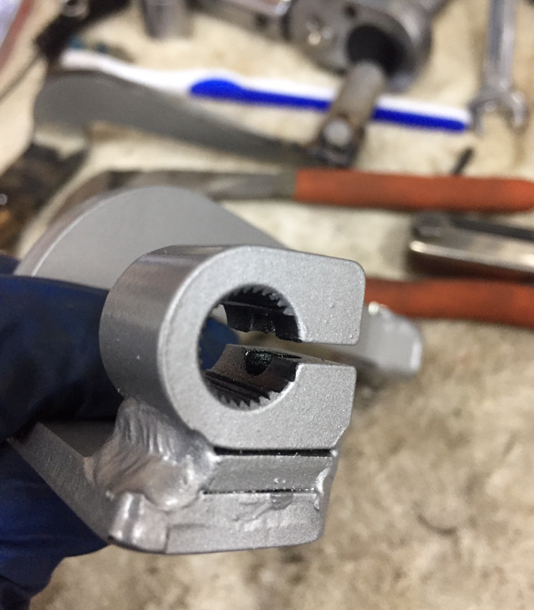

I did not weld into spline area (except where I messed up and dribbled some there from the side, and the had to spend more time to fix that than it took to weld). I just meant that first time my weld did not make good penetration on bottom of crack on the backside. I just did one quickie pass 1st time, and did not have heat high enough.
I don’t think it’s going anywhere now! But still like the new one much better. And a lot less likely to beat up the grooves on the Shifter spline.

I did! Made sure I dripped enough to turn my fingers blue.
Should mention that my super weld also took most of flex out of the clampy thing so I really had to reef to snug it onto spline. It’ll work in a pinch, but New one much mo-betta.

"you can't beat brand new."
Look at the difference in the splines!
