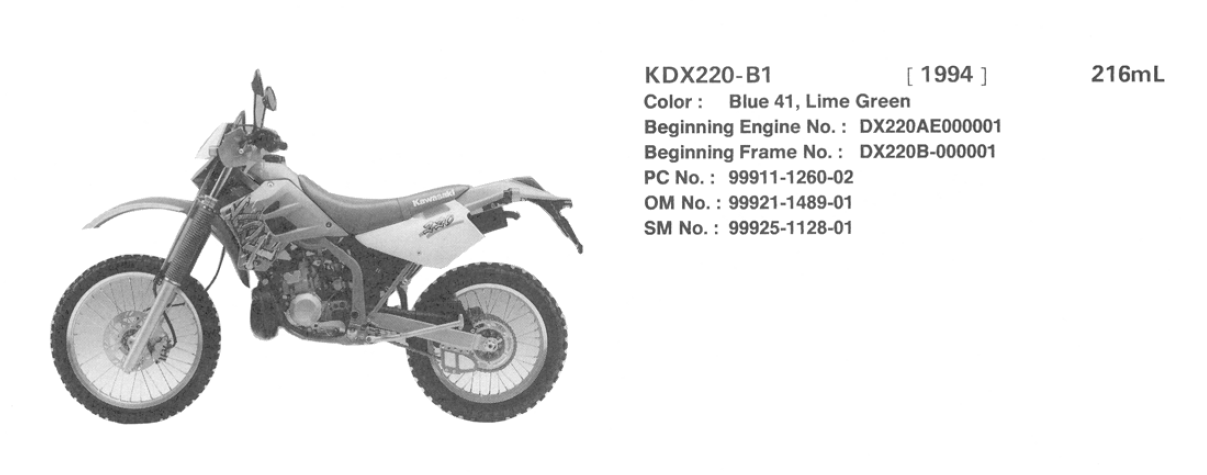

Here is the first model in the "B" series, which was not sold in the USA.
1994 KDX220-B1.png (165.91 KiB) Viewed 3390 times
