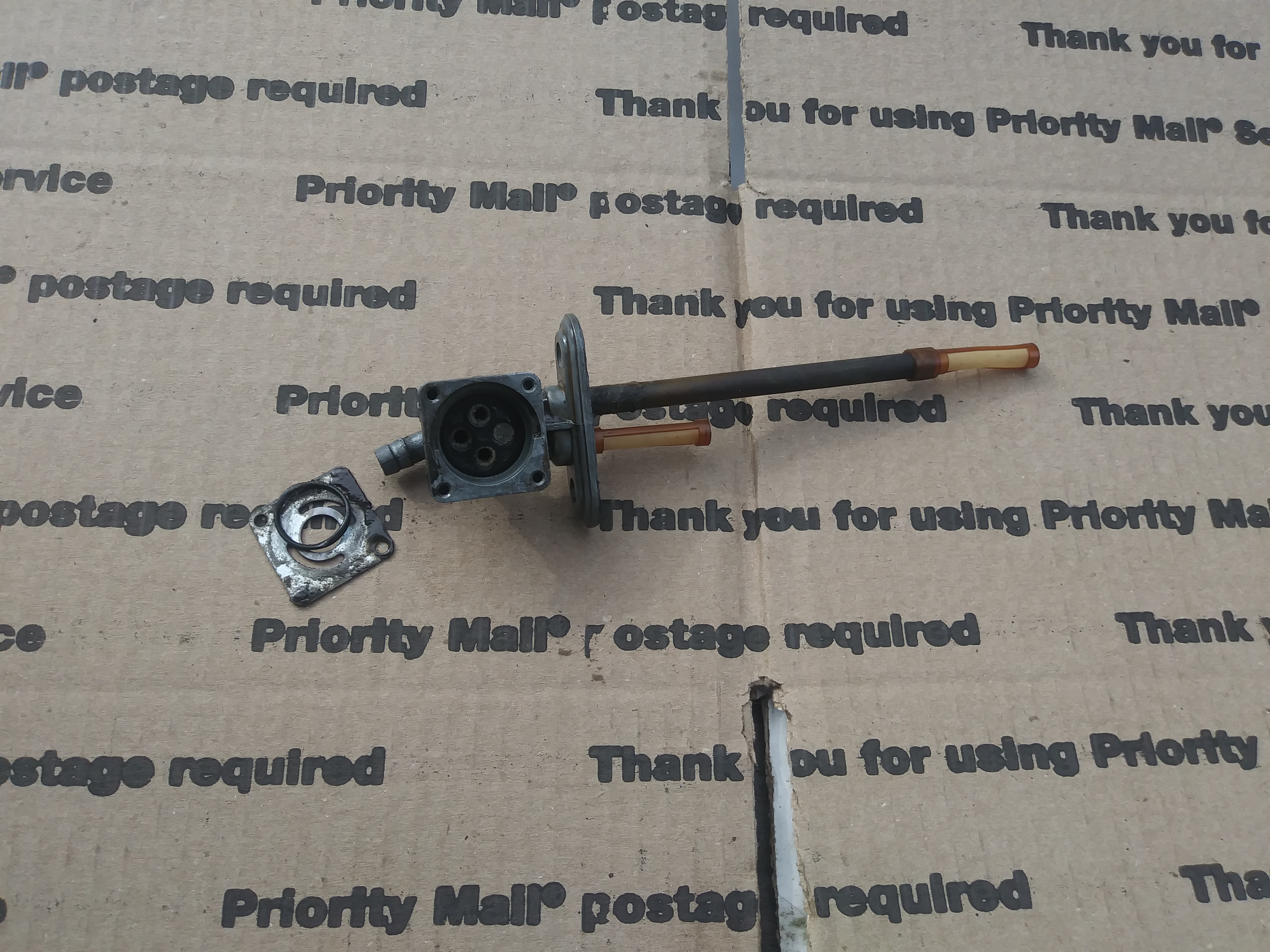

you can blow through it may work temporarily but I definitely think it is in your best interest to take the tank off and give it a flush, something may have gotten in there, if its clogged up from debri it will blow it out of the screen in the pet cock and around in your tank, soon to be gathered at the petcock again, so thats why i say rinse it, also you can put the new petcock on as well, see below..
I actually went through the whole process with mine... the petcock tubes have a really fine screen on them where the gas enters and if they have gotten clogged up it will be hard to clean it , scrubbing a tiny plastic filter. they are pretty much a one time use type filter, as in once they get plugged up, your way better off getting a new one.
so $12 on ebay and a few days later I got the new petcock and its definitely a decent built little unit. brand new screens, turns smoothly, and comes with a new rubber gasket. If your in a hurry, your local bike store may have it, I think they are pretty generic.
In my case the screens were ok shape but there was so much corrosion in the pipe... you can see what it looks like in the pic below if you haven't seen one.
****Definitely make sure the tank cap is off when you open the petcock, blocked tank vent as mentioned previously would cause that exact symptom as well.
