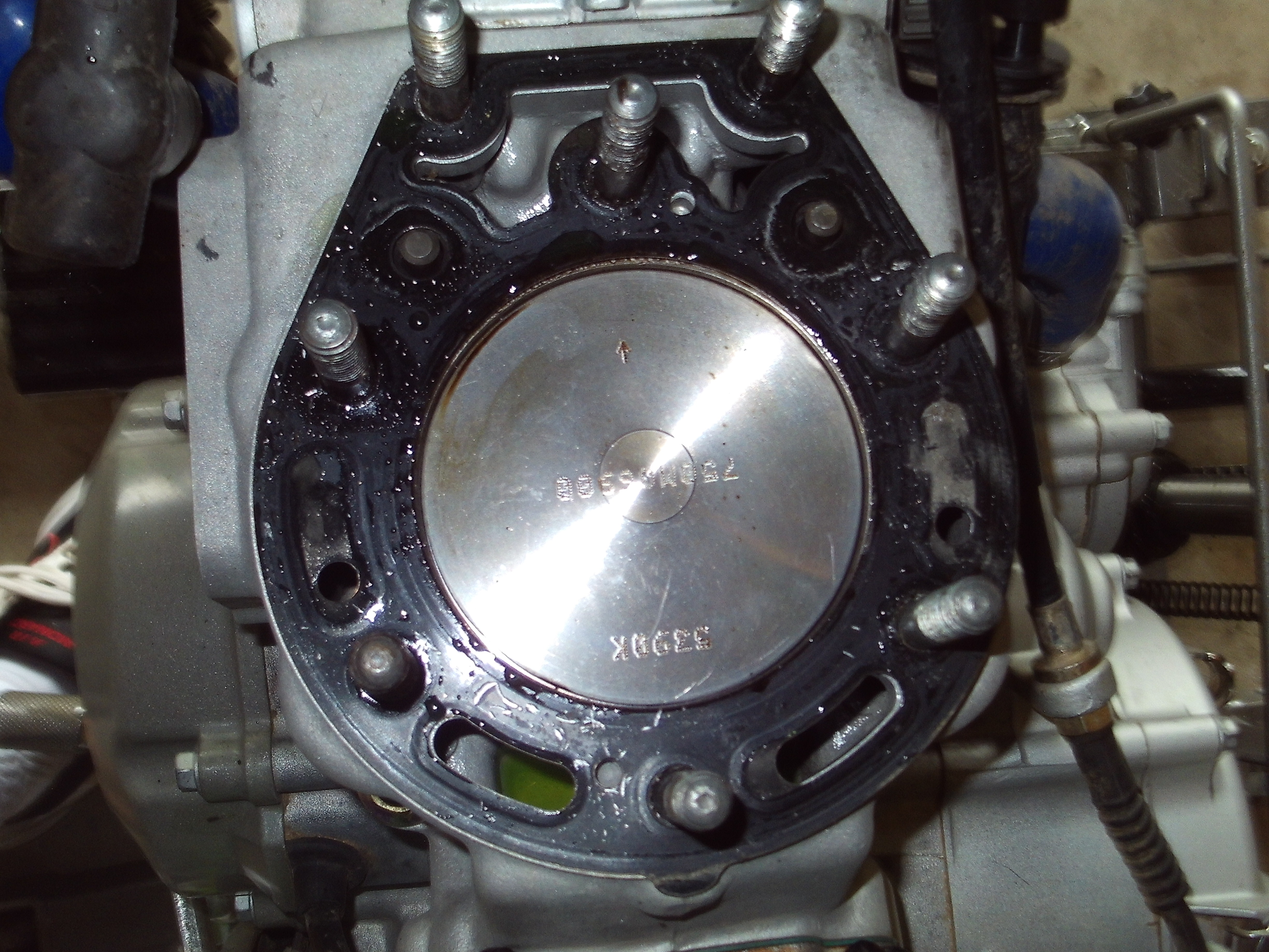

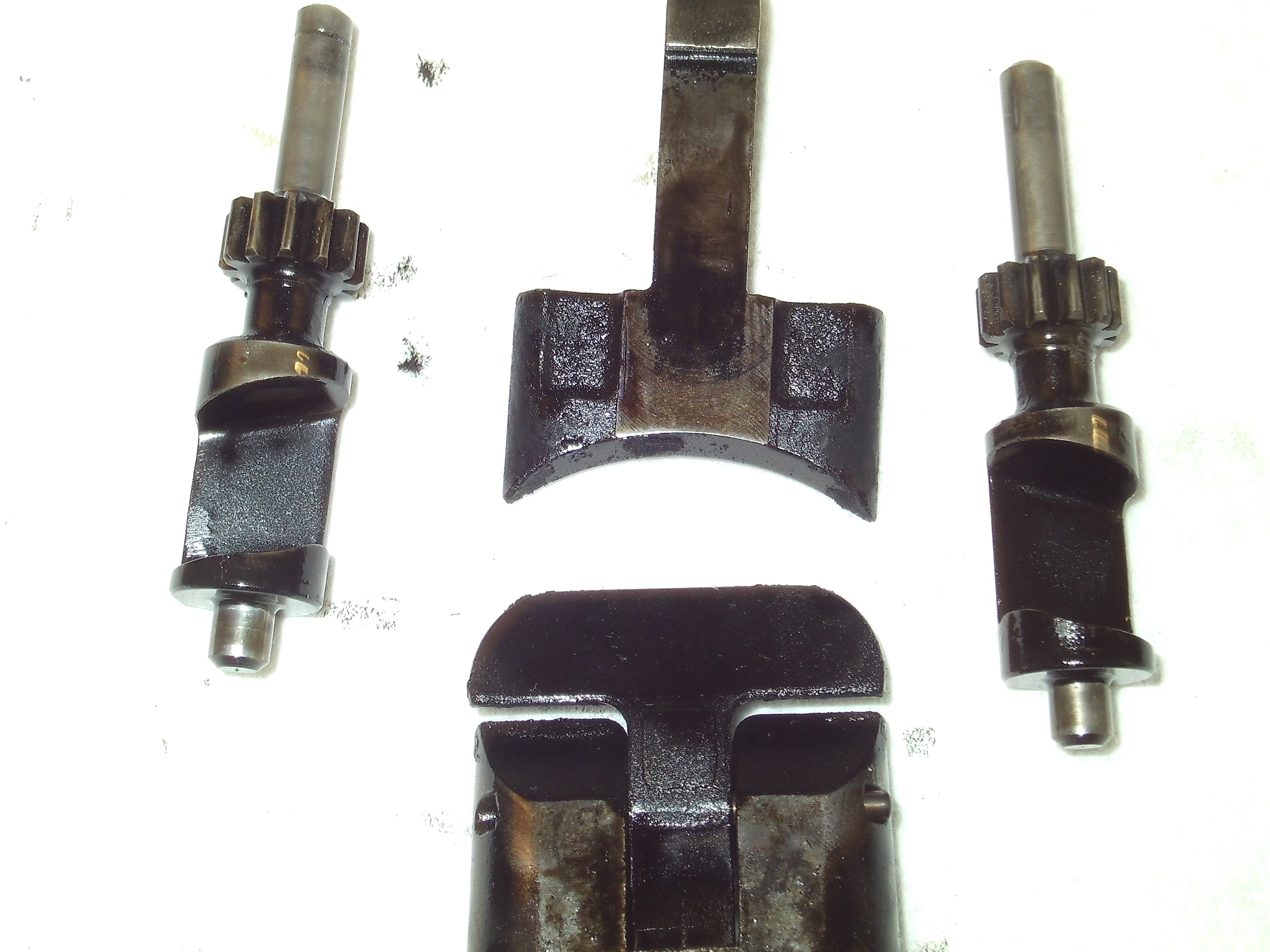

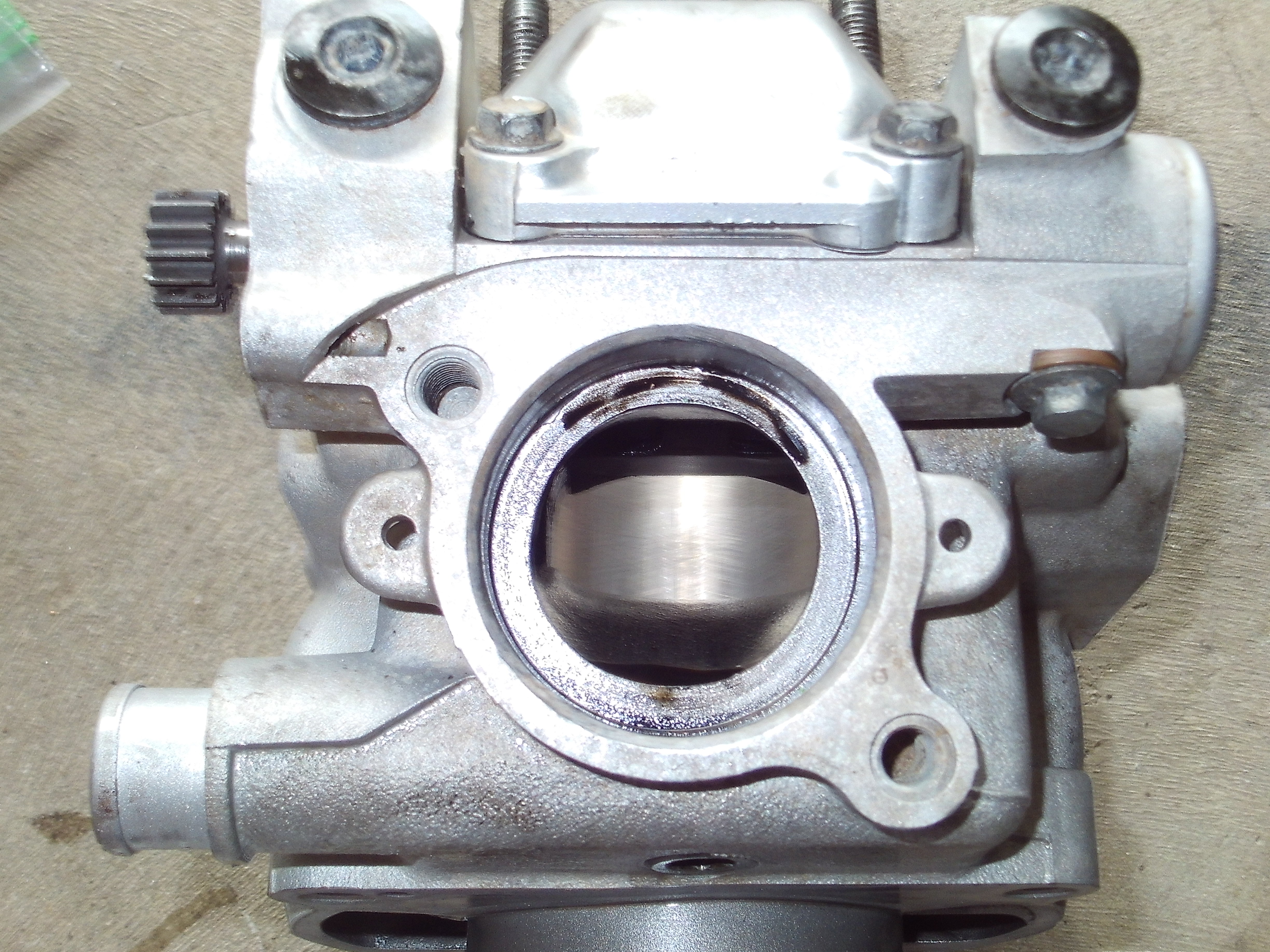

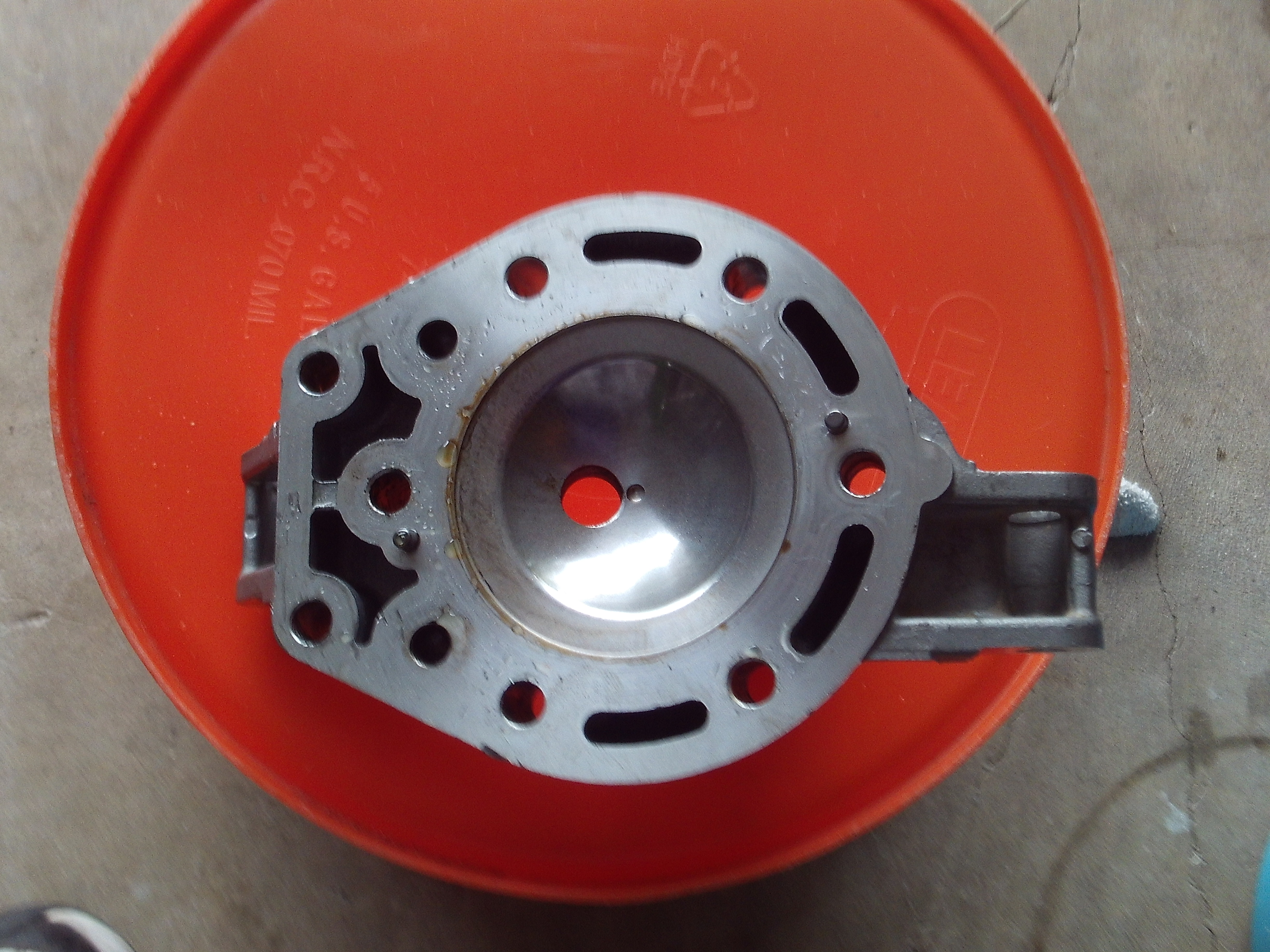

Here's what my KDX looked like after 7 hours ive torn it down to send the cylinder to Fredette racing to be ported, This is with Yamalube 2r @50 to 1, I have not touched any of these parts with a rag to clean them up, Everything looks great but there is slight carbon on the Kips, If anyone has an even better oil that would have been cleaner I would like to know what it is, All my friends and I have always had these same results for over 30 years, Its an oldie but still good buy any means

After thinking about it knowing the problems that occur with the kips valves I think this was excellent every where but the power valve I only had 7 hours on this top end and there was already carbon on the kips, Ive heard alot of great about motorex cross power 2t its really expensive

What he said...the KIPS is going to collect carbon regardless of what oil you run. But go to light on the oil and you run a very real chance of under lubricating the big end bearings. More important to jet the bike correctly to minimize the spooge, but the very nature of how a 2T works you're always going to have carbon buildup and unburnt suspended oil.

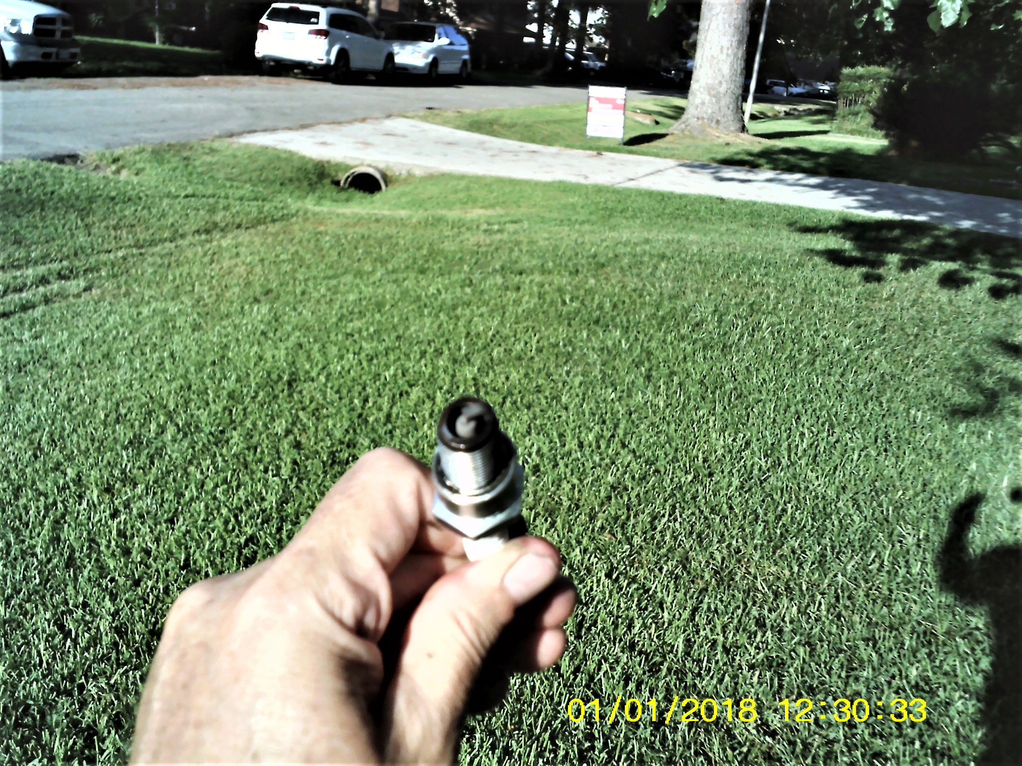

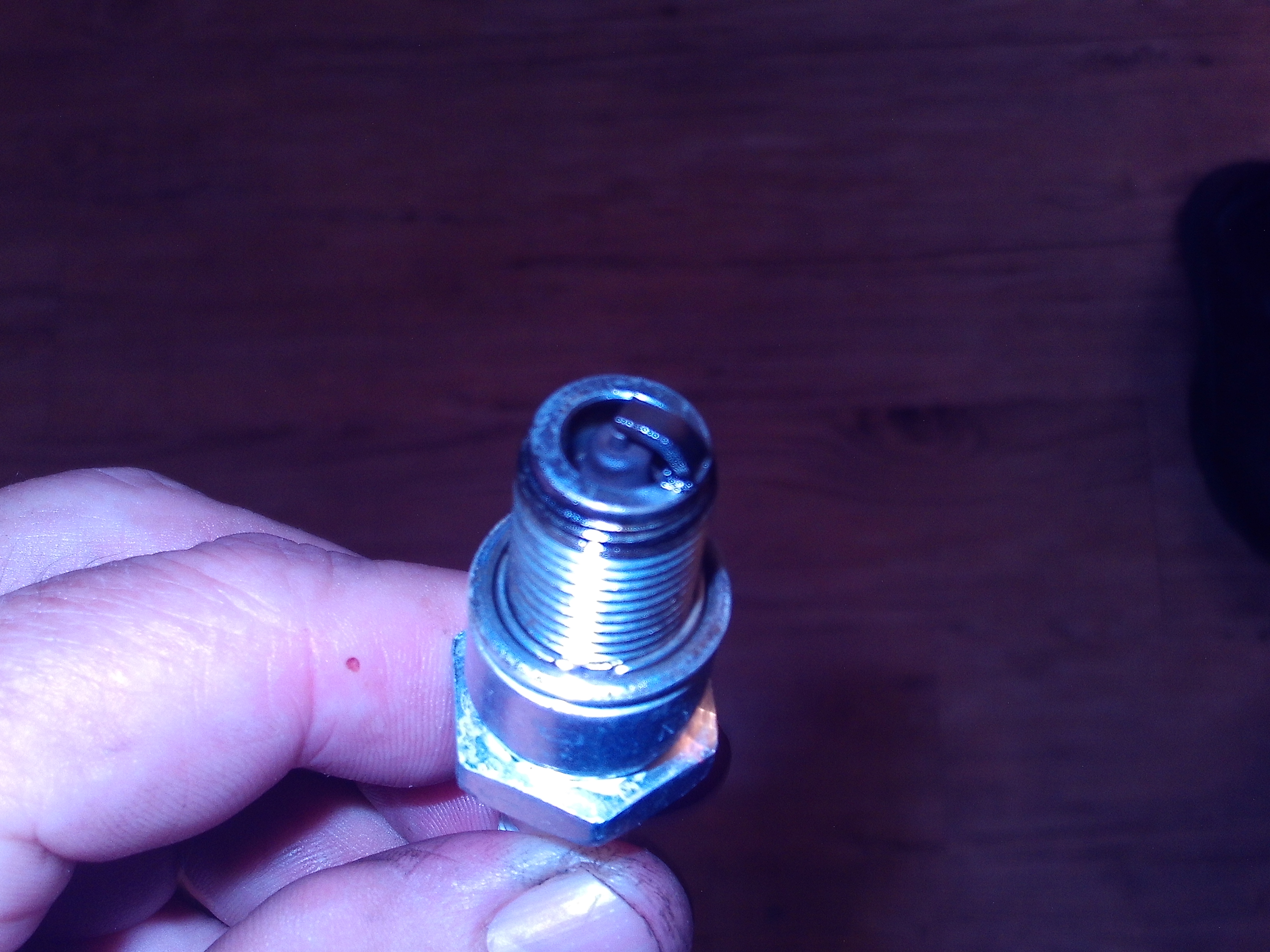

I agree with you 100 percent, I didnt have near the luck with motul so far the motorex is the best oil I have used in the clean burning catagory I think the two drops of spooge that i had was only blowing what very little yamalube that was already in the silencer, This is my plug on the first ride with crosspower and is the best Ive ever had under the exact same conditions. Im @ 60/1 I will buy one of those cameras that fit in the spark plug hole to keep an eye on things but so far so real good!
