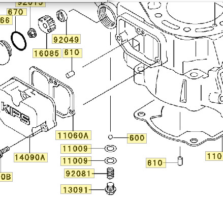

Spring under ball on left side power valve screw, underneath?
- Posts: 13
- Joined: 05:33 pm Aug 06 2017
I'm trying to source a 92081-1527....
I cannot find it anywhere. I think I have lost mine. I will try digging through parts (and maybe even the trash) again.
I had to disassemble the cylinder/jug to have it replated. I'm guessing I lost this piece to my garage floor.
Any help is greatly appreciated. I have my cylinder/jug back and I'm ready to reassemble, but this is holding me up at the moment!

I appreciate that, but it is the spring that I am short on, not the ball.

It's not absolutely necessary to have the ball and spring. I think it's only purpose is to reduce the KIPS rattle but I could be wrong. Sure doesn't look to do anything of significance. Mine was missing when I did my top end and the bike ran fine.

That spring and ball are there to delay the rotation of the Kips shaft. Remove one or both washers and Kips activation occurs at higher RPM's. Modern bikes have power valve screws where you can fine tune the activation of the power valve. If you are happy with early Kips activation, there's no need for the ball and spring. Oh, and check the bolt. Sometimes the spring is just stuck up in it.

I saw that Jeff Fresette recommended removing the ball and spring. I did on my 220 and it runs noticeably better. The powerband comes on a little sooner but it's nothing drastic. Definitely don't let it stop you from assembling and running the bike. You can always put it in once you get a new one. Hopefully it's still in the bolt like Eric mentioned.

Okay. I'm going to admit to it. I started looking at parts and putting things back together today.
I had the spring all along. It was inside the hollow bolt.... where it was supposed to be...
I feel like an idiot :D

I disagree with comments made about the ball and spring it's there to hold the kips closed and stop it rattling which in turn stops excessive wear of the valve train, when you take the kips side cover off, if you can see the shaft rocking while the engine is idling then that needs to be fixed, one of the ways I stopped the kips rattle was the hollow bolt was slightly ovaled, I put in a slightly larger bearing to take up the slack
