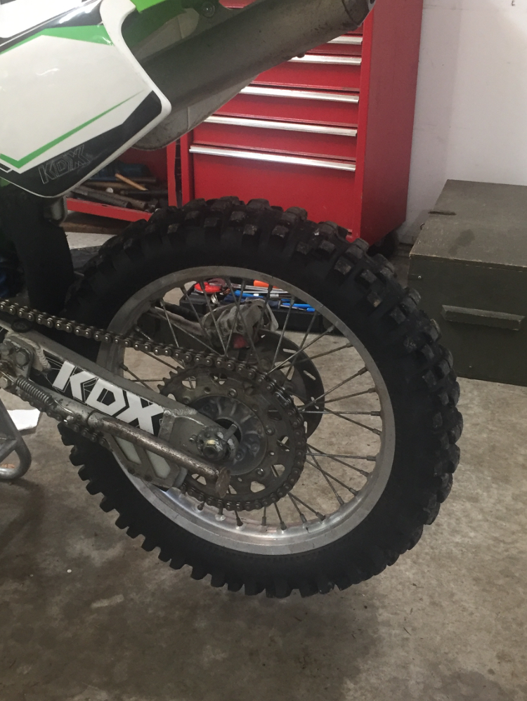

I couldn’t figure out where all the dirt came from on the bead. I had just pressure washed it.
New one looks better!

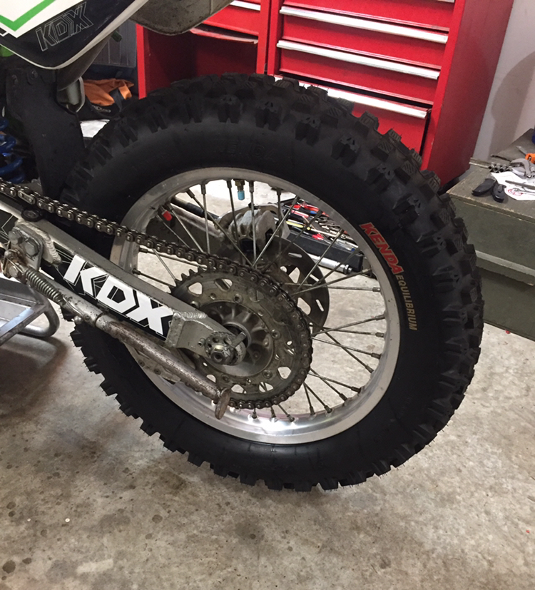

Oops. That was the “before” pic. This is the “after”
- 075E4326-5471-47C8-822F-7EF9B41EDFF8.jpeg (679.42 KiB) Viewed 3209 times

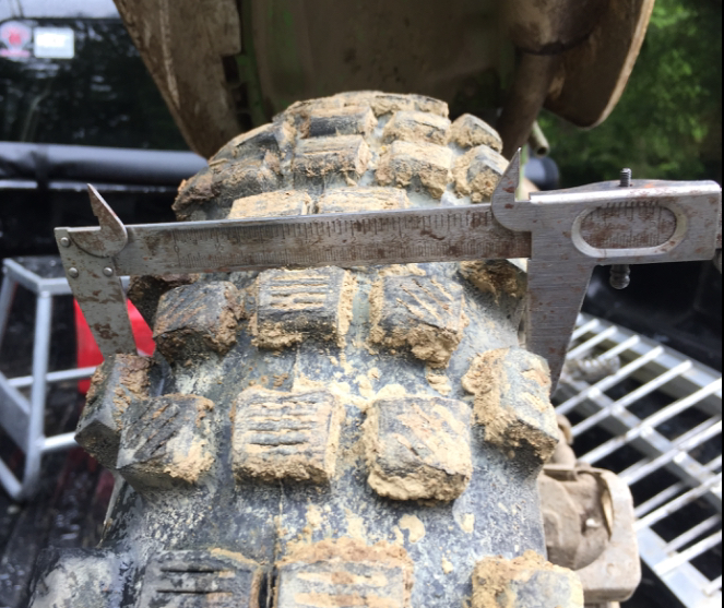

That is a 4.5-18. It looked a lot more at home on my XR650. We’ll see how she handles. KDXG likes it fine, so I expect good results. Headed for gnar today.
Re: Tubliss - install w/ new tire?
Man. That's wide! (assuming it is an actual 4.5", seems like they vary from manufacturer to manufacturer)

Looks like an honest 4-1/2”. Traction is pretty amazing.

Pic isn’t really good, but caliper shows 4-1/2”.
