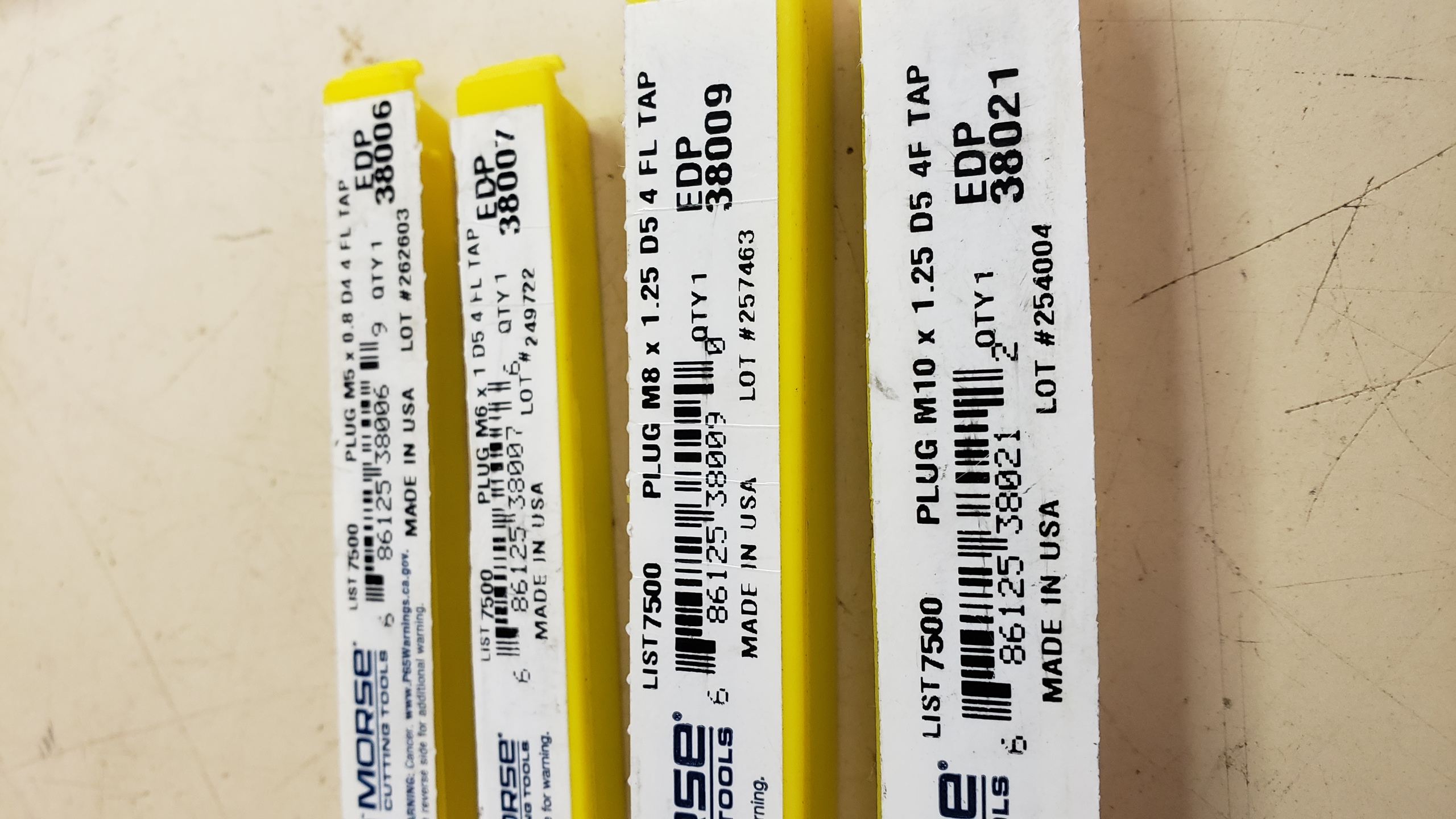

These are the Taps you need. You will NOT be able to assemble properly without clearing the threads!

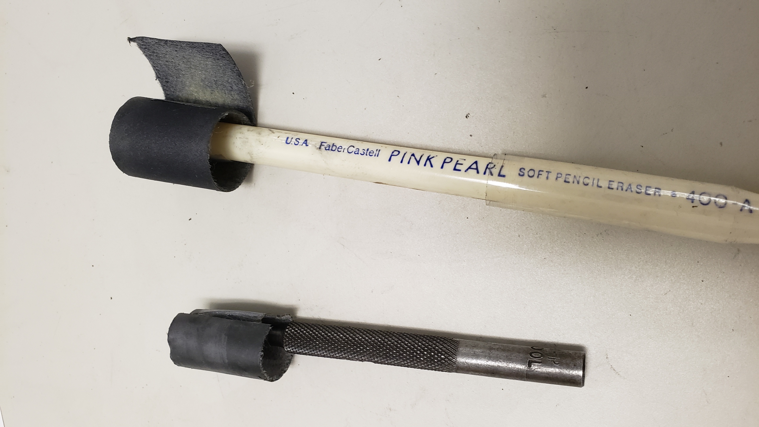

Also the DIY kips shaft journals reamers with some 400 wet-dry & seafoam or some type of light weight lubricant. I'd use some water displacement formula # 40 if it was all I had. It'll work.
