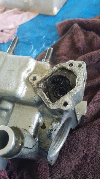

Hi All, Just Doing the top end on my 2005 H series KDX200 and all fine except one of the power exhaust power valve rods is totally seized in the casting, I have soaked over night but still can not move it in or out or spin it via the slot in the front. Any help will be gratefully received or what are my other option ie new casting needed can you drill them out then get a new rod etc. cheers

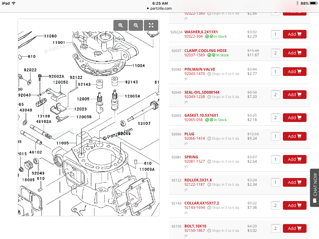

Re: seized power valve in head
When you say slot in the front that makes me think it's the rods that run front to back of the cylinder. Is the the right side (46102) that's stuck? If so that's the one with the oring on it that Kawasaki calls "packing" (43049). Did you happen to spray chlorinated brake cleaner in there? If so maybe the oring is swollen. Maybe it's just swollen or distorted from something else (carbon) lodging the rod in there.
If it were mine I would try the heat first like bufftester mentioned. Is every other piece of the KIPS out? I would also try to reinsert the main shaft (13107) through the right side. The smaller gear on it moves that rod front to back. If it's the left side rod that's stuck then put the main shaft plus the left gear (16085) and nut back on the left side of the main shaft. Then try grabbing the teeth of the main shaft and working the rods in and out by hand to see if you can free it up. Then I would (at my own risk of damaging the teeth) wrap a rag around the teeth and try "gently" getting the shaft to rotate with vice grips or channel locks. That's a little risky. Maybe spinning by hand only (with a leather glove where you can get some grip) and also applying heat at the same time. If it frees up you'd have to take the main shaft back out (goes without saying I guess) before the rod would fully come out. Let us know what comes of it.

Hi Thanks for the detailed feedback. Yes its the RH hand side horizontal rod the links the main shaft to the power valve.
Funny all the other power valve parts removed easily and looked relatively well maintained but this one is rock solid have tried heat and top much force and still will not budge. I Am prepared to sacrifice it and get a new one if only i can get it out. May have to take it in to the local mechanic to see if they know how to remove it without damaging the cylinder .
