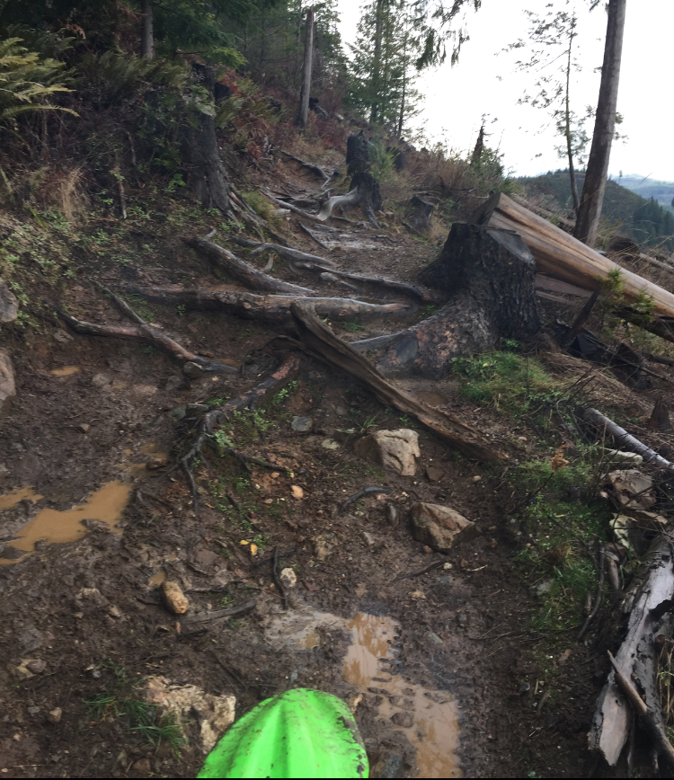

In case misery loves company. I know the feeling. I sold a small fishing boat in same time and had about 20 calls. Oops.
Enjoy the KDX. I agree it is not probably not a great MX / sweeper bike, but it loves what it was designed for: gnarly single track with roots and rocks for breakfast.

Come on Goat, we need video of the climb!

Maybe go-pros aren’t just for kids?
I should fess up: I pussed-out and hung it up on the first step.
I have tendency to let off once I get the front tire over & where I want it. I am still too timid and have to learn to trust the back tire to bring the front down while keeping momentum.
But, we ate the rest of them like they were speed bumps at the school parking lot!

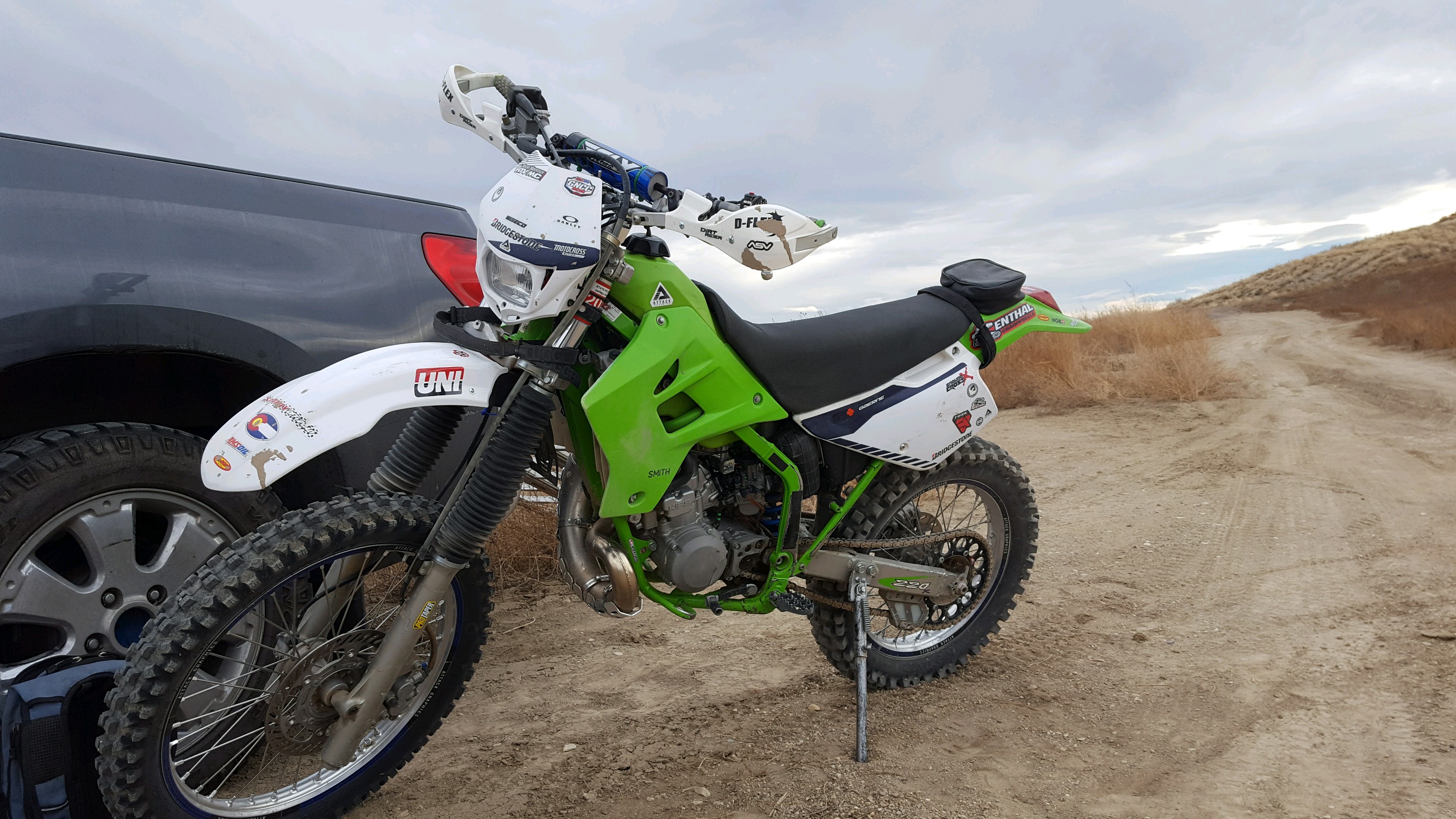

Thats the kind a trails my Beta?KTM guys try to lose me on, 10+oz stealthy flywheel weight, and Both front and rear shinko cheater tires and I CRAW right up that stuff, I love the crawl and grip of KDX< not as easy climbing as a KTM 300, but dang near close to it, my flywheel weight just keeps me chugging

I like that headlight. Where did you get it?

That looks like the Polisport MMX headlight I have on my KDX.

Side question: Do you know the specs on the Polisport MMX replacement bulb? I'm thinking on getting that light but want to swap in an LED bulb but have no idea what the bulb is...have looked on the internet a lot.
I really like the look of your bike! Nice!
