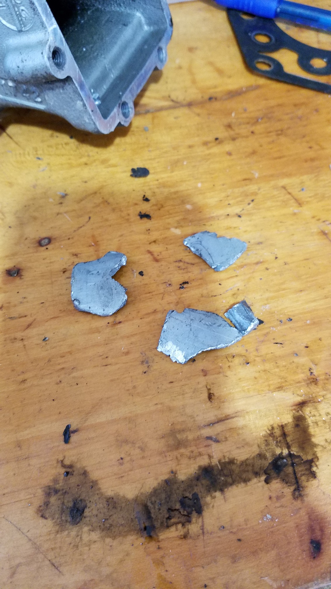

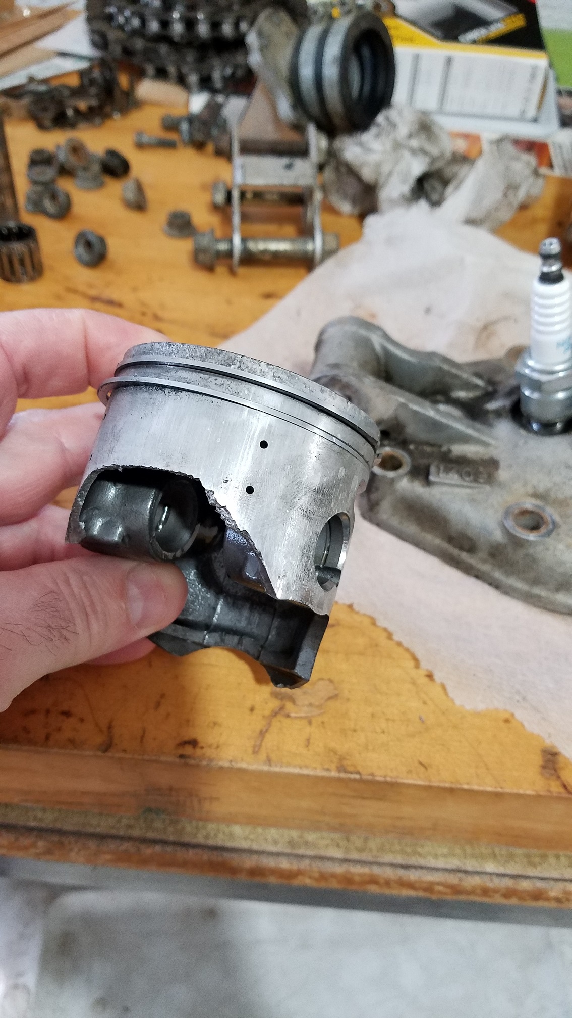

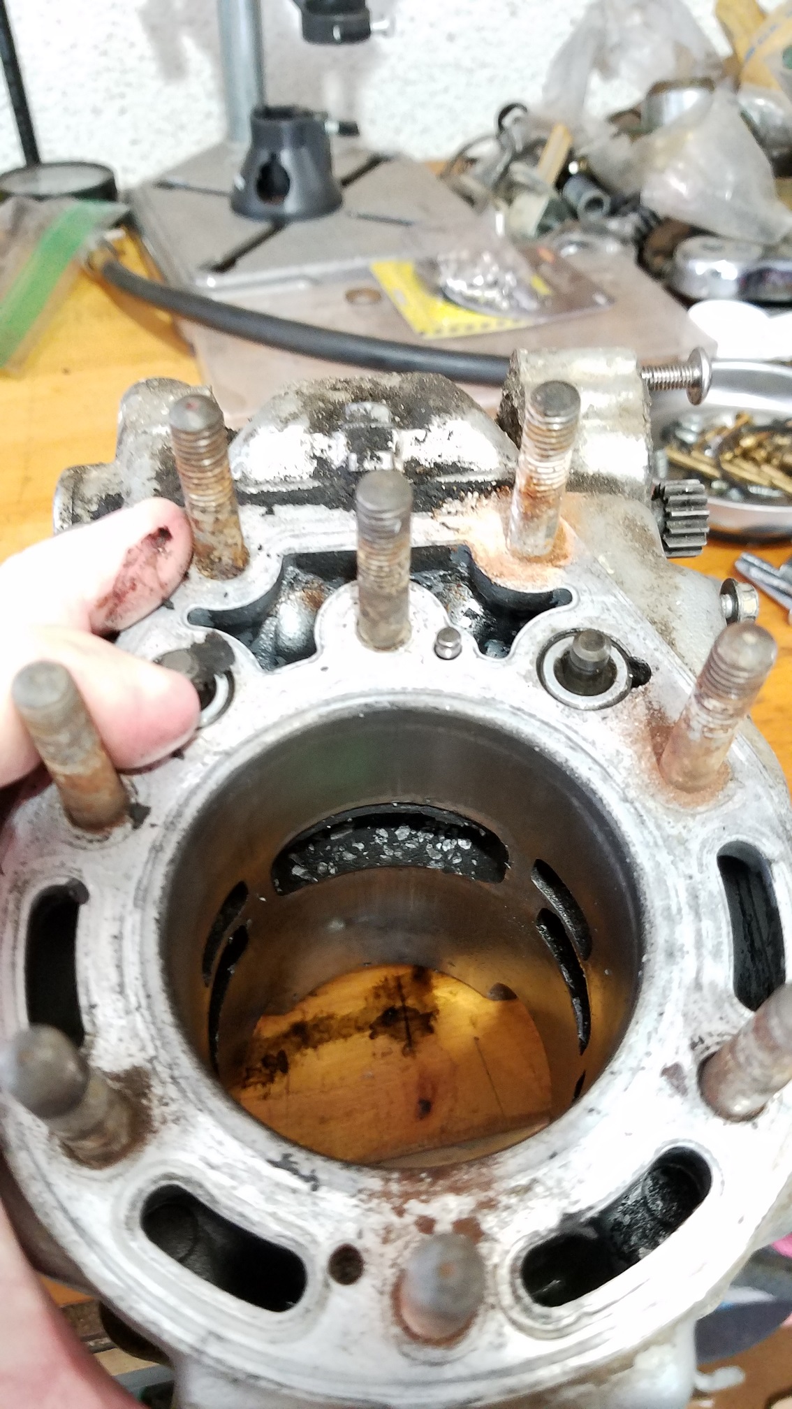

OK, so the piston basically grenaded. Shrapnel everywhere. I would like to get some advise from the group on a few things.
1. How do I get all of the pieces out of the bottom and and what should I inspect for to determine if the cases need to be split?
2. Should I go through the trouble and just split the cases anyway? Just significantly increases the time it will take me to get this thing up and running again but, if I have to, I have to.

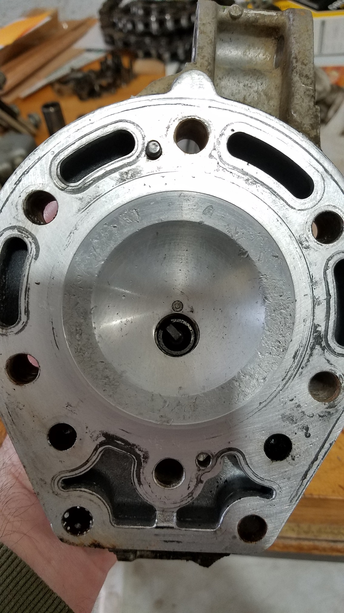

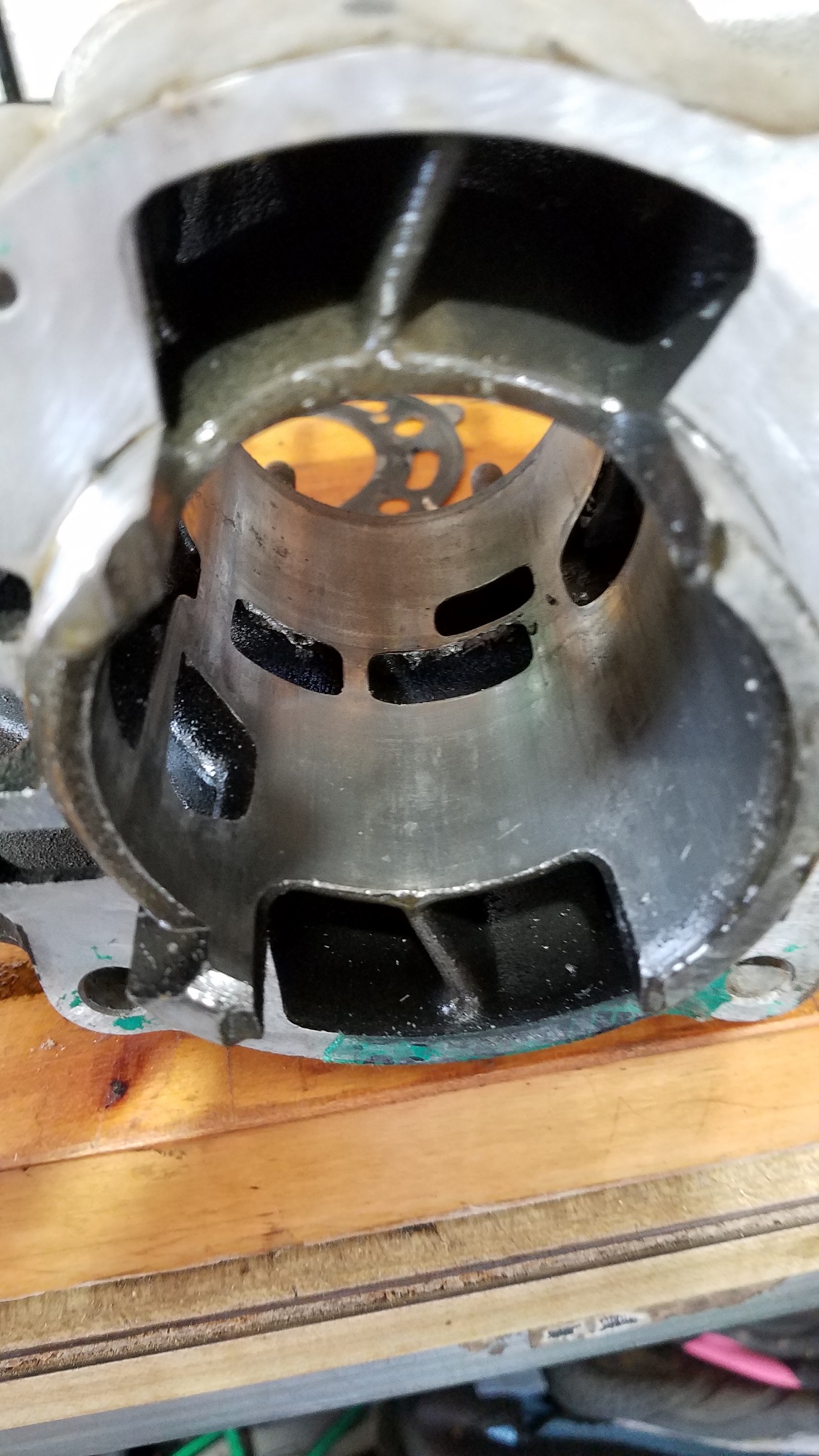

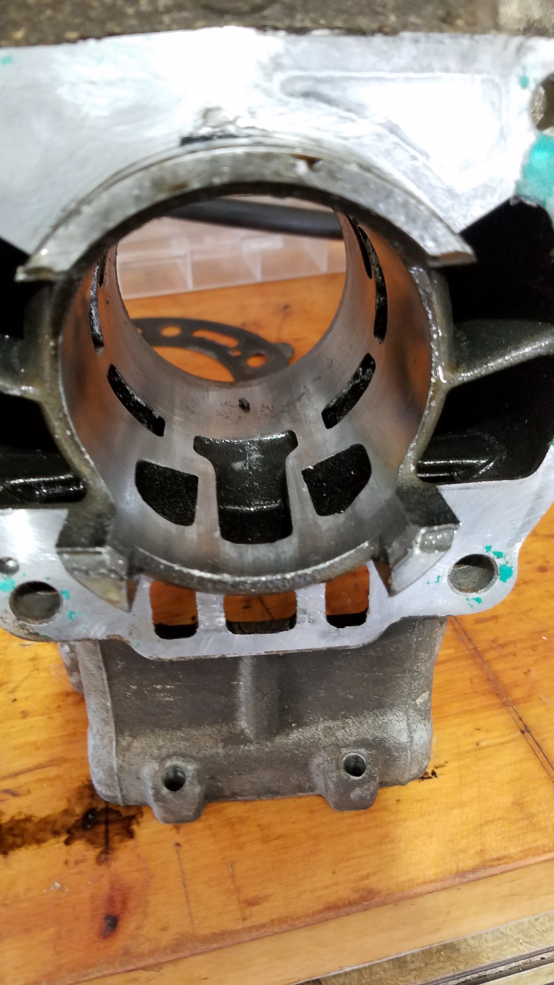

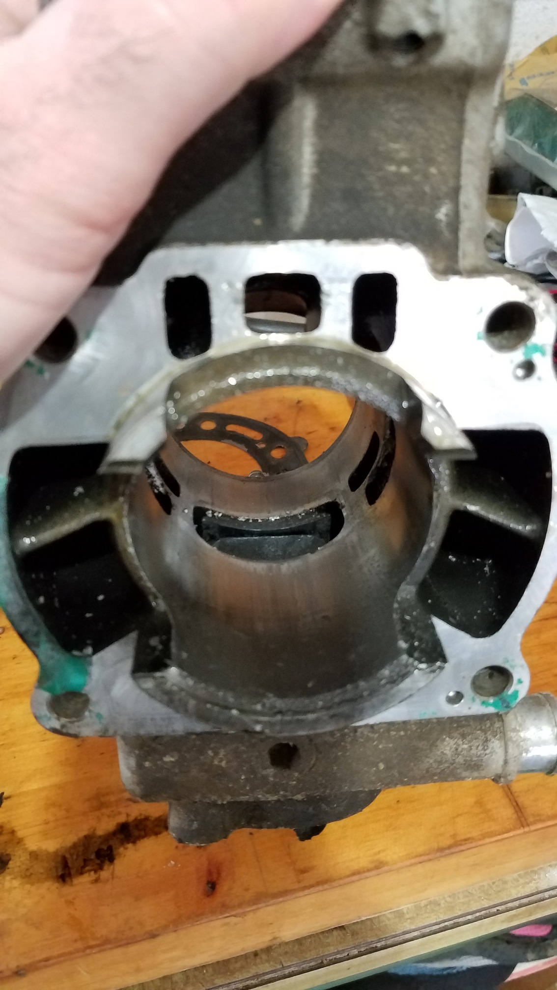

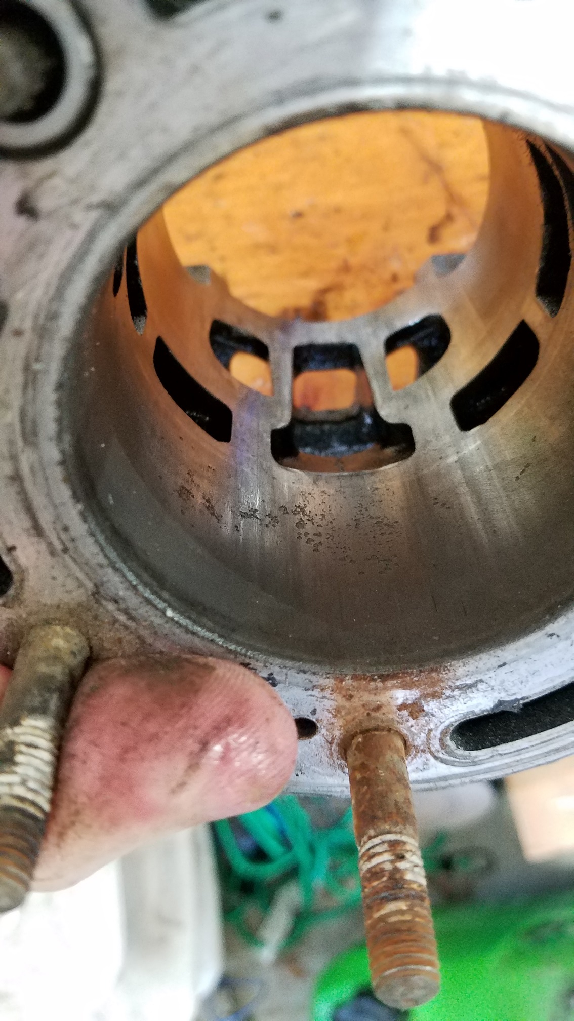

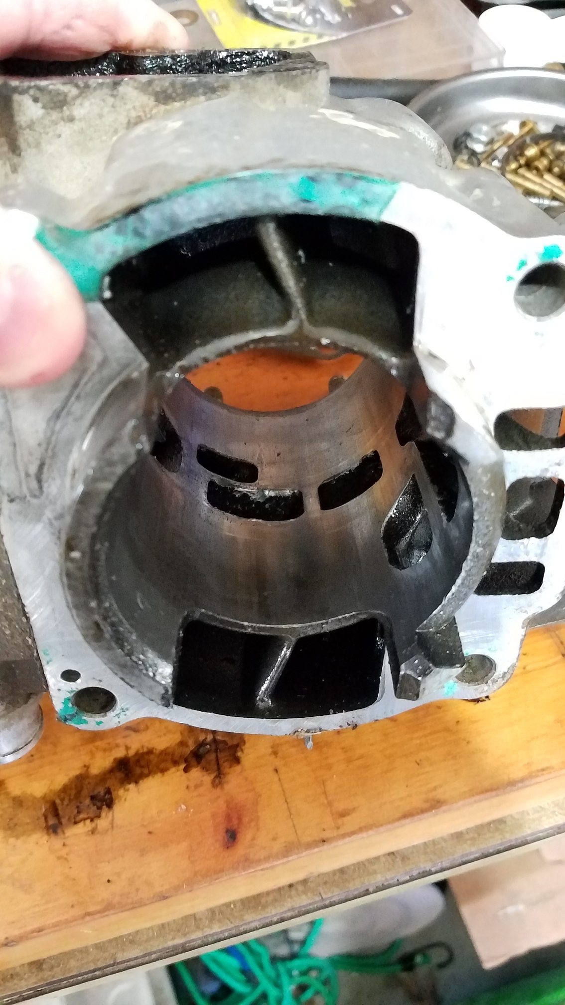

3. I assume I should have the cylinder at least replated but I have included pictures for opinions. Maybe there is some thing that makes it toast and I would like to know that before I send it out to be done.
4. The head has some dings in it. Is this usable or should I just replace it? I would normally just replace it anyway but, it was modded by RB and I don't think that service is available any longer.
Any advise would be greatly appreciated.

More of the cylinder

What caused that?
- Posts: 6054
Re: So the rebuild begins
That to me looks like a cast piston run past it's service limit (fatigue) or a seriously defective one. How old is that piston?
Ok, to answer your questions...
1. Refer to #2.
2. That engine needs to be torn down and a complete rebuild done. There is absolutely no way you can guarantee you've gotten all the pieces of the piston out. The pieces already have, or will if you don't get every bit out, damage the main bearings and possibly your new piston and cylinder. Time to split the cases IMO. Get a new connecting and have the crank rebuilt as I'm sure it's long overdue for it. I would recommend Crank Works since Cooksey isn't doing cranks any more. (http://crankworks.com/)
3. That cylinder I'm sure is salvageable with a replate. Contact Millenium (https://www.millennium-tech.net/) to get it done right. They can even supply the piston so the bore and piston will match.
4. I've seen worse looking heads reused. You could send the head in to Millenium as well and they might be able to machine it again. If not, you could always sand it by hand to remove any sharp spots (don't sand the gasket surface!) that could lead to detonation and just bolt it on. Lastly, you could get another head and send it along with your cylinder and have Millenium machine it, setting the squish, while they have your cylinder and piston.
Please, go with a forged piston. They don't come apart like a cast piston and can take longer service intervals without self destructing. Yes, they'll lose compression and power like a cast piston but won't grenade if you get lazy and put 200 hours on it.
1. Refer to #2.
