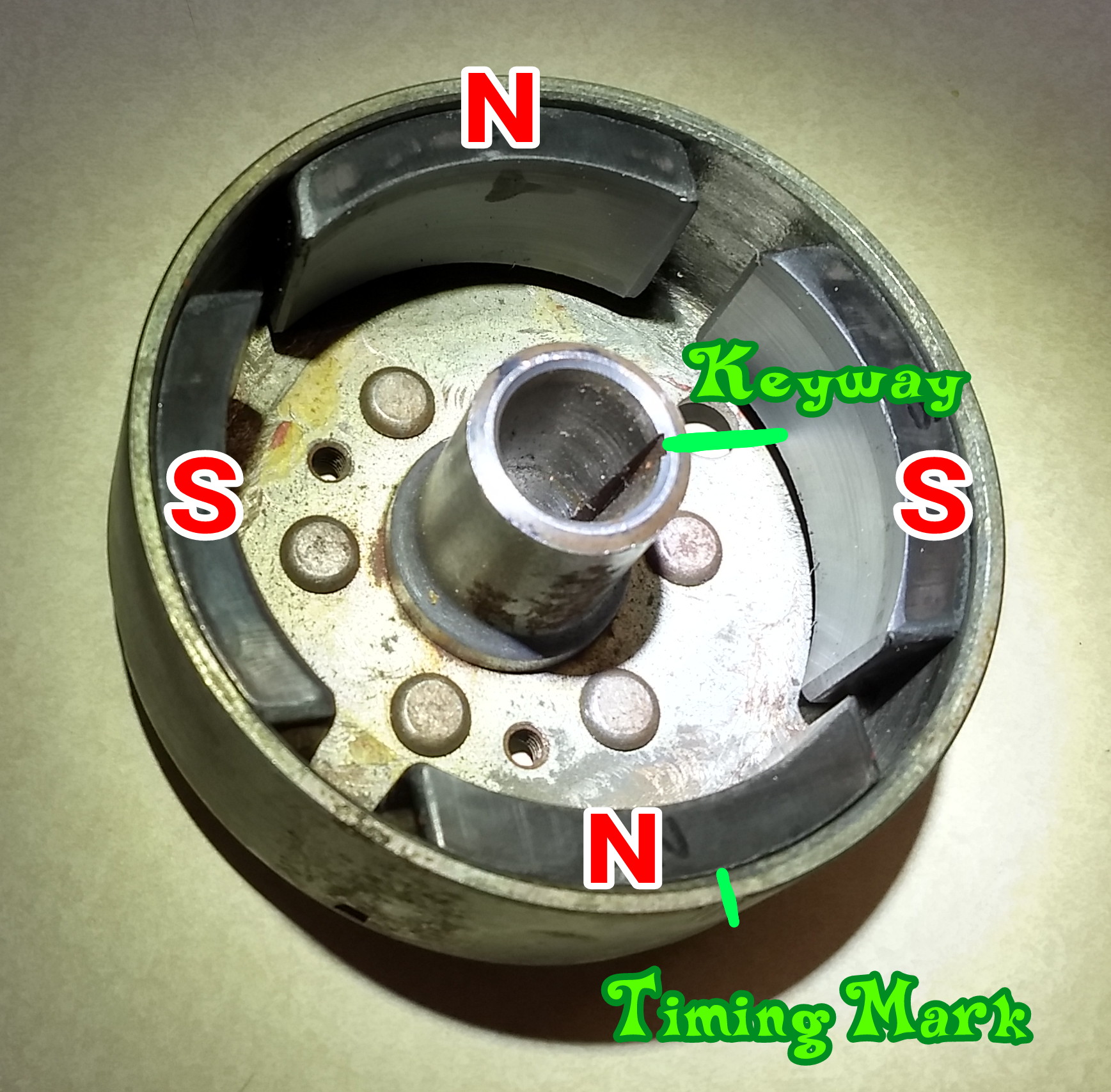

Here is original 1986 KDX200 flywheel orientation if it helps any.
