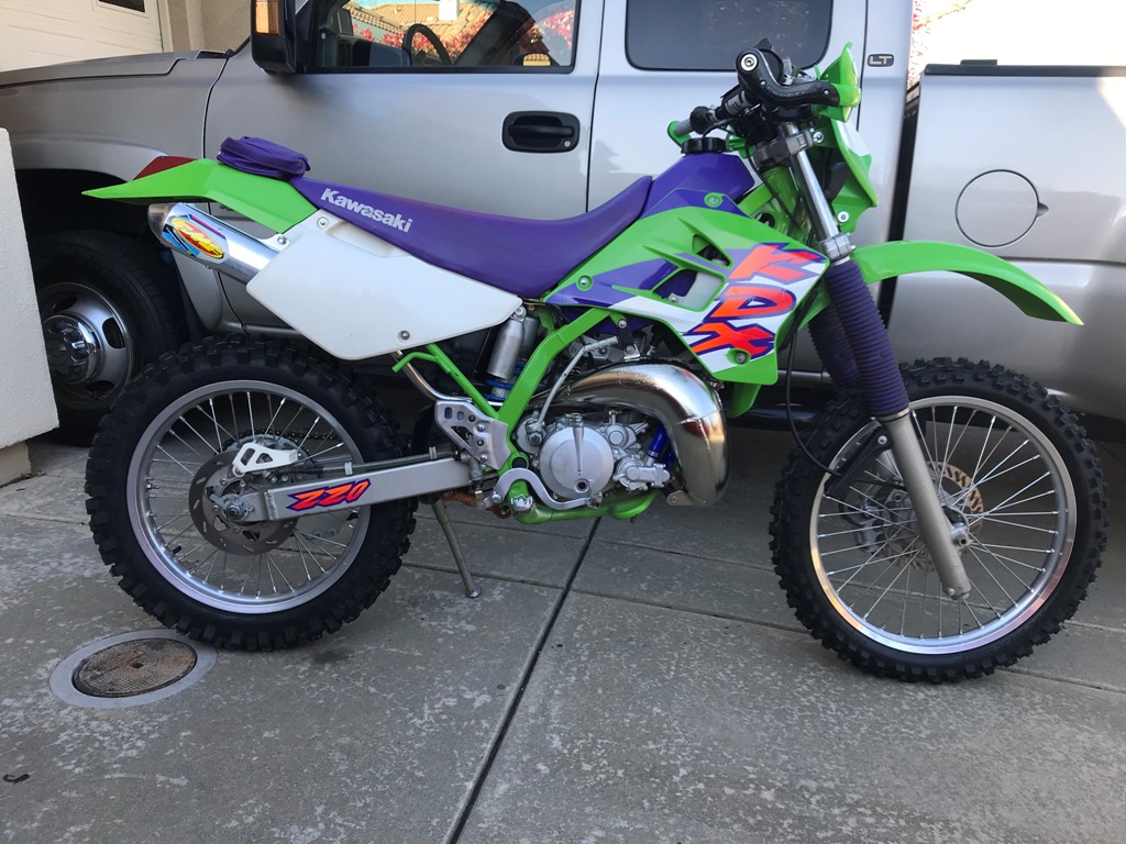

The 220 is done, runs good other than about 1/4 throttle,
Idles fine and just off idle. 4 strokes at about 1/4, 1/3 throttle on runs great.
Only mods are Boyesen reeds, FMF desert pipe and snorkel removes.
Stock jetting,
Main-145
Pilot-42
Needle- R1173l
Air screw- 1.5 out
Any suggestions
I tried raising and lowering the needle 1-up and 1-down no difference
I do have a 35mm from a 200 to try.

Kdxfan4130
Posts: 116
Joined: 09:24 pm May 30 2019
Country: Usa
Re: KDX220, new to me
Post by Kdxfan4130 »
Plug looking rich you might try one smaller pilot jet. Especially if your needle clip is in the upper 2 clip settings. You didn’t say where the clip is currently, not sure what four stroking is. I’ve found blubbery sluggish is rich, to lean it runs too good zingy quick revving puts a hole in the top of the piston.
Nice kdx holy moly!

rtbmrgl
Posts: 74
Joined: 01:45 pm Dec 25 2019
Location: roseville
Post by rtbmrgl »
The was in the middle position, I raised and lowered it one clip, didn’t seem to make a difference. 4-stroking, running rich. I’ll try smaller pilot jet.
Keep a thicker needle in mind.

KDXGarage wrote: 12:29 am Mar 13 2020 Keep a thicker needle in mind.
It looks great!
Thanks, I tried a 1174 needle, and didn't seem to make a difference either.
My jetting will be put on the back burner, my March trip was canceled.
Before you start changing jets, make sure the air screw is set correctly for what you have. Just a suggestion.

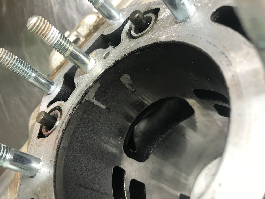

Well I removed the cylinder, and found the plating is coming off between the exhaust port and the top of the cylinder. So I guess sending it to be re-plated is the answer. Where is a good place for re=plating.
Millenium or PowerSeal
For example:
viewtopic.php?f=77&t=24041#p206710
Post by javjacob »
Millennium is the best.

Post by rtbmrgl »
Thanks, I called Millenium,

Twinsig wrote: 03:43 pm Mar 15 2020 If you want to save a few bucks on a new piston send me a PM.
Thanks, I actually bought a Wiseco, I sent it off to Millennium with the cylinder.
