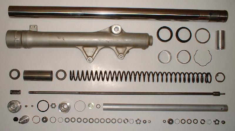

Here's a picture I took years ago of some 1996 KDX200 forks.
Look at the row of parts next to the bottom row. Count to the sixth part. It is two to the right of a big black o-ring. One has to put a hex into that piece. It has to be on the end of a hollow rod, as the metal rod above the pictured part is in the way. The tool has to go over the rod and down into the hex area.
Otherwise, I think the Motion Pro shown would be a great tool. It has adapters to make it fit five sizes, so if you ever switch to KX forks or get a different bike, it could be used on those.

Wow great tip about wrapping the threads at the top of the rod with a wire and pass the wire up through the spring. That's a really good idea and I'll bet that would work. Or a string even. I might try your wire method and then break down and buy the Motion Pro tool off of Amazon if it isn't easy enough.KDXGarage wrote: 06:45 pm Mar 06 2020 A cheap option you might try is to get a metal wire and wrap it around the threads at the top of the rod. Just bend it so it goes up through the spring.
Dude awesome picture holy s--t. I can clearly see what you're talking about now, although you did a pretty good job of explaining it earlier. I can probably find the answer to this question online somewhere, but off the top of your head do you know the actual measurement in mm of the hexagonal opening in that bottom part?

It will not work on 1991 - 1994 KDX250 or 1993 - 1994 KDX200.
If I could only buy one of those two tools, I would buy the FRP Offroad tool, assuming shipping is not sky high.
I could use some tape and wire to pull the rod up and a wooden dowel to push it down. It does have to be cycled a few times to bleed the cartridge.
Again, the "proper" tools make it quick and easy, but it is tough to swallow just using them for a job that is not done often. On the plus side, once you have the "proper tools", it makes it easier to go ahead and change the fork oil on a regular schedule vs. just neglect it.
