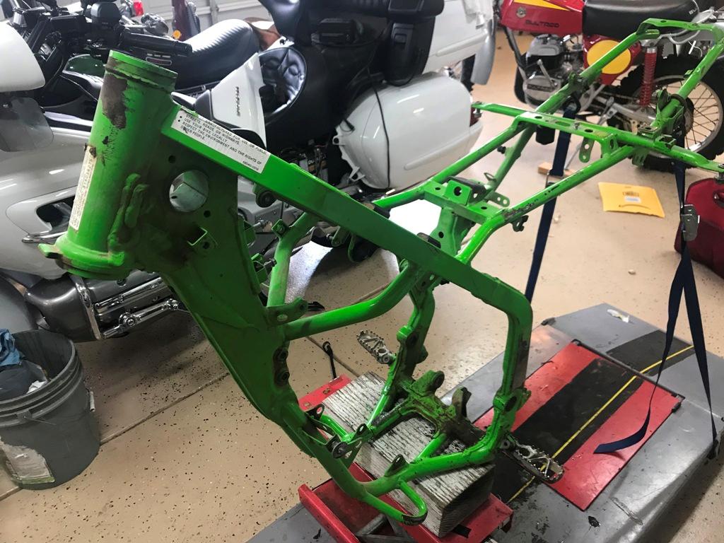

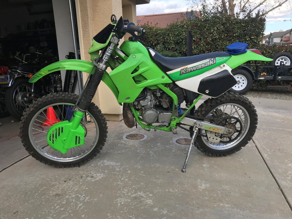

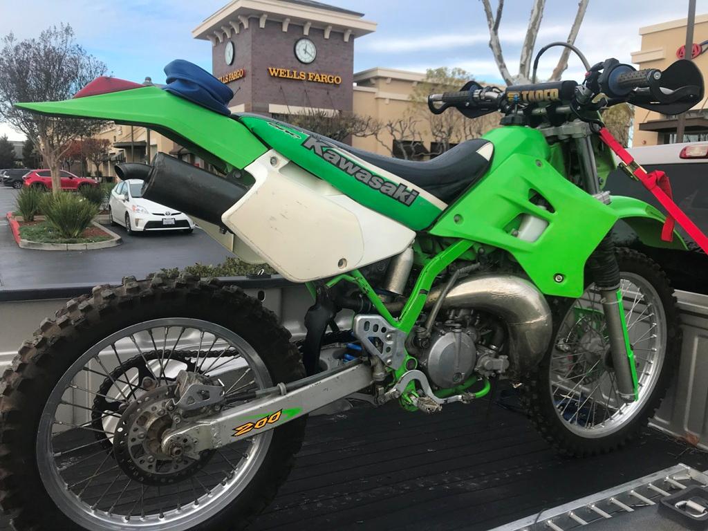

I picked up a '01 KXD200 Jan-1, some good, some some not to bad.
Has new top end, dessert FMF pipe, new tires and a few accessories.
I think the PO power washed bike a lot, every bearing is bad.
Engine is coming out to paint frame and clean thing up.
So far repair list includes...
Water pump re-seal.
Front and rear wheel bearings.
Swing arm and shock linkage bearings.
Steering head bearings.
Chain and sprockets.
Carb rebuild.
Any suggestion are welcome.
I've already noticed quite a bunch of knowledgeable folks here.
Here's a few pics, will post more.

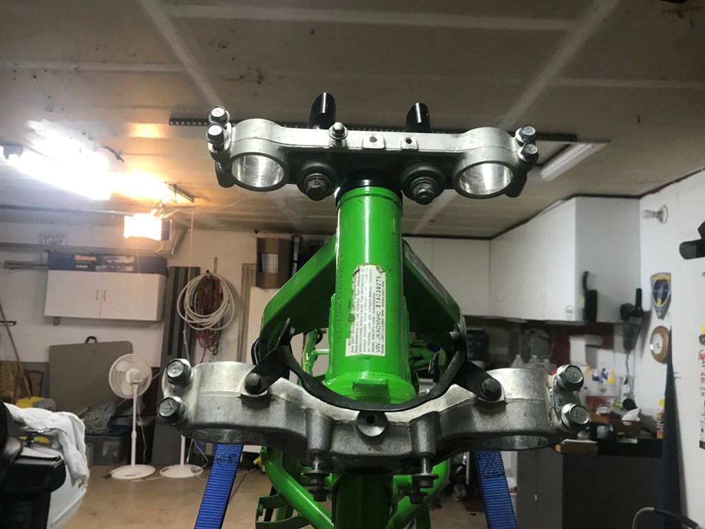

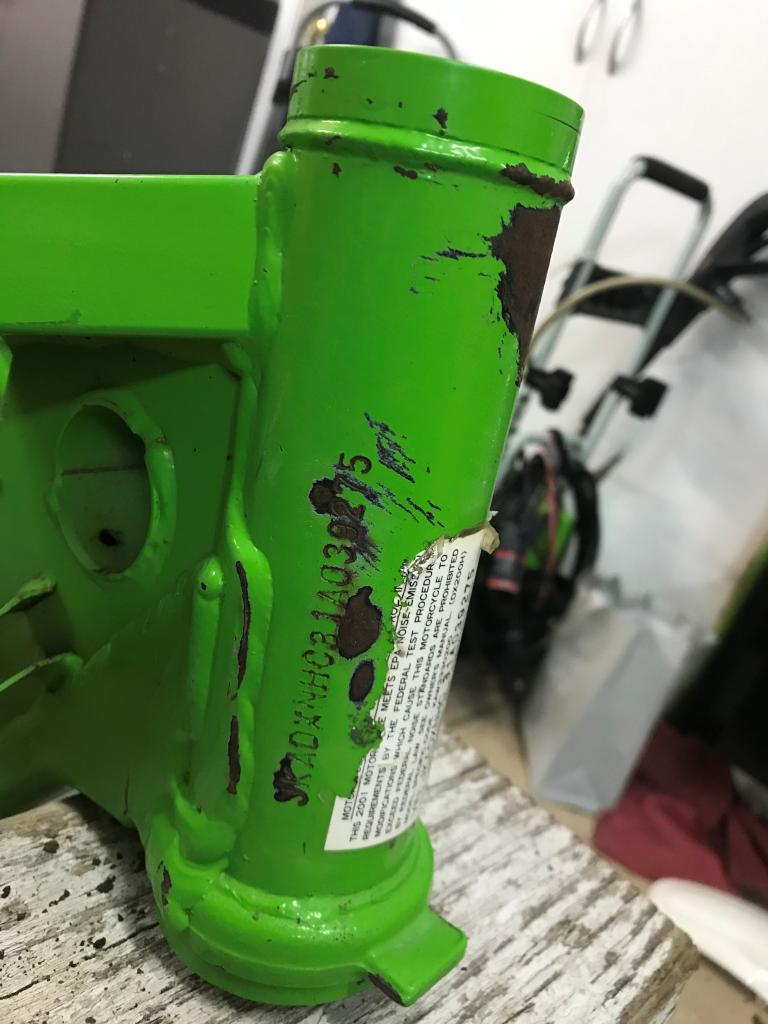

Re: '01 KDX200 resto, NoCal

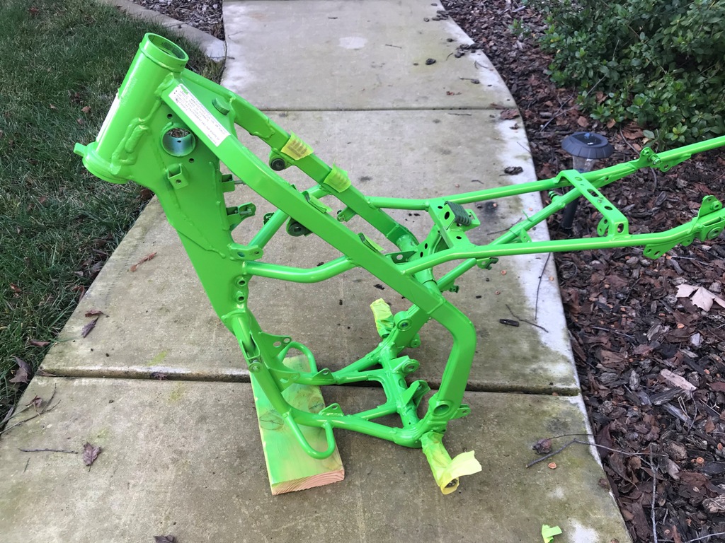

pic 1: This will go well. Even his power washer is lime green.
pic 2: WHAT THE HELL (welding bead ring on the head tube)
What is going on there?
- Posts: 74
- Joined: 01:45 pm Dec 25 2019
- Location: roseville
Head tube looks factory to me.KDXGarage wrote: 11:41 pm Jan 10 2020 pic 1: This will go well. Even his power washer is lime green.
And a, hell-o to you too.
OK, scratched off paint must have been throwing me off.
That looks normal now on the close up.

That’s good, thanksKDXGarage wrote: 02:49 am Jan 11 2020 OK, scratched off paint must have been throwing me off.

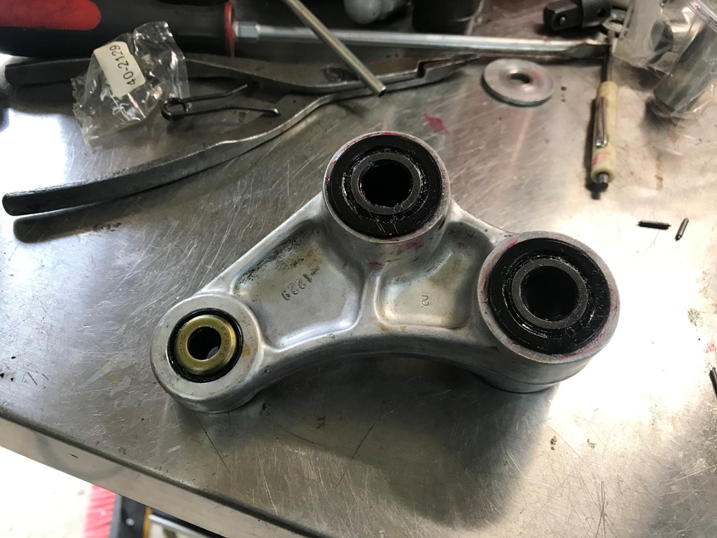

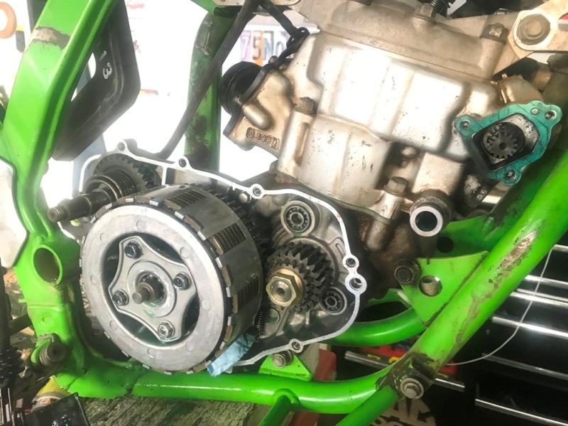

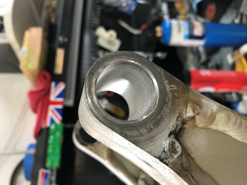

Got back from visiting grand kids, now I can get back to working on the bike.
I appreciate all the effort keeping this site going, Its helped me a lot. Doing a search always comes up with good info.

HEHE, I guess going green these days has more then one meaning.
I found all of the shock linkage and swingarm bearings very rusty, like dust. Zerk fittings would be cool.
Also found coolant in the trans oil. If I looked over the bike more closely I may have not bought it.
I guess I got excited finding a KDX close, year and price I was looking for. One great thing about the KDX is a lot of support and available parts.
When i pulled the side cove off to replace the water pump seals, there was no sign of rust, so I'm guessing water leak had just started.
Oh well.
Getting the KIPS back in sync was easy too.
So far everything is going smooth, definitely enjoying working on the bike, wife likes it too, keeps me busy and out of her hair.
If you see anything I'm doing looks stupid, let me know, it wouldn't be the first time.
Oh well.
