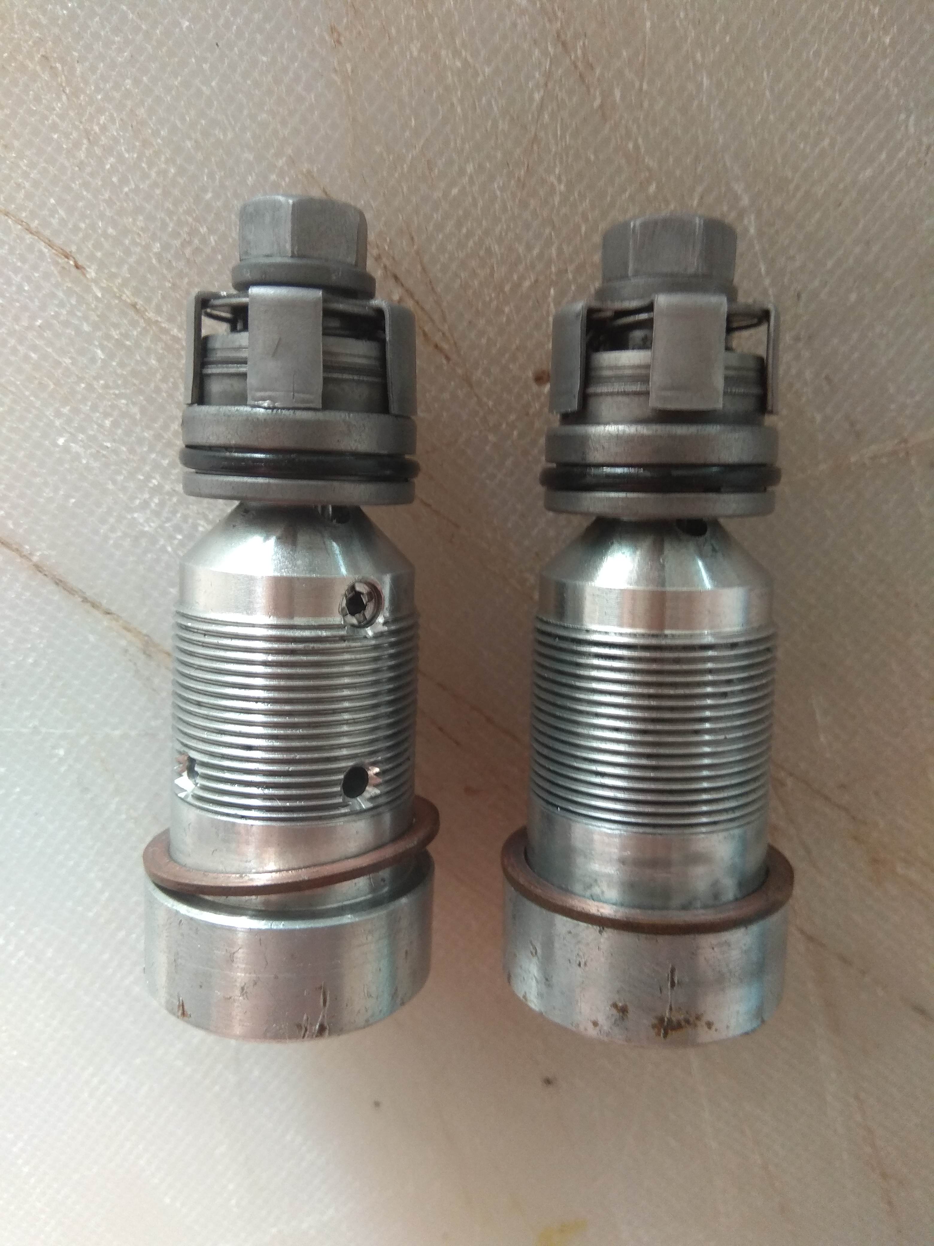

there is practically no suspension settings available from light weight riders( presumably because there are hardly any lightweight riders), mostly suspension advice given from heavier riders so thought i would be that light weight guy to give you my first hand experience. i weigh 60kgs and my kdx220 has wanted to jar the fillings out of my teeth since the day i bought it. recently did a complete suspension overhaul and these are my settings

5 compression shims removed and pay particular attention to the shim basket position as put on incorrectly this is like adding 10 shims (as per photo)
